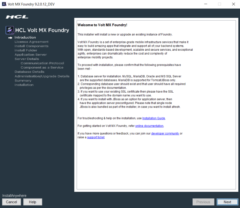

  3. The Welcome to Volt MX Foundry windows appears.
    Read the instructions carefully before installing Volt MX Foundry Console.
  4. Read the instructions carefully, and click Next.

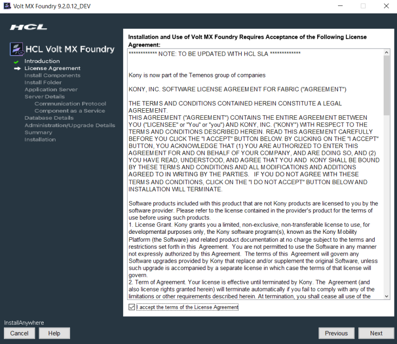

    The LICENSE AGREEMENT window appears.
  5. Scroll until end of the screen, and then select the "I accept the terms of the License Agreement" option.

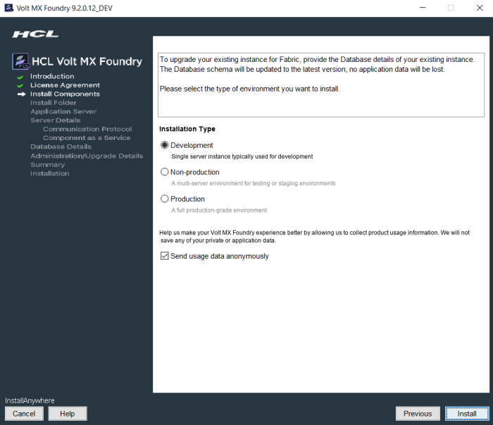

    6. Click Next. The Install Components window appears with the following supported installation types:
    • Development for single machine instance.
    • Non-Production for larger environments like Staging or Testing.
    • Production for a full production-grade instance.
    Installation environment is set to Development by default . Choose one of the install type based on your requirement.
  6. Select the Send usage data anonymously check box. This allows HCL to collect product usage information to make your Volt MX Foundry experience better. HCL does not save any of your private or application data. By default this check box is selected.

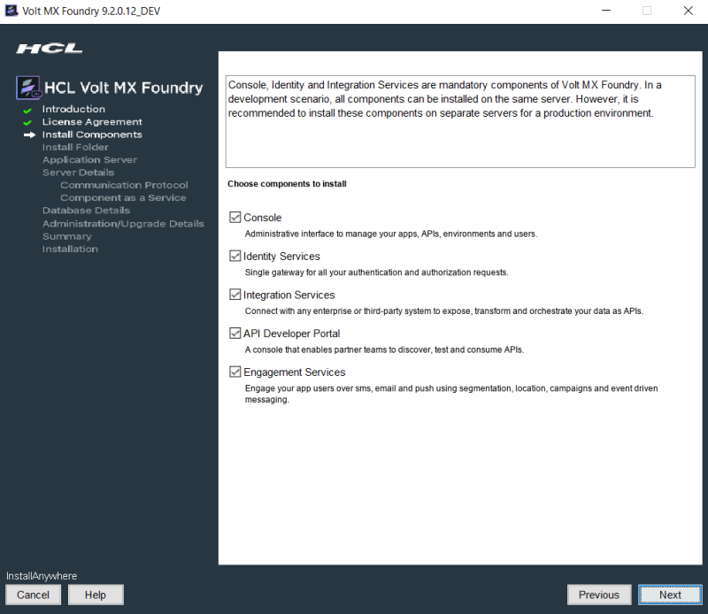

  7. Click Next. The Choose components to install window appears.
  8. Select one or more check boxes for the supported components. By default, the Console, Identity Services, Integration Services, Developer Portal, and Engagement Services check boxes are selected:
    • Console - To install Volt MX Foundry Console, select the Console check box.
      The system creates the following databases: <prefix>mfconsoledb<suffix>, <prefix>mfaccountsdb<suffix>, and  <prefix>mfreportsdb<suffix>.
    • Identity Services - To install Volt MX Identity Services, select the Identity Services check box.
      The system creates the following database: <prefix>idconfigdb<suffix>.
    • Integration Services - To install Volt MX Foundry Integration Services, select the Integration Services check box.
      The system creates the following databases: voltmxadmindb  and  mfreportsdb.
    • API Developer Portal - To install developer portal, select the API Developer Portal check box.
      Note: During installation if you have selected API Developer Portal, the API Developer Portal is created. You can directly access your Volt MX Developer Portal in Volt MX Foundry Console.
    • Engagement Services - To install Volt MX Foundry Engagement Services, select the Engagement Services check box.
      The system creates the following database: <prefix>kpnsdb<suffix>.

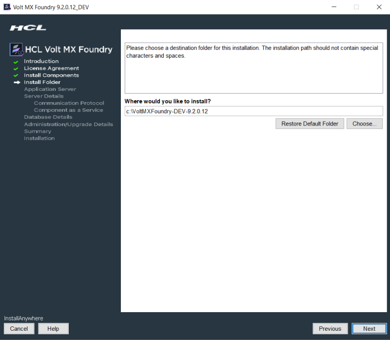

  9. Click Next. The Install Folder window appears. The selected path appears in the Where would you like to install field.
  10. Click Choose to browse the required folder from your system.

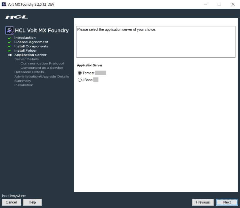

  11. Click Next. The Application Server window appears asking you to choose the application server. By default, the Application Sever is set to Tomcat.
  12. In the Application Server window, click Tomcat.

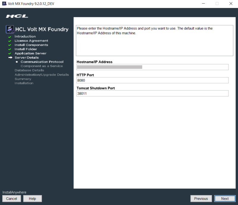

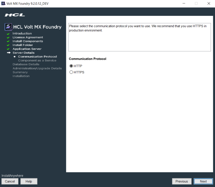

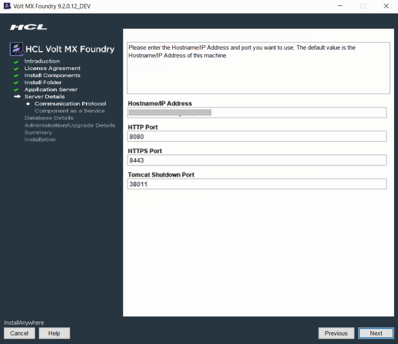

    The HTTP or HTTPS window appears asking you to choose the HTTP or HTTPS. By default, this option is set to HTTP.
    a) Between HTTP and HTTPS, if you select HTTP, the following window appears. Enter the Hostname/IP Address, HTTP Port, and Tomcat Shutdown Port. Click Next.
    b) Between HTTP and HTTPS, if you select HTTPS, the following window appears. Enter the Hostname/IP Address HTTP Port HTTPS Port and Tomcat Shutdown Port Click Next.

    If any input goes wrong among the inputs provided in the previous steps: HTTP or HTTPS  >  a  or  HTTP or HTTPS  >  b, one of the following error messages will appear:
    • If you provide an invalid hostname/IP address, the following alert is displayed:
    • If a port is in use, the following alert is displayed:
    • If you provide an invalid Port, the following alert is displayed:
    • If you provide the same port numbers for HTTP and HTTPS, the following alert is displayed:

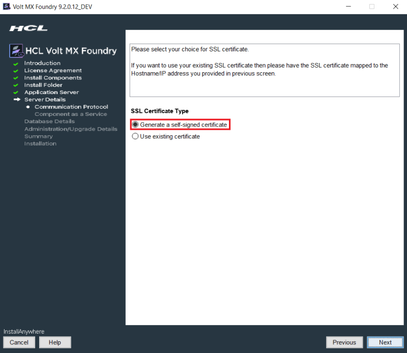

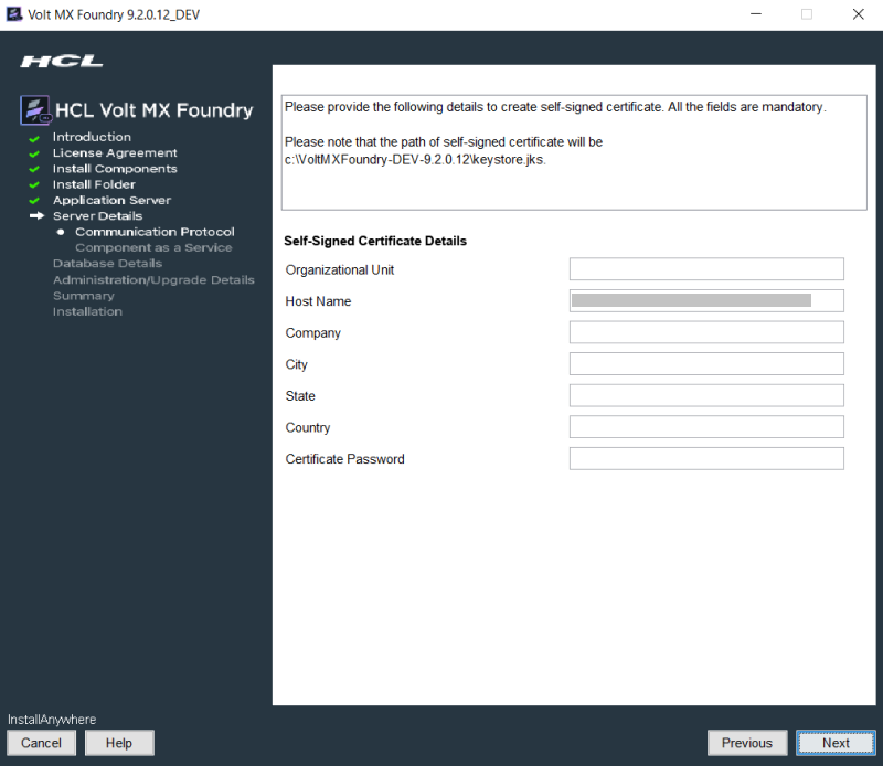

    1. To generate a self-signed certificate, click Generate a self-signed certificate, and click Next. The Details for self-signed SSL Certificate window appears.
      Important:  To add an existing SSL certificate to a cacerts file, refer to How to Add Your Existing SSL Certificate.
      Note: The path for a self-signed certificate is in this location: <install folder>\keystore.jks
      1. Enter details for the following fields:
        • Organization Unit: Enter your business unit name.
        • Host Name: Enter your domain name - for example, hcl.net
        • Company: Enter your company name.
        • City: Enter your city name.
        • State: Enter your state name.
        • Country: Enter your country name.
        • Certificate Password: Enter the password for the .jks file that the installer will generate.
        • If you enter invalid details, the following error message is displayed:

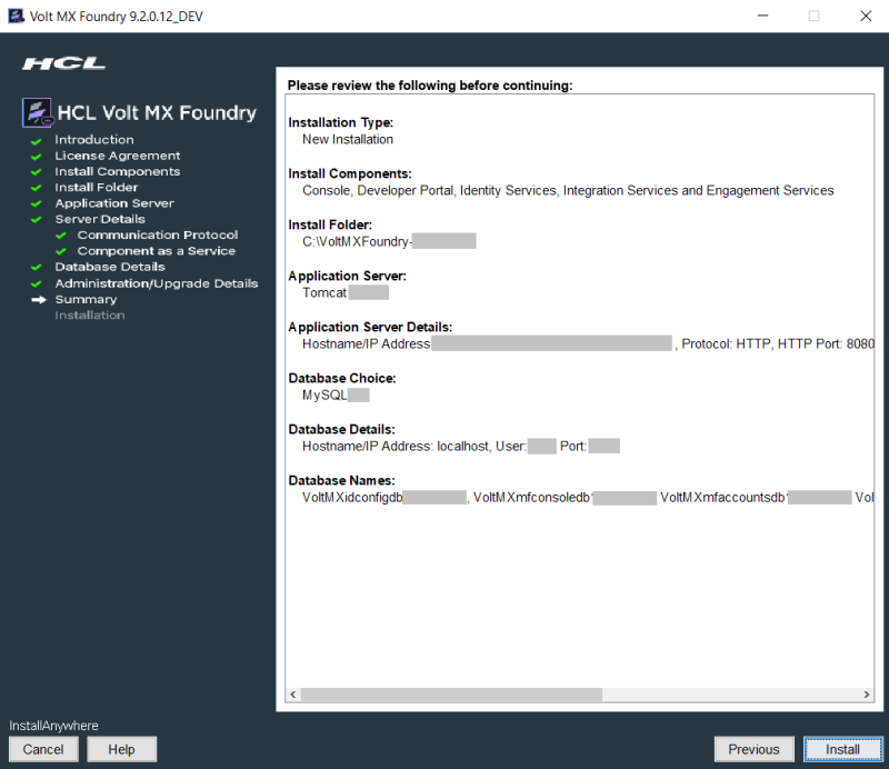

  • Enter the databases details, and click Next. The Pre-Installation Summary window appears.

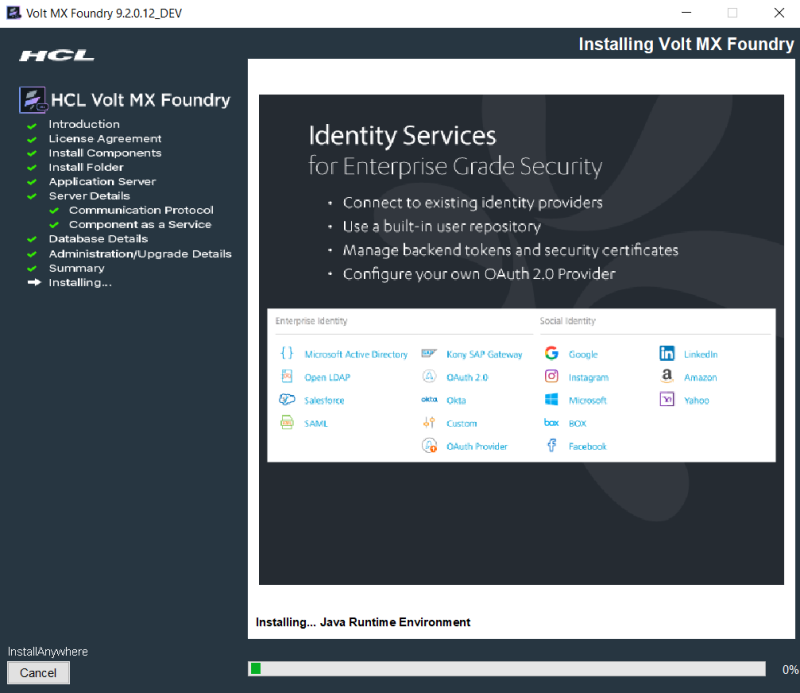

  • Click Install. The Installing Volt MX Foundry window appears.
    Note:  Sometimes, even after showing 100% installation progress, Volt MX Foundry Installer takes around 20 more minutes to complete installation on Windows.

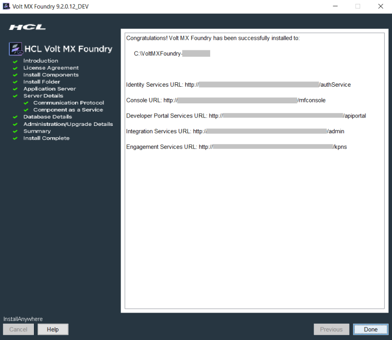

    Once the installation is completed, the Install Complete window appears with a confirmation message.
  • Copy the URLs and save them in a notepad. Click Done to close the window.
    Important: After installing Volt MX Foundry, import your SSL (for example, domain.subdomain.crt) into your Volt MX Foundry Installer's JRE trusted certificate authority (CA) certificates file - for example, C:\VoltMX Foundry\jre\lib\security\cacerts
    If your SSL certificate is not configured, the system displays an error message - for example, "peer not authenticated."
    For details, refer to Troubleshoot with SSL Certificate Issues.
