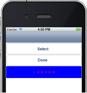

pageSkin Property
Specifies the skin for page indicator.
Syntax
pageSkin
Type
String
Read/Write
Read + Write
Remarks
The default value for this property is Skin Defaults ( blue color strip is applied for the page indicator).
This property is applicable only when viewType is set as TABPANE_VIEW_TYPE_PAGEVIEW and images are selected for pageOnDotImage and pageOffDotImage.
Example
//Sample code to set pageSkin property of a TabPane widget.
frmTab.myTab.pageSkin="pSkin";
Platform Availability
  • Available in the IDE
  • iPhone
  • iPad

TABPANE_VIEW_TYPE_PAGEVIEW:
The viewConfig property accepts a JSObject with the below key-value pairs.
  • needPageIndicator - Boolean value indicates whether the page indicator required or not.
  • pageOnDotImage - Name of the image. String identifier for a local resource or an image Object (voltmx.image). Valid only if needPageIndicator is true. You can create an image Object by using voltmx.image Namespace functions.
           On iOS 14 (and later) devices, the page control displays an opaque version of the image provided for the pageOnDotImage, without the colors. Support to apply colors to page dots has been provided by the iOS native platform and can be implemented in Volt MX Iris by using the pageOnTintColor property in the preShow event.
           The default color for the pageOnTintColor is an opaque white dot.
    Note: Support for the pageOnTintColor property is available from the following releases:
    . Volt MX Iris V9 Service Pack 2 Fixpack 54.
           When the TabPane is rendered, the size of the dots is decided by the size of the image provided for the pageOnDotImage property. The width and height of the page dot is the same as the resolution of the image passed as the input. If you do not provide an image, the default dot is displayed. To display a dot with a custom size, the image for the dot must be set in the widget properties.
  • pageOffDotImage - Name of the image. String identifier for a local resource or an image Object (voltmx.image). Valid only if needPageIndicator is true. You can create an image Object by using voltmx.image Namespace functions.
           On iOS 14 (and later) devices, the page control displays an opaque version of the image provided for the pageOffDotImage, without the colors. Support to apply colors to page dots has been provided by the iOS native platform and can be implemented in Volt MX Iris by using the pageOffTintColor property in the preShow event.
    The default color for the pageOffTintColor is a translucent white (or gray) dot.
    Note: Support for the pageOffTintColor property is available from the following releases:
           When the TabPane is rendered, the size of the dots is decided by the size of the image provided for the pageOffDotImage property. The width and height of the page dot is the same as the resolution of the image passed as the input. If you do not provide an image, the default dot is displayed. To display a dot with a custom size, the image for the dot must be set in the widget properties.
