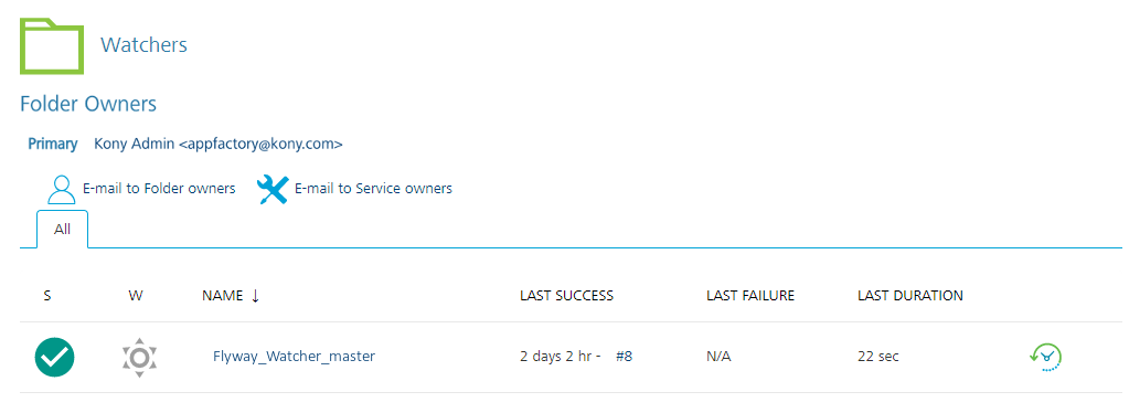

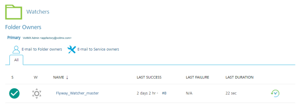

Configuring a Watcher Job in App Factory

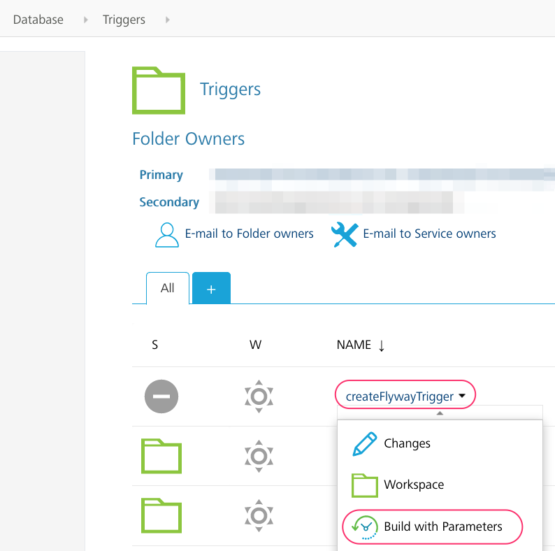

  1. From the Database folder of your project, navigate to Triggers.
  2. In the Triggers folder, click the build icon for the createFlywayTrigger job.
    Alternatively, open the drop-down menu for the createFlywayTrigger job, and then select Build with Parameters.
  3. For the CRON_SCHEDULE parameter, make sure that the field is blank.
  4. Configure the remaining parameters for the job, which are the same as the Flyway job.
  5. After you configure the parameters, click BUILD.
Jobs that are triggered when changes are pushed to a branch are stored in the watchers folder. You can tell what branch it watches by the branch specifier expression that is appended to the job name.
