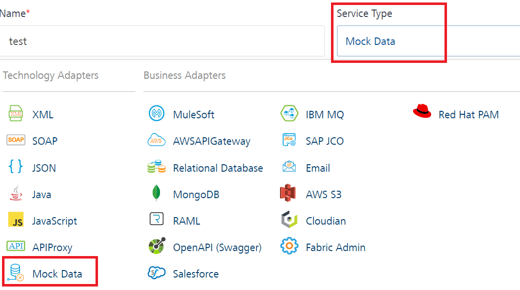

- In the Name field, provide a unique name for your service.
From the Service Type list, select Mock Data.

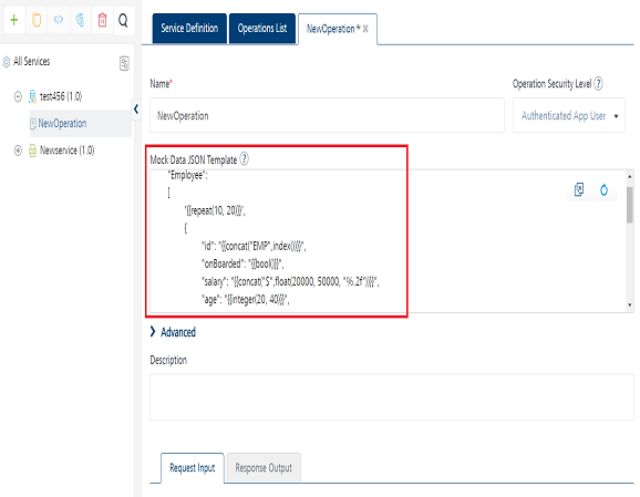

Configure your Mock data template in the Mock Data JSON Template text field. By default this field is enabled with a sample mock response template.
Note: For more information on Pre-built functions supported in Mock Data template, refer Mock Data Template and Supported Pre-built functions in Mock Data

##Escape braces
| Description | If you want to escape braces from within a function use a single escape character as seen in the example below: |
| Syntax | "{ {concat("\{", "test", "\}")} } |
##Nesting functions
| Description | Mock Data service supports nesting functions as well. For example, if you wanted to create results that looked like dollar amounts, you can do the following: |
| Syntax | "{ {concat("$",float(0.90310, 5.3421, "%.2f"))} } or something like this if you wanted a capitalized F or M: { {toUpperCase(substring(gender(),0,1))} } |
