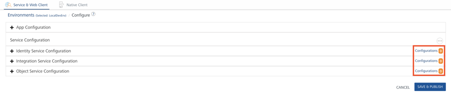

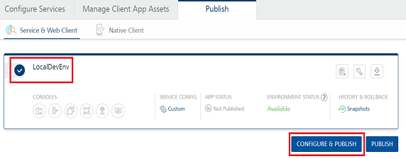

To reconfigure a service from the Publish tab, do the following:
  1. From the Services and Web Client tab, select the required environment.
  2. Click Configure and Publish. The Configuration page is displayed.

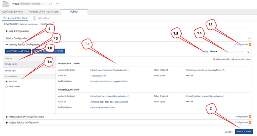

The service details page displays the following fields:
Number Section Description
1 Identity Service Configuration Displays the Identity Services configuration details for app reconfiguration.
1. a Work area Displays the configurable properties of all the services such as Client ID, Client Secret and Domain Name. You can edit the values of the properties and click Save. An undo icon appears next to the value field until you publish the app. You can reset the new value to default value by selecting one of the options in the Reset to Default Values drop-down list. > Note:  Based on a combination of selected conditions in the View By and Show Content sections, the system displays services, entities for all services, and edited values.You can select the following combinations in the View By and Show Content section:    -  Service Name and All Values   -  Service Name and Edited Values   -  Service Type and All Values   -  Service Type and Edited Values
1. b View By Displays services based on conditions such as service name or service type. Service Name: Displays services and their entities. Service Type: Displays the headers of service types. To view content in a service type, click the Plus (+) icon.
1. c Show Content Displays content in services based on conditions such as all values or edited values. All Values: Displays services and their entities. Edited Values: Displays services and their edited entities.
1. d Sort By Sorts the services in the work area in A to Z  or  Z or A order.
1. e Search by Service Name Filters the services based on service name.
1. f Configurations Compares the reconfigured services.
1. g Reset to Default Values Reset to Default Value Reset to Current Env. Config Resets the values of reconfigured services.
2 SAVE & PUBLISH Saves and publishes the reconfigured app to an environment.

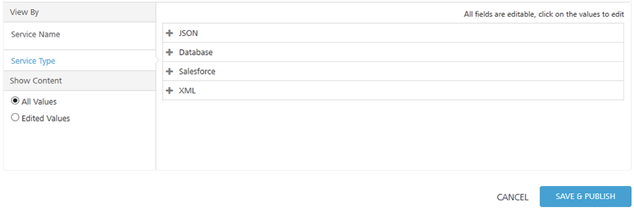

    • Service Type: Click Service Type if you want to group the services based on the service type. To view details in each service type, click the Plus icon and expand the service.

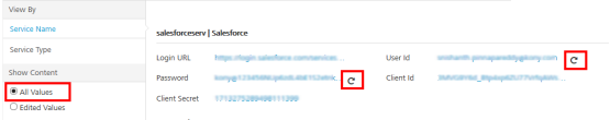

  • In Show Content, you can select the required option to change the view of the content within the service based on their values. The options available are as follows:

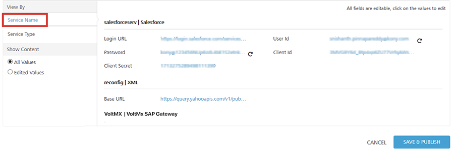

    • All Values: Click All Values if you want to view all values including reconfigured values for the selected filter in the View By section.
      For example, if you change User ID and Password for Salesforce service, shown below.

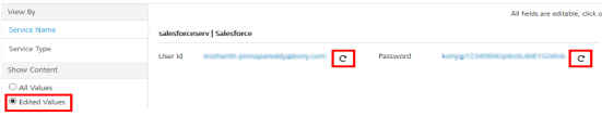

    • Edited Values: Click Edited Values if you want to view only the reconfigured values for the selected filter in the View By section.
  • In the work area, follow these steps to reconfigure values in the services:
    1. To change any value, click the value. For example, to change the base URL, click it.
      The system displays the value in the text box, and the save and cancel buttons next to the text box.
    2. Edit the value in the text box . For example, change  com   to  net.
      Important:  When you reconfigure a value, click the save button to save the changes. If you click anywhere else on the page, the changes will be lost, and you will get only the previous data.
    3. Click save. The system adds an undo button next to each reconfigured values.

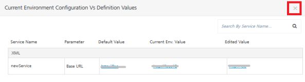

Compare Reconfigured Services
In the service details page, after you reconfigure values of services, you can compare the details of all services. You cannot edit any fields in the compare dialog.
  1. In the App configuration page, click Configurations on the required service configuration row.
    The system displays the Current Environment Configuration Vs Definition Values dialog box.
  2. Service Name: Displays the service name.
  3. Parameter: Displays the field name that is reconfigurable.
  4. Default Value: Displays the value configured in the design time.
  5. Current Env. Value:Displays reconfigured value in the current environment.
  6. Edited Value: Displays the edited value for the selected environment.
    Important:  In the Current Environment Configuration Vs Definition Values dialog box, the values in the Current Env. Value  and  Edited Value fields are updated to an environment only when you click SAVE & PUBLISH.
  7. Click the Close button at the top-right corner to exit the dialog.
