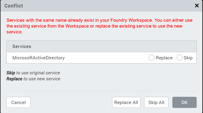

If the sample service that you are trying to create already exists, a Conflict window appears. You must perform any one of the following actions:
- Select the Skip radio button, and then click Ok to use the original service.
- If multiple instances of the same service exist and you want to use the original service, click Skip All.
- Select the Replace radio button, and then click Ok to use a new service.
- If multiple instances of the same service exist and you want to use a new service, click Replace All.

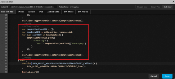

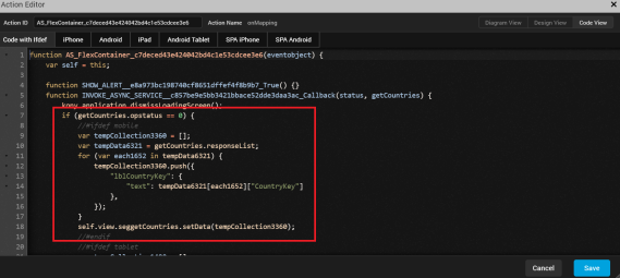

The type of code generated depends on:
- The type of service that is being created (GET, POST, DELETE, UPDATE)
- The type of widget it is being mapped to
- Once a data widget is linked to the Post Operation, the data is sent based on test parameters and not based on the label's text value.

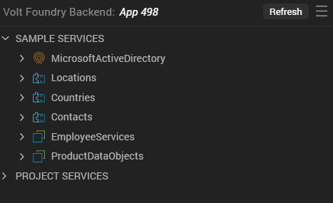

- In Volt MX Iris, create a new project or open an existing one.
- Create a form; for example, frmSample.

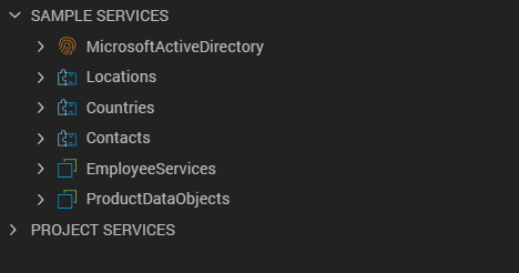

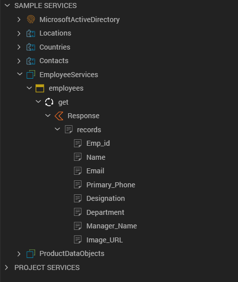

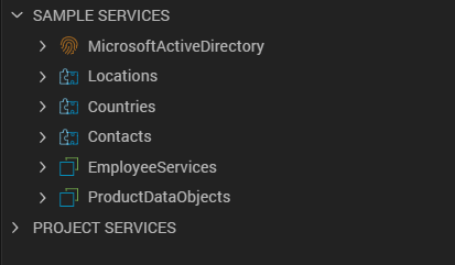

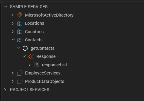

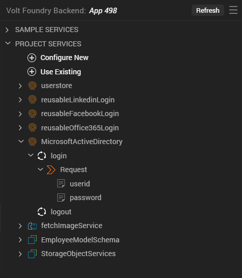

From the Data & Services panel, click Sample Services. The list of pre-configured services appears.
4. Expand MicrosoftActiveDirectory; the login and logout services appear.
5. Drag and drop the login service on to the form.
6. Post this action, widgets are added to the form and the Identity service is associated with the form. The service also appears under Project Services in an auto-highlighted state. Here, the MicrosoftActiveDirectory service is auto-highlighted.
You can expand the login service to view its Request parameters. The mapped parameters of any service appear in a bold and italics style to differentiate from unmapped parameters. Here, userid and password are displayed in a bolded and italicized manner.
You can also click View Mapping to view the mapping details of the login service in the Action Editor. The specific operation of the service is auto-highlighted in the Action Editor. Click Generate Code to view all the mappings of the login operation.

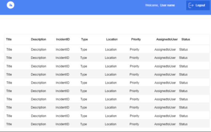

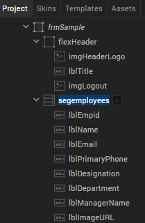

Dragging and dropping operations onto the form leads to the auto-generation of UI elements.

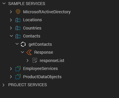

From the Data & Services panel, select Sample Services. The list of pre-configured services appears.

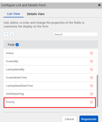

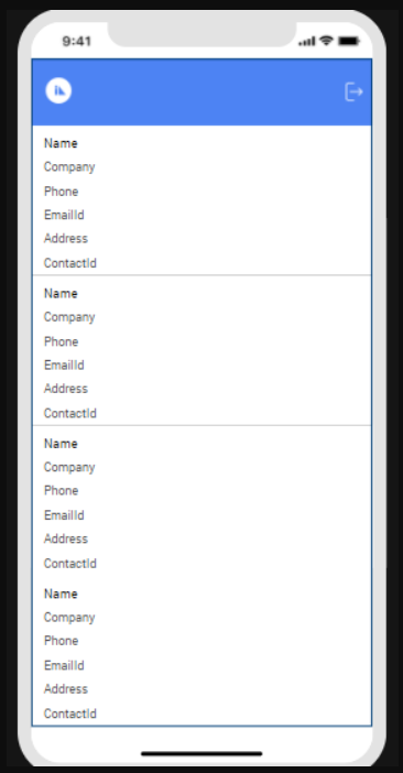

4. Expand any Integration service. Here, Locations, Countries, and Contacts are the sample Integration services. 5. Expand any service to view its available Request or Response parameter. The respective responseList or requestList is auto-displayed. Here, Contacts > getContacts > Response > responseList.

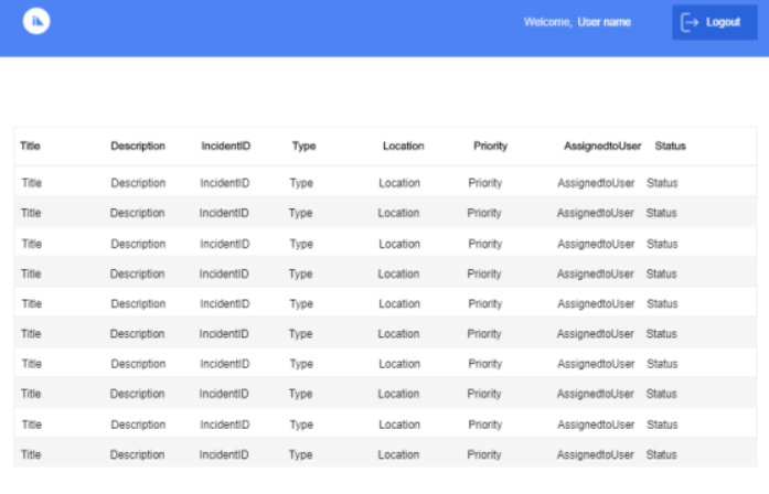

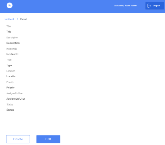

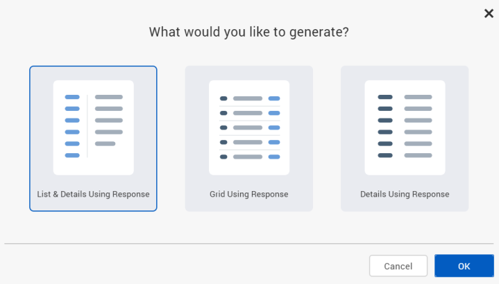

6. You can perform any of the following actions: * Drag and drop the service onto your form.

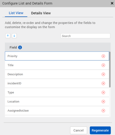

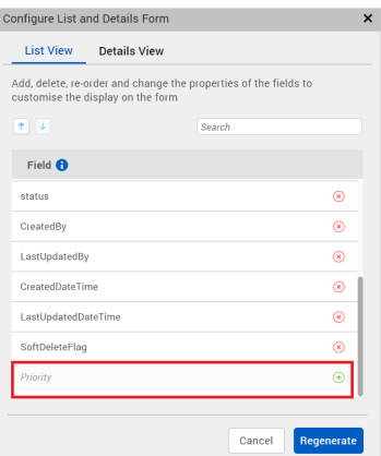

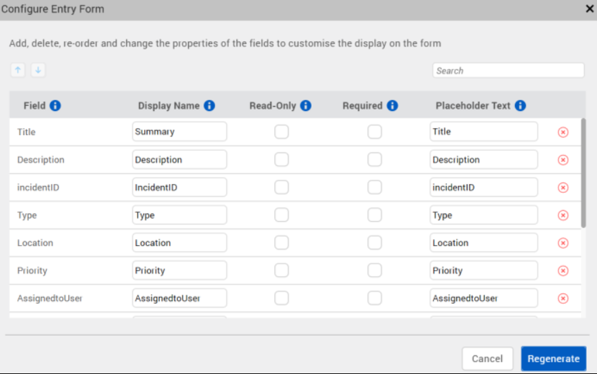

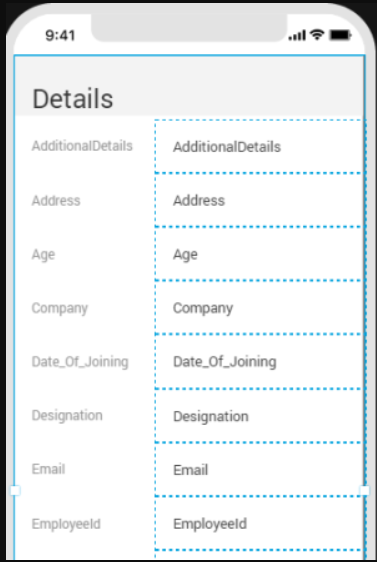

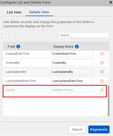

A dialog box appears asking you to generate either a List, or a Details, or an Entry form. You can select any of the three options as follows: * List Using Response: If the response contains a collection, a Segment is added to the parent form. This Segment is mapped to the Response parameter of the service. * Details Using Response: A FlexContainer with Labels is added. These Labels are mapped to the Response parameter of the service. * Entry form for Request: A FlexScrollContainer containing TextBoxes and Labels is added. The TextBoxes are mapped to the Request parameter of the operation. * Alternatively, you can directly drag and drop either the Response or Request parameter of the service onto the form: * Drag and drop Response parameter: If a service invocation already exists in the form, the Response parameter is added to the mapping of that service invocation. Otherwise, a new service invocation is added to the form's onMapping Event. * Drag and drop Request parameter: If a service invocation already exists in the form, this mapping is appended to it. Otherwise, a new service invocation is added on a generated Button widget. 7. Post this action, widgets are added to the form and the Integration service is associated with the form.
The selected Integration service appears under Project Services. You can expand any service to view its Request or Response parameters. The mapped parameters of any service appear in a bold and italics style to differentiate from unmapped parameters. Here, responseList appears in bold and italics format.

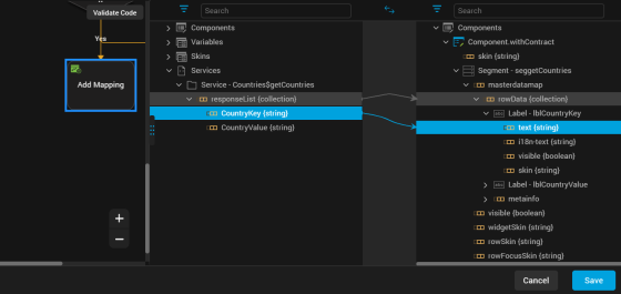

You can also click View Mapping to view the mapping details of the getContacts service in the Action Editor. The specific operation of the service is auto-highlighted in the Action Editor. Click Generate Code to view all the mappings of the getContacts operation.

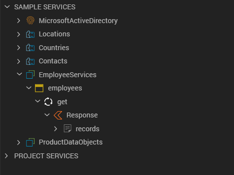

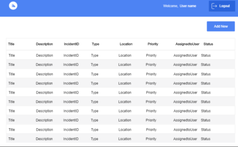

Use a Sample Object Service
To use a sample Object service, do the following:

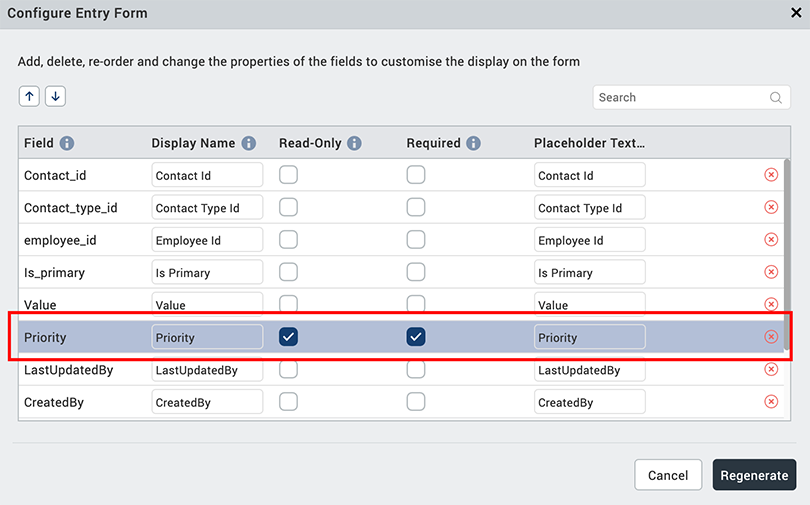

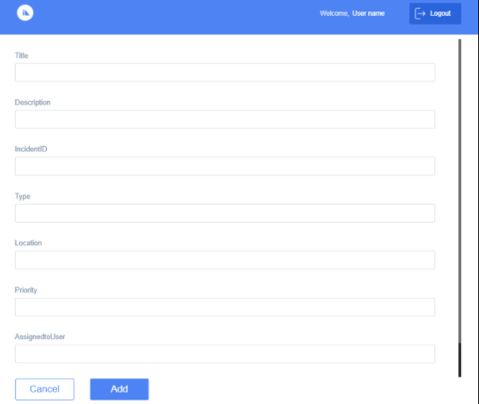

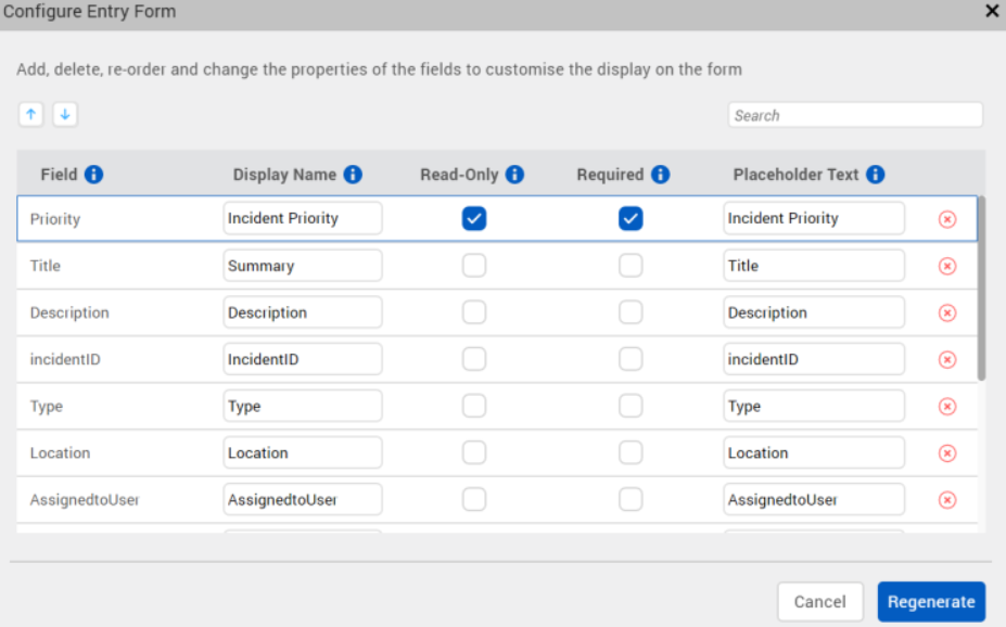

4. Expand any Object service. Here, EmployeeDataObjects and ProductDataObjects are the sample Object services. 5. Expand any Object service to view its available Request parameter. The respective responseList or requestList is auto-displayed. Here, Employee Services > employees > get > Response > records.

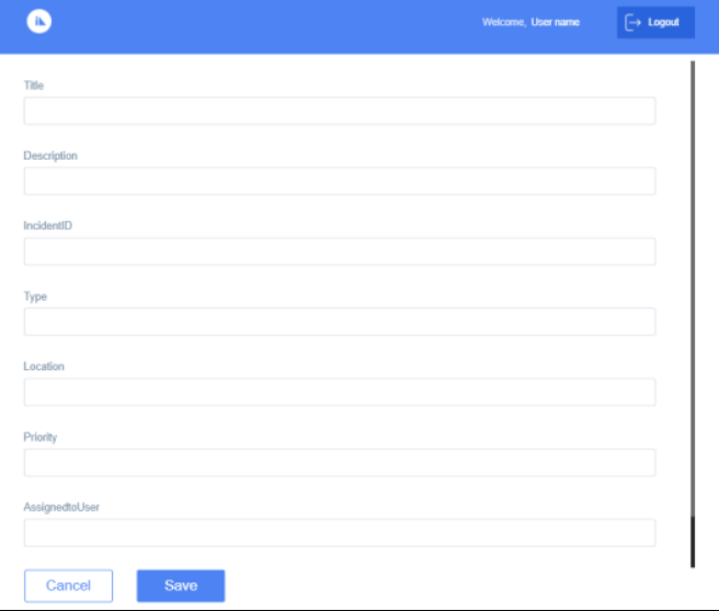

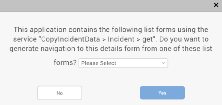

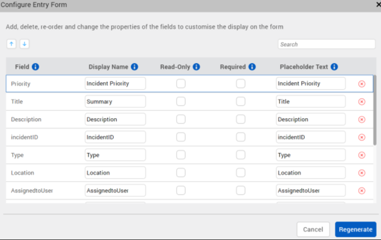

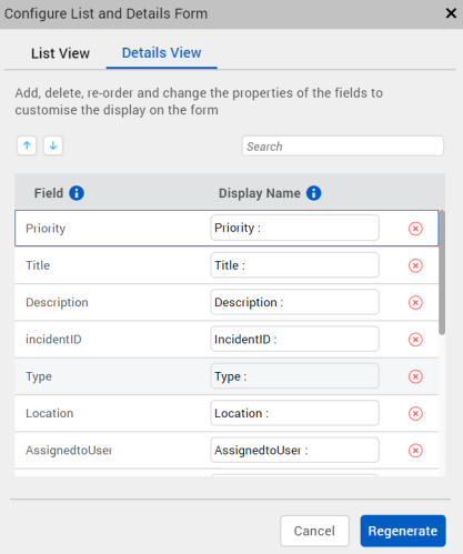

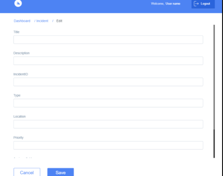

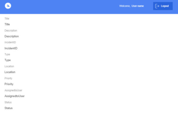

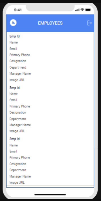

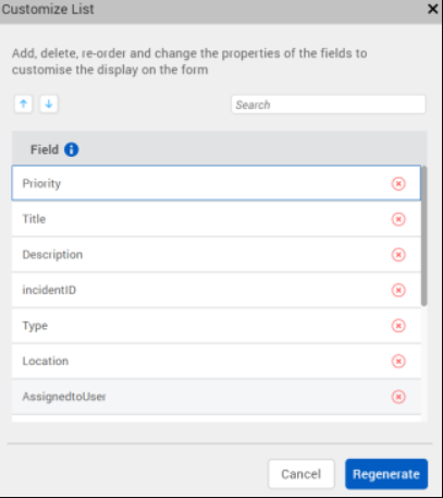

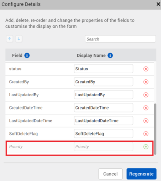

6. You can perform any of the following actions: * Drag and drop the service on to your form.

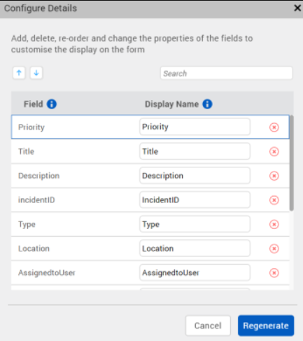

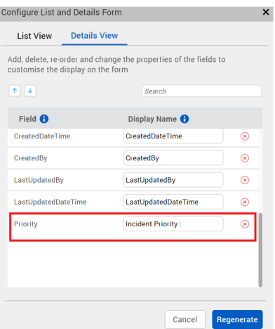

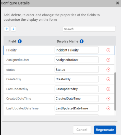

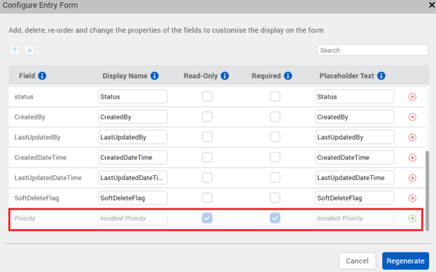

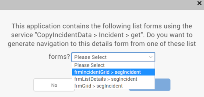

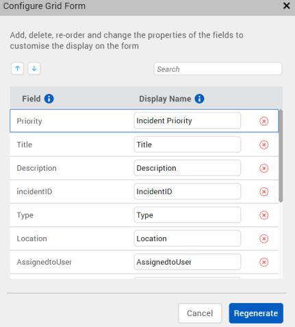

A dialog box appears asking you to generate either a List, or a Details, or an Entry form. You can select any of the three options as follows:* List Using Response: If the response contains a collection, a Segment is added to the parent form. This Segment is mapped to the Response parameter of the service. * Entry form for Request: A FlexScrollContainer containing TextBoxes and Labels is added. The TextBoxes are mapped to the Request parameters of the service. > **_Note:_** For the GET method in Object Services, the Entry form for Request option is disabled. * Details Using Response: A FlexContainer containing Labels is added. These Labels are mapped to the Response parameters of the service.-
Drag and drop Response parameter: If a service invocation already exists in the form, this is added to the mapping of that service invocation. Otherwise, a new service invocation is added to the form's onMapping Event.

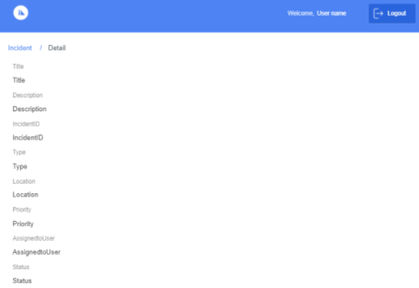

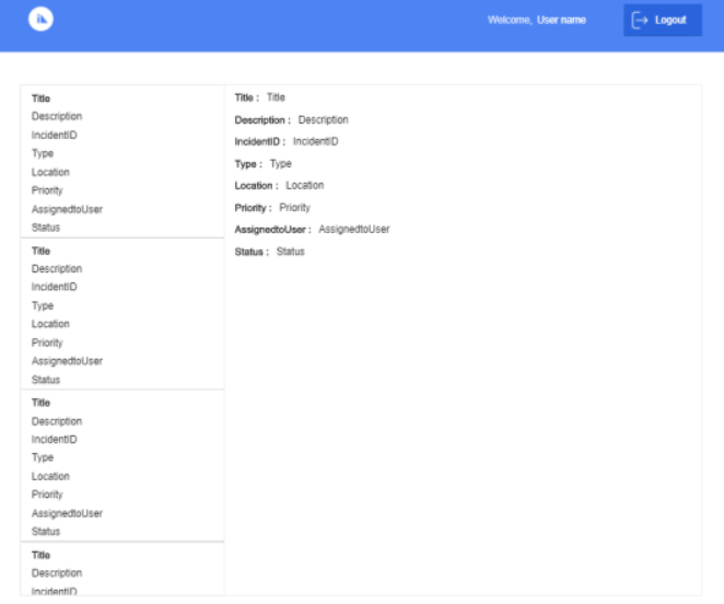

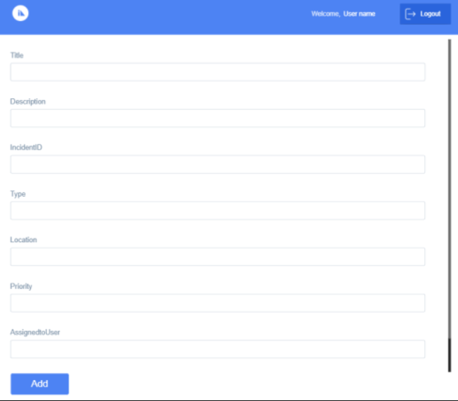

- Post this action, widgets are added to the form and the Object service is associated with the form.

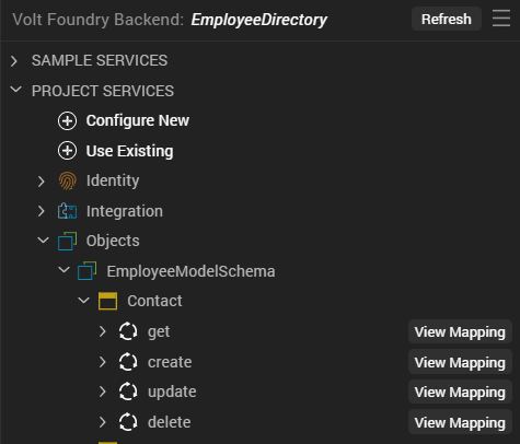

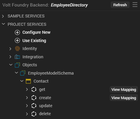

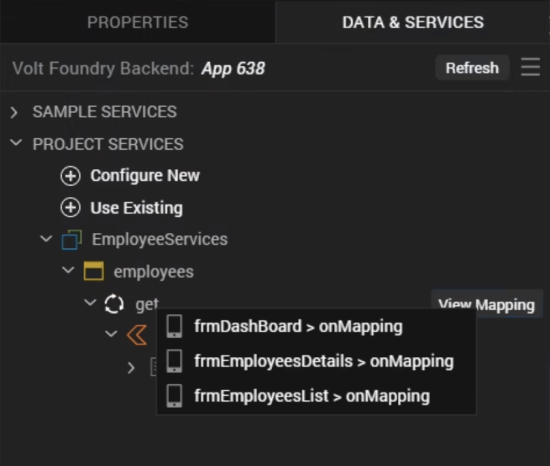

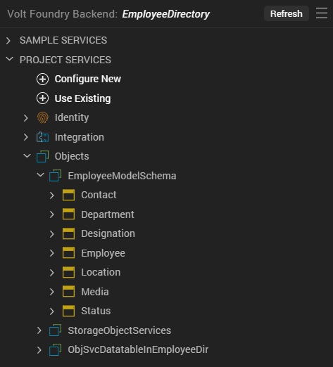

The selected Object service appears under Project Services. You can expand any service to view its Request or Response parameters. The mapped parameters of any service appear in a bold and italics style to differentiate from unmapped parameters.

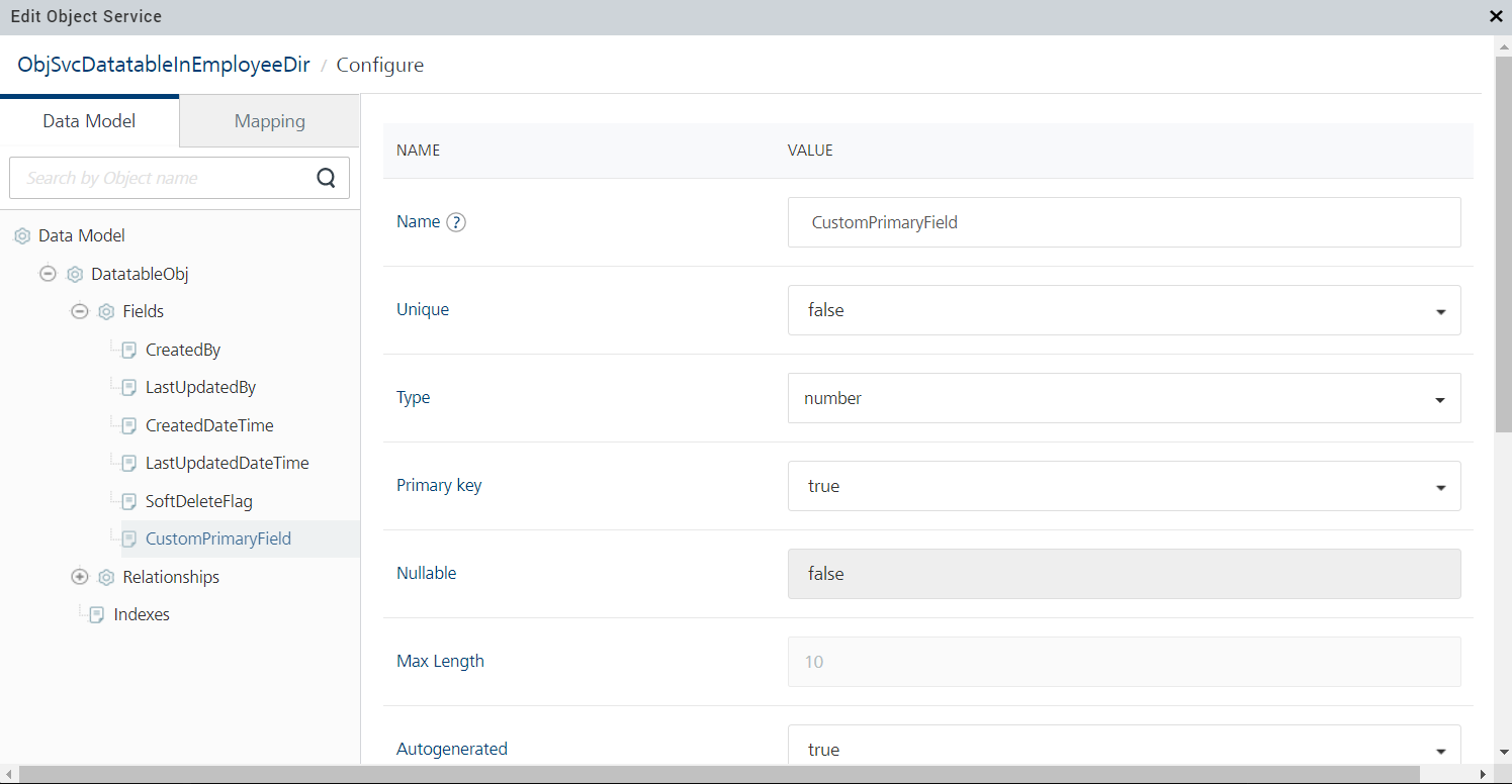

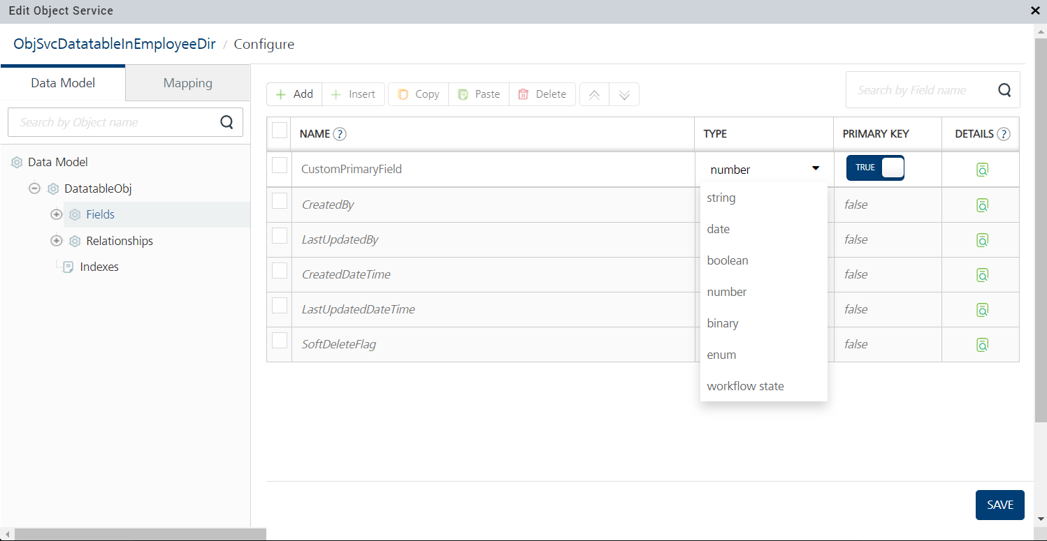

When you use the create method with primary key as incidentID, a Response parameter is automatically generated based on the run-time response of the app. under create > Response on the Data & Services panel.
You can also click View Mapping to view the mapping details of the get service in the Action Editor. The specific operation of the service is auto-highlighted in the Action Editor. Click Generate Code to view all the mappings of the get operation.

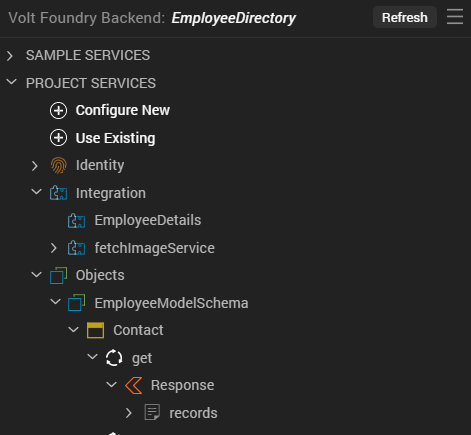

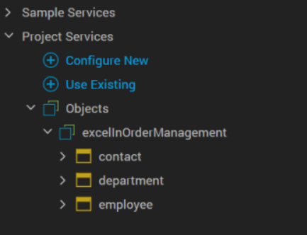

Use Existing Services
This section explains how to use and configure existing Identity, Integration, and Object services in your application by using the Data & Services panel.
From the Data & Services panel, configure existing sample services through a simplified view of Volt MX Foundry console. You can view the associated services in your corresponding Volt MX Foundry app.

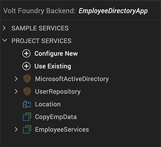

To select and use an existing Identity/Integration/Object service, do the following:
- In Volt MX Iris, create or open your project.
- From the Data & Services panel, select Project Services from the list. The list of available services appears.
Click Use Existing. A list of options appears.
Select either Identity, Integration, or Objects, and then sign in to your Volt MX account to use the required service available in your Volt MX Foundry instance:
- For Identity service: The Select Identity Service(s) window appears.
Choose the required Identity service; if no service is available in your Volt MX Foundry Console, you need to configure one. Specify the details in the required fields, and then click Save. For more information on how to create an Identity service, click here. -
For Integration service: The Select Integration Service(s) window appears.
Choose the required Integration service; if no service is available in your Volt MX Foundry Console, you need to configure one. Specify the details in the required fields, and then click Save & Add Operation. For more information on how to create an Integration service, click here. In this case, the Salesforce Integration service.
* For Object service: The Select Object Service(s) window appears.
Choose the required Object service; if no service is available in your Volt MX Foundry Console, you need to configure one. Specify the details in the required fields, and then click Save & Generate. For more information on how to create an Object service, click here.
5. Once the service is created, it is displayed in the Project Services list. You can then directly drag and drop the service onto a form and start using it.

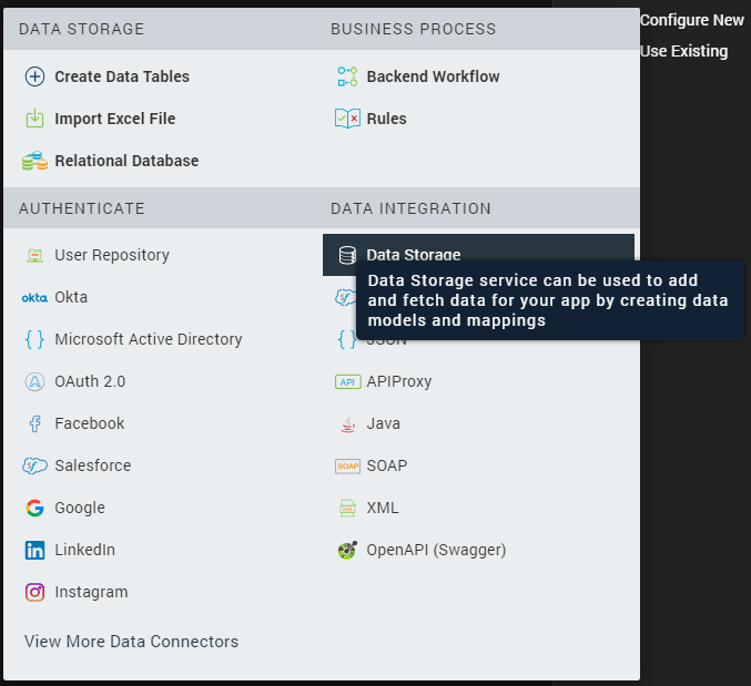

Create and Use New Services
This section explains how to create new services by using the Data & Services panel and how to use those services in your application.
From the Data Panel, you can set up new data sources (VoltMX Foundry services) through a simplified view of Volt MX Foundry console. You can view the associated services in your corresponding Volt MX Foundry app.

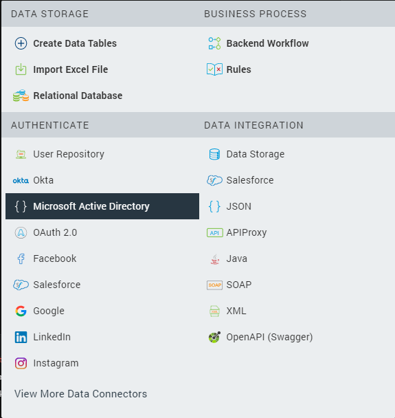

To create a new Identity service, do the following:
- In Volt MX Iris, open your project.

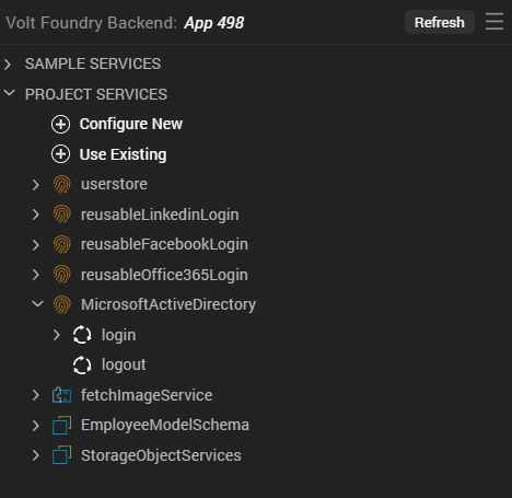

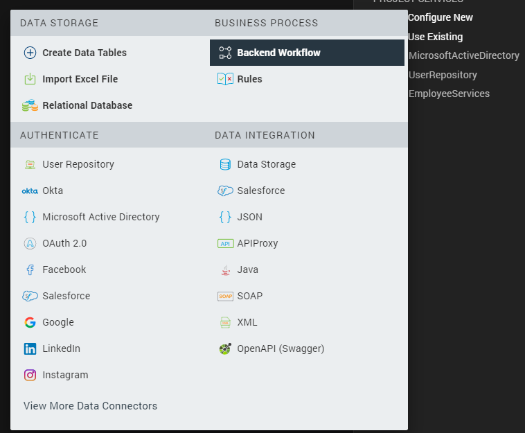

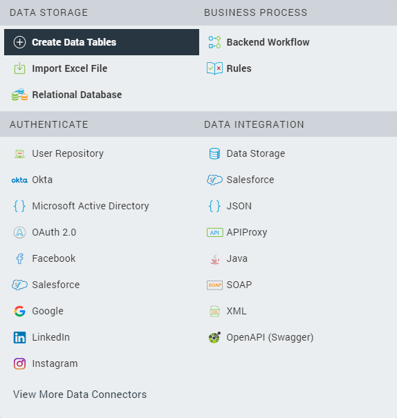

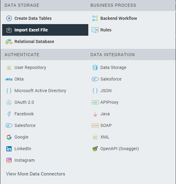

- Click Configure New. A list of services that you can configure appears.

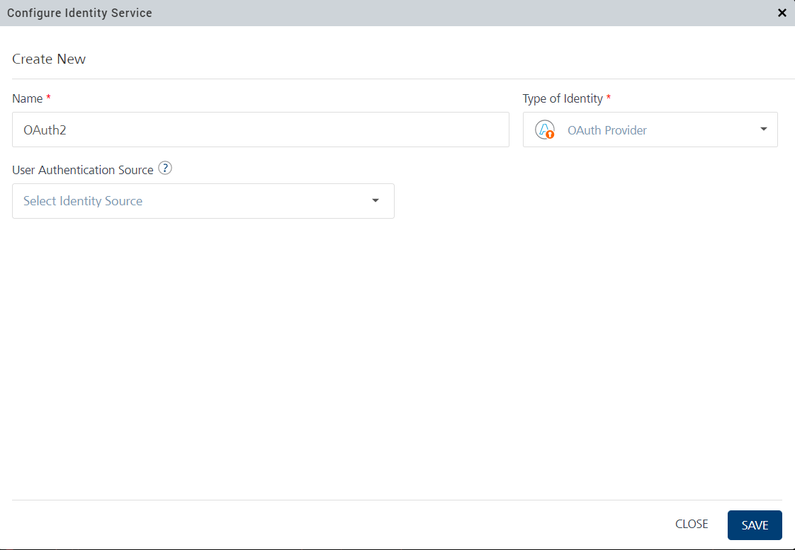

Under Authenticate, select an Identity service; in this case, Microsoft Active Directory.
5. The Configure Identity Service window appears, by using which you need to configure the Microsoft Active Directory service. Specify the details in the required fields, and then click Save. For more information on how to create an Identity service, click here.
Â
6. Once the service is created, it is displayed in the Project Services list. You can then directly drag and drop the service onto a form and start using it.

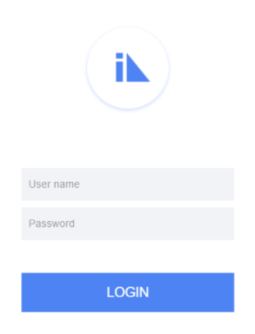

When you drag and drop an Identity service onto a form, various widgets are created automatically on the form based on the type of service: OAuth or Non-OAuth. For a Non-OAuth service, two text fields (username and password) and a button (Login) are generated. For an OAuth service, only a Login button is generated.
When you click the View button, the newly created form appears. The form’s pre-show invokes the Identity service and passes the reference of the Browser widget. You can modify the Browser widget, which you linked to the button, with a different Browser widget.

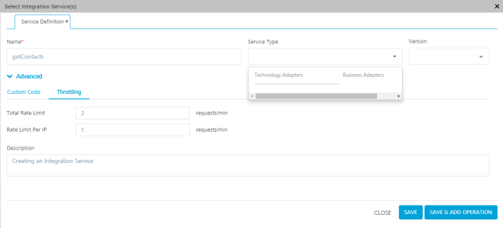

Create an Integration Service
By default, you can view Integration services in the Data & Services panel. You can also set up new data sources. Once you configure the Integration service, you can view the request and response parameters.
To create a new Integration service, do the following:
- From the Data & Services panel, expand Project Services.
- Click Configure New to configure a new Integration service. A list of services that you can configure appears.

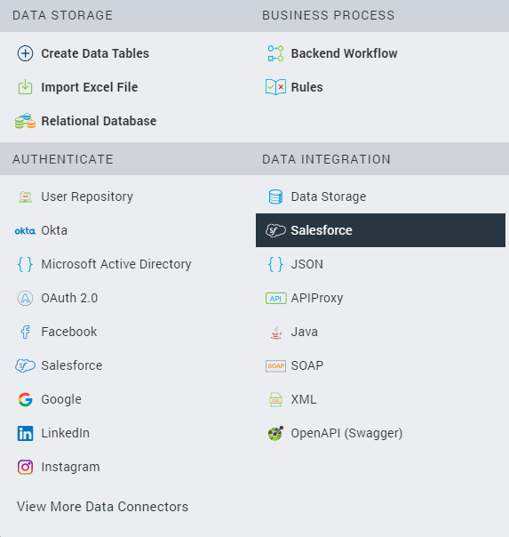

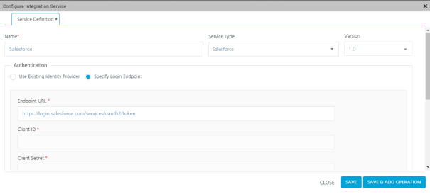

Under Get Data, select an Integration service; in this case, Salesforce.
5. The Configure Integration Service window appears, by using which you need to configure the Salesforce service. Specify the details in the required fields, and then click Save & Add Operation. For more information on how to create an Integration service, click here. In this case, the Salesforce Integration service.

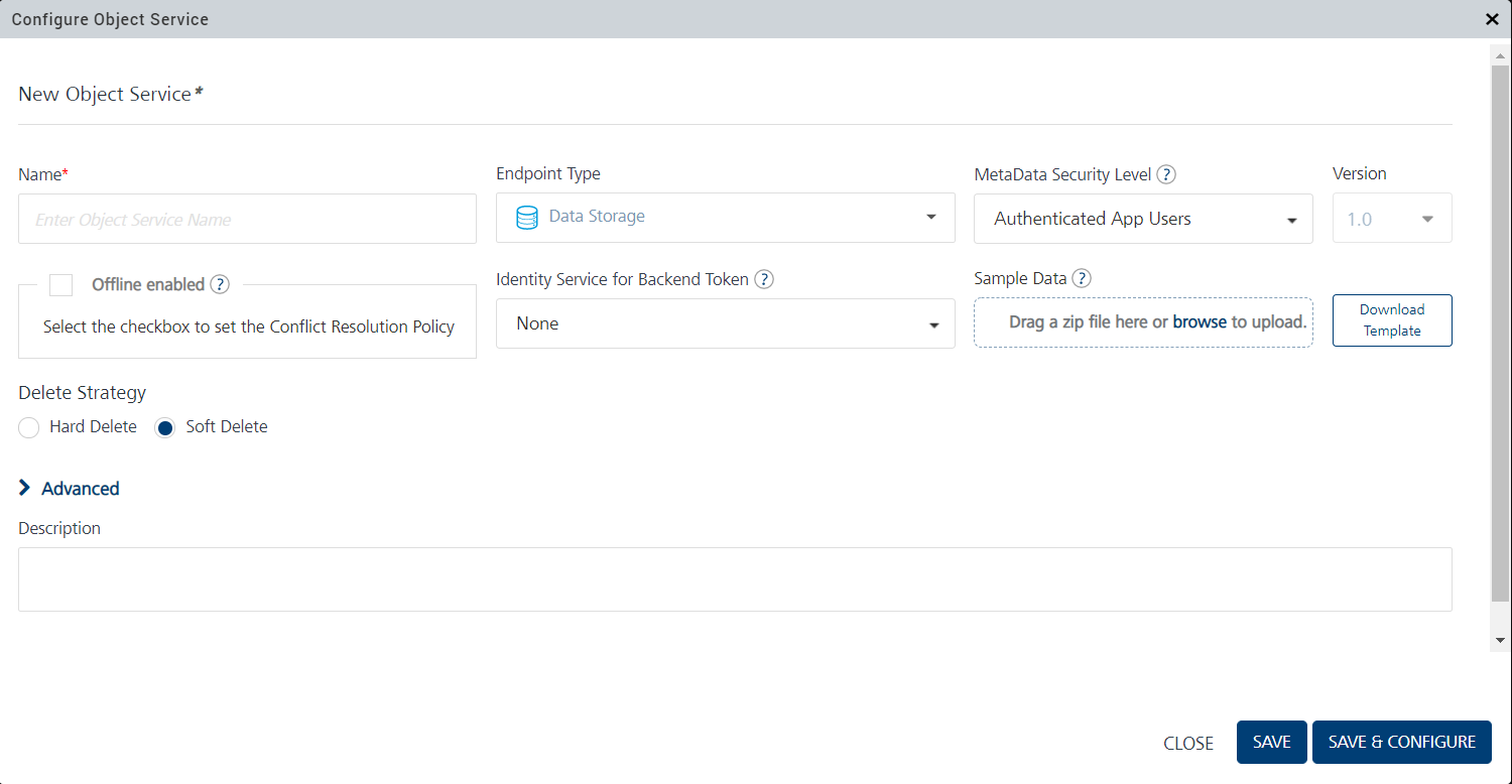

Create an Object Service

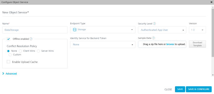

You can view Object services in the Data & Services panel. You can also set up new data sources. Once you configure an Object service, you can view the request and response parameters.

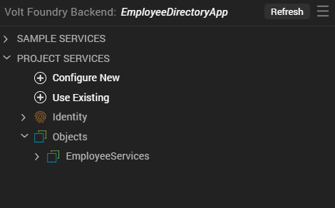

To create a new Object service, follow these steps:

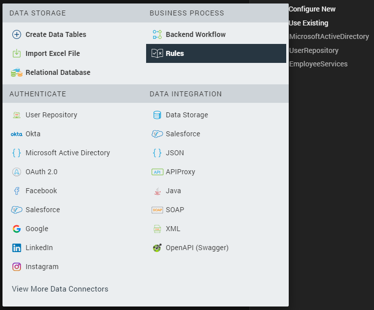

- Click Configure New. A list of services that you can add appears.

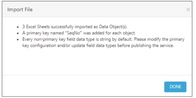

Under the Data Integration section, select an Object service. Here, Data Storage is the Object service.
Note: In Volt MX Iris V9 SP 2, the Data Storage Object service is available under the Data Integration section in the list of services.

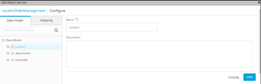

The Configure Object Service window appears, with Endpoint Type selected as Storage by default. You must type the Name of the Data Storage Object service and also specify other details in the necessary fields. Then either click Save & Configure to configure the object data model or click Save to just save the new service. For more information on how to create an Object service, click here.
After the service is created, it is displayed under Project Services > Objects. You can then directly drag and drop the service onto a form and start using it.

- Click Configure New to configure a new Backend Workflow.
A list of services that you can configure appears. - Under Business Process, select Backend Workflow.
A list of services that you can configure appears. - Under Business Process, select Rules.

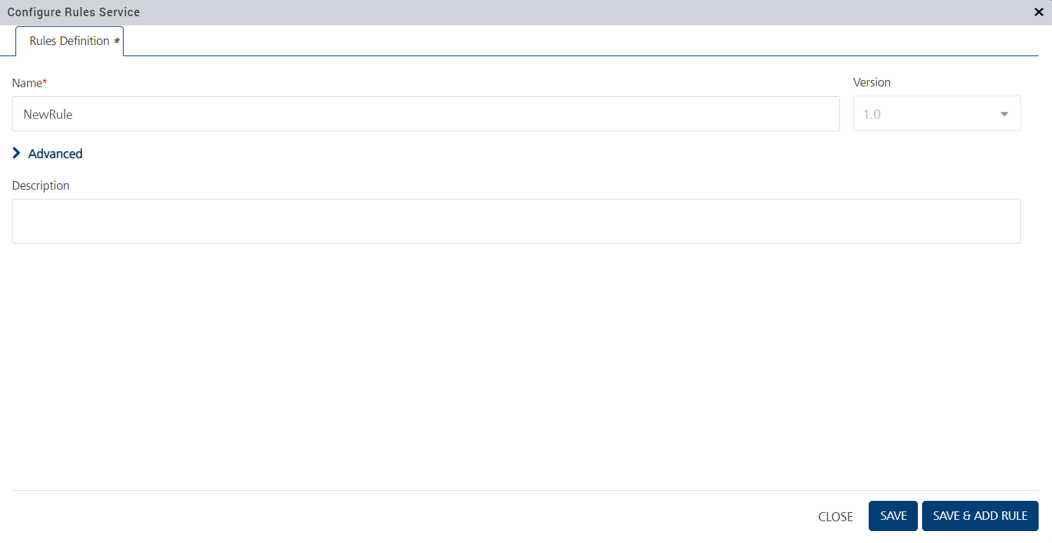

The Configure Rules Service window appears.
- In the Name field, type a unique name for the Rules service, and also specify other details in the necessary fields.
For more information on how to create a Rules service, click here. - Click Save & Add Rule to configure the Ruleset, or click Save to just save the new service.

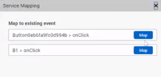

- Drag and drop appropriate services on to the buttons. The Identity service is associated with the form.
Use an Integration Project Service
To use an Integration Project service, do the following:
Click Use Existing.
A list of available services appears. -
Click Integration Service.
The Select Integration Service dialog box appears. - Select the required service from the list of available services, and then click Add.
The service appears in the Data & Services panel. - Expand the service that you want to use and view the requests/responses of the service.
- Drag and drop the service onto your form. The service is associated with the form.

Use a Rules Service
To use a Rules service, do the following:
Click Use Existing.
Click Rules Service.
The Select Rules Service dialog box appears. - Select the required service from the list of available services, and then click Add.

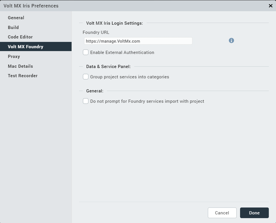

Disable/Enable the Categorization of Project Services
In Volt MX Iris V9 SP 2, the service categories are displayed under Project Services only when a service is linked from the Data & Services panel. In addition, an option to disable/enable the categorization of linked services under Project Services has been provided in the Iris Preferences window.
To disable/enable the categorization of linked services under Project Services, follow these steps:
In Volt MX Iris, click Edit > Preferences. The Iris Preferences window appears.
2. Click the VoltMX Foundry tab.
3. Under the Data & Services Panel section, the Group project services into categories check box is selected by default.
4. To disable the categorization of linked services under Project Services, clear the Group project services into categories check box.
5. Click Done. The linked services under Data & Services panel > Project Services do not appear in the categories of either Identity, Integration, or Object services.
Note: To enable the categorization of linked services under Project Services again, go to Edit > Preferences > Volt MX Foundry tab and select the Group project services into categories check box. The linked services under Data & Services panel > Project Services appear in the categories of either Identity, Integration, or Object services respectively.
Unlink a Service
You can unlink a service from your project by right-clicking the service and selecting Unlink.
To unlink a service, follow these steps:
- From the Data & Services panel, expand Project Services. The list of available services appears.
Right-click the service that you want to unlink. A list of options appears.
Select Unlink. The Confirm Service Unlinking window appears. This window provides details on the operations and their respective action sequences that will be unlinked for that service, and asks for your confirmation whether you want to unlink the service.
- Click Ok. The service is removed from the Project Services list.

To understand this feature in detail, let us consider a scenario where Steve (a low-code developer) wants to create an app called Incident Management. He has already created the associated Volt MX Foundry app, and now wants to configure the app's UI.
The Admin of an airport can use the Incident Management Responsive Web app to view, create, update, and assign incidents/tasks to relevant staff members. In addition, staff members can use the Incident Management Mobile app to view and act upon their assigned tasks as well as to create new tasks.
The Responsive Web and Mobile apps comprise of four forms: list, detail, update, and create.

List and Details Using Response Form
When you drag and drop the Get operation in an Object service onto a Responsive Web form and select the List and Details Using Response option, this type of form is generated on the Project Canvas. A list and details form consists of a list of items and if a user selects a specific item, the details of that item are displayed on the right of the screen.
Grid Using Response Form
When you drag and drop the Get operation in an Object service onto a Responsive Web form and select the Grid Using Response option, this type of form is generated on the Project Canvas. A grid form is a tabular representation of list items. Users can select any row grid item, and they are navigated to the details screen of that item.
When you drag and drop the Get operation in an Object service onto a Responsive Web form and select the Details Using Response option, a dialog box appears. If a Responsive Web list form already exists, the dialog box asks if you want to generate navigation from the link to the details form. Click Yes to generate a navigation link between the list and detail forms; otherwise, click No.
Note: If multiple Responsive Web list forms are present, then you will need to choose one list form to create the navigation link.
A details form is then generated on the Project Canvas. The details form contains additional information of a list item. If you create the navigation link between the list and detail forms, users are taken to the detail form when they select a specific list item.

When you drag and drop either the Create or Update operation in an Object service onto a Responsive Web form, an Entry form is automatically generated on the Project Canvas.
Create Operation
When an entry form is added for a Create operation, users can specify the required details to create new list items. The following image illustrates the Create Incident screen of the Incident Management app. App users can leverage this screen to create new incident items and assign them to relevant people.
Update Operation
When an entry form is added for an Update operation, users can make the required modifications to existing list items. The update method automatically fetches the values of the selected record and pre-fills the details in the respective fields.
The following image illustrates the Update Incident screen of the Incident Management app.

Expand Objects > CopyIncidentData > Incident.

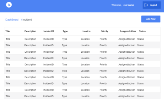

Grid Form
Details Form
If you perform the Generate Forms action for the create or update methods, only the Create/Update entry form is generated.
Object-level: Right-click Incident, and then select Generate Forms > Desktop. Four types of forms (Grid, Details, Create entry form, and Update entry form) are generated with the respective navigation links among each other. An appropriate breadcrumb link is also displayed at the top of the Details, Create, and Update forms. Users can click the breadcrumb link to go back to the Grid screen of the app.
Grid Form
Details Form
Create Form
Update Form

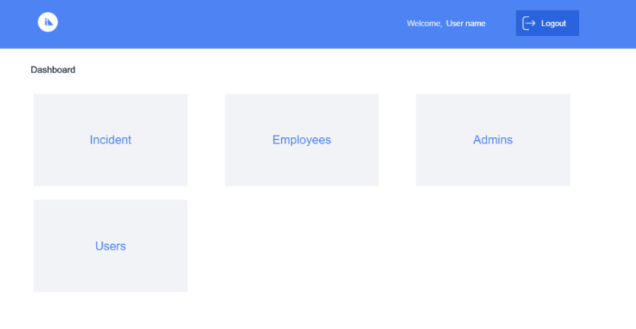

The Object service: Right-click CopyIncidentData, and then select Generate Forms > Desktop. Five types of forms (Dashboard form, Grid, Details, Create entry form, and Update entry form) for each object in the Object service are generated, with the respective navigation links among each other.
The Dashboard form displays all the objects that are part of the selected Object service. From the Dashboard screen, app users can navigate to the respective Grid, Details, Create, and Update forms of the objects. If you have not defined the startup form of the app, the Dashboard form is made the startup form by default.
An appropriate breadcrumb link is also displayed at the top of the Grid, Details, Create, and Update forms. Users can click the breadcrumb link to go back to either the Dashboard screen or Grid form of the app, as appropriate.
Dashboard Form (with Incident object)
Grid Form
Details Form
Create Form
Update Form
Note: If an Object service contains multiple data model objects, then all available forms and navigation links for each data model object are generated.
For example, in the following image, the excelInOrderManagement Object service contains three data model objects: contact, department, and employee. So if you try to generate CRUDÂ forms for the excelInOrderManagement Object service, all available forms and associated navigation links are generated for the contact, department, and employee data model objects.
Create a Data Table for an Object Service
In Volt MX Iris V9 SP 2, you can create a data table for an Object service. Several details such as data type, Primary key, nullable, and maximum length can also be specified for the fields of the Object Service.
Note: You can create a data table for either an existing Volt MX Foundry app or for a new one.
To create a data table for an Object service from within Volt MX Iris, follow these steps:
On the Data & Services panel, expand Project Services.
- Click Configure New. A list of services appears.
Under the Data Storage section, click Create Data Tables. The Edit Object Service > Data Model > Fields window appears. A new Object is created in which you can quickly configure object fields. By default, every Object contains some system-generated fields.
Click Add. A new field is created in the fields definition table.
- Under the Name column, type the required name of the field. Here, Version is the field name.
- Under the Type column, select the data type of the field. The available data types include string, date, boolean, number, binary, and enum. The string data type is selected by default.
Note: The Enumeration (enum) data type enables you to add a maximum of 50 comma-separated options as valid values in a field. For example, a field called Priority can have enumeration values such as Critical, High, Medium, Low and a field called Gender can have valid values such as Male, Female, Other. The enum data type is rendered as a drop-down list containing only those valid values that you defined, and users can choose only one option at a time for that field. This data type is available In Volt MX Iris V9 SP 2. For more information on how to configure the enum data type, click here.
If you want to set the field as a Primary Key, select Primary Key as True. The Primary Key value is False by default.
2. If you want to view or modify any additional details of the field, click the View icon
on the field entry row. The field details window appears. You can view or modify any editable details, and then click Save.
3. Click Save, and then close the Edit Object Service window. The data table and new data table objects are created, and are displayed under Project Services > Objects as shown here.
Note: You can create multiple objects in the data table of an Object service by following this procedure. These objects are then displayed as newObject
under Project Services on the Data & Services panel.
Configure an Object Data Model by Importing an Excel File
In Volt MX Iris V9 SP 2, you can create an object data model for an Object service by importing a locally-stored Microsoft Excel file. With this feature, low-code developers have an easy and faster way to import an object data model from a locally-stored Excel file.
Note: You can import an Excel file for either an existing Volt MX Foundry app or for a new one.

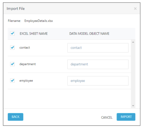

To create an object data model by importing an Excel file for an Object Service from within Volt MX Iris, follow these steps:

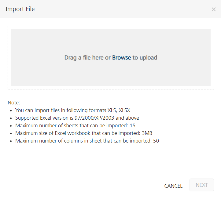

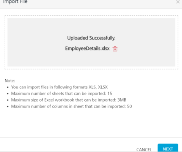

Under the Data Storage section, click Import Excel File. The Import File window appears.
5. You can perform any one of the following actions:- Directly drag and drop the Excel file.
- Click Browse to search for, and then select the Excel file from your local system.
6. After the Excel file has been successfully uploaded, a confirmation message appears. Click Next.
If you want to delete the uploaded file and import a different Excel file instead, click the Delete
icon.
The uploaded Excel Sheet is selected by default. In the Data Model Object Name box, type the required name of the data model. If there are multiple sheets in the Excel file, you can add the name of each sheet.
You can add the underscore (_) symbol in the data model object name. However, you cannot include any spaces or special characters in the data model object name.
Click Import. After the Excel sheet has been successfully imported, a window with a confirmation message appears. Click Done.
The Edit Object Service window for the respective Volt MX Foundry app appears. You can use this window to configure various items of the Object service data model, such as the Name, Description, Fields, Relationships, Indexes, and Primary Keys. For more information on how to configure the data model of an Object Service, refer the Configuring a Data Model topic in the VoltMX Foundry User Guide.
4. After you have configured the Object service data model, click Save and then close the Edit Object Service window. The object data model is created, and is displayed under Project Services > Objects.

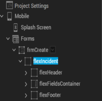

Important: To dynamically configure the fields of the object model, you must click the parent container of the request/response parameter on the form. Then go to Properties panel > Look tab > Dynamic Form section, and click Edit beside Customize fields.
In the following image, flexIncident is the parent container of the service parameter on the frmStartUp form. Only while the parent container is selected, the Dynamic Form section appears under Properties panel > Look tab.
Important: If you do not click the parent container of the request/response parameter on the form, the Dynamic Form section does not appear under Properties panel > Look tab. While any child container of the service parameter or the form itself is selected, the Dynamic Form section does not appear.
In the following image, flexHeader is a child container of the service parameter on the frmStartUp form. While this child container is selected, the Dynamic Form section does not appear under Properties panel > Look tab.

In this section, we will configure the dynamic properties of the fields on the Create Incident Entry screen of the Incident Management Mobile app:
- In your Volt MX Iris project, go to Project Explorer > Mobile > Forms, and then create a new form called frmCreate.
Go to the Data & Services panel > Project Services > Objects > CopyIncidentData > Incident.
3. Drag and drop the create method onto the Project Canvas. The entry form is generated.

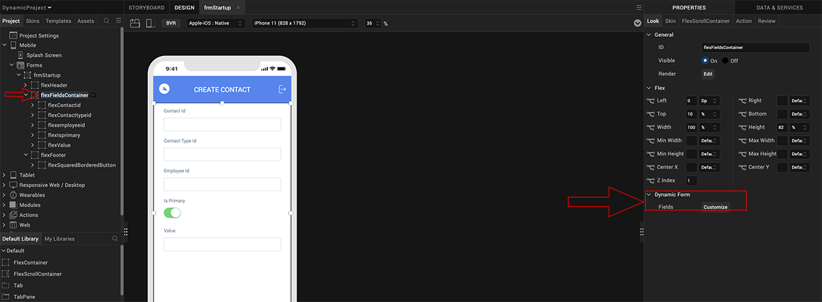

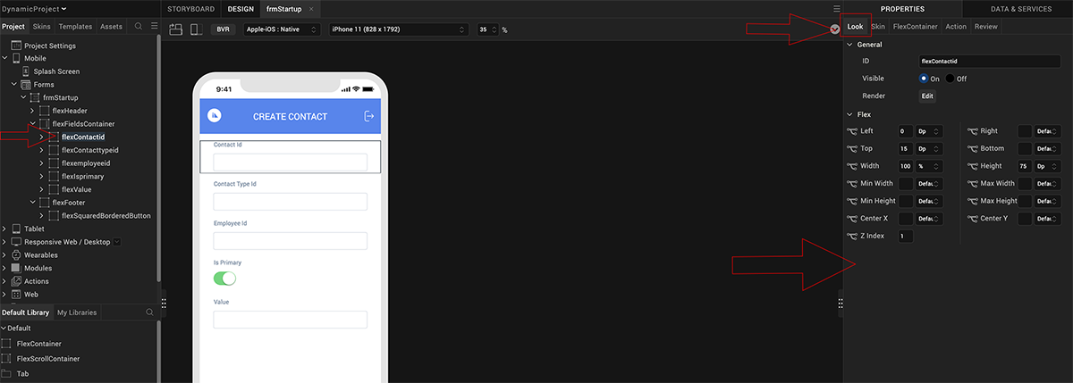

4. On the Project Explorer, under frmCreate, click flexIncident. Here, flexIncident is the parent container of the create Request parameter.

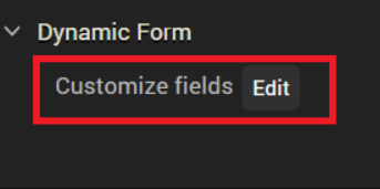

5. Go to Properties panel > Look tab > Dynamic Form, and then click Edit beside Customize fields. The Configure Entry Form window appears.

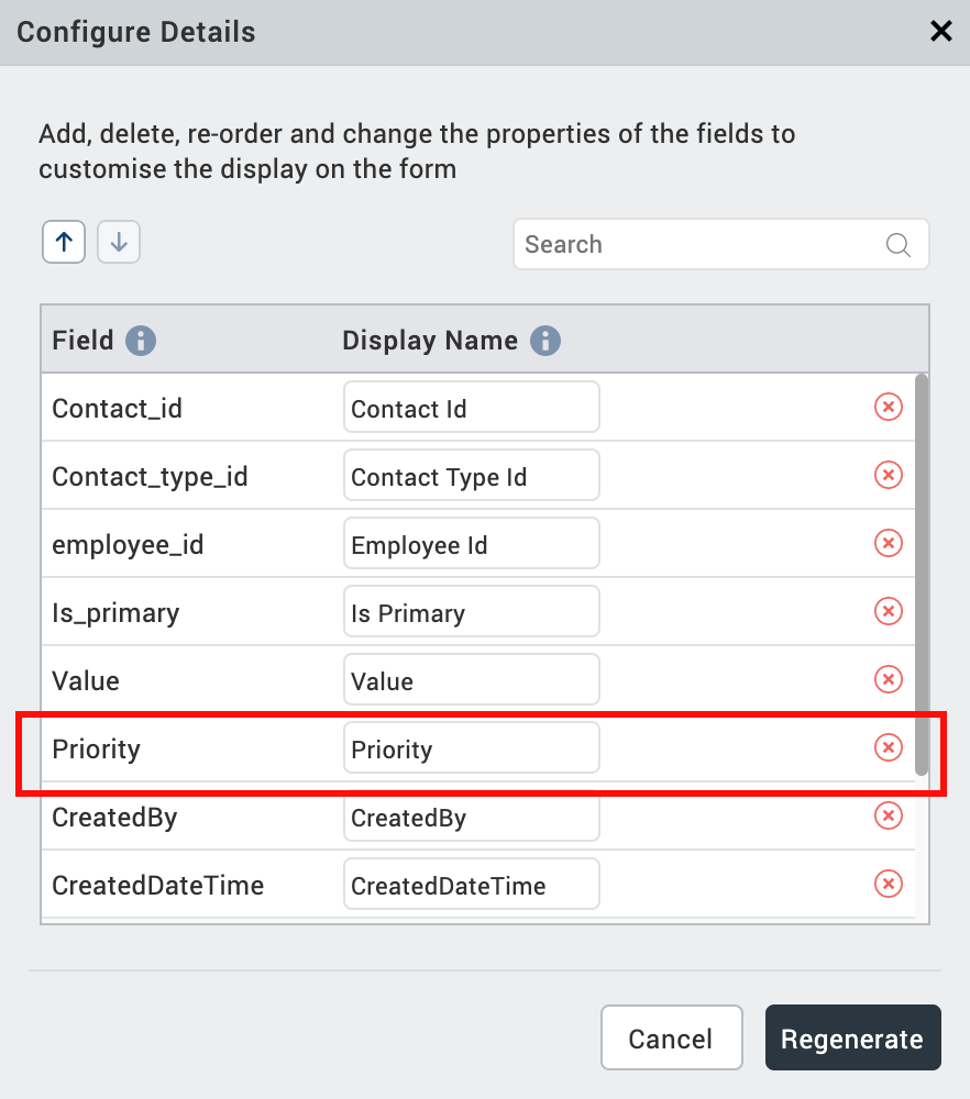

You can use the Configure Entry Form window to configure the dynamic properties of the fields. In this procedure, we will discuss the following operations that can be performed on a field called Priority on the frmCreate form:

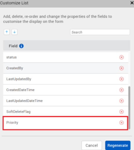

Reorder a Field: In the Configure Entry Form window, click the Priority field. Keep clicking the Move Up icon
until the Priority field is at the top of the list as shown.
In List Using Details Forms
In Details Using Response Forms
In List and Details Forms
In Grid Forms
Note: If you want to move a field down the order, select the field and click the Move Down icon
as many times as necessary.
Add/Modify the Display Name and Placeholder Text: In the Configure Entry Form window, for the Priority field, type the Display Name as Incident Priority. Similarly, type the Placeholder Text as Incident Priority as shown.
Display Name signifies the name of the field that is displayed on the screen. And Placeholder Text enables you to provide a help text about the field.
In Grid Forms
Note: The Display Name and Placeholder Text fields are not applicable for list (List Using Response) forms. And the Placeholder Text field is not available for detail (Details Using Response) forms.
Configure the Read-Only and Required Properties: In the Configure Entry Form window, for the Priority field, select the Read-Only and Required check boxes.
Read-only fields signify that these fields cannot be edited by users. And Required fields signify that it is mandatory for users to specify the information for these fields; an asterisk is displayed on the UI for all Required fields.
Note: The Read-Only and Required check boxes are only applicable in Entry forms; as part of the create and update methods. These check boxes are not available in List Using Response and Details Using Response forms.

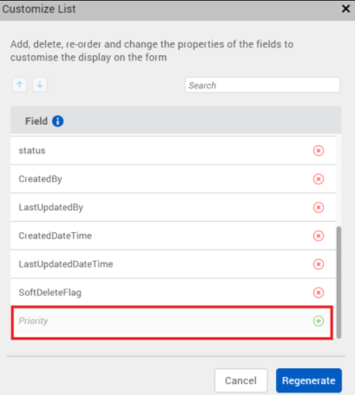

Delete/Add a Field: In the Configure Entry Form window, for the Priority field, click the Delete
icon. The Priority field is removed from the top of the list, moved to the bottom, and the text is displayed in gray color.
If you want to reinstate the Priority field, click the Add
icon beside it. The Priority field becomes active again.
Delete Operation
Add Operation
In Grid Forms
Delete Operation
Add Operation
After you have performed the necessary operations for the Priority field in the Configure Entry Form window, click Regenerate. The dynamic properties of the Priority field are saved, and the updated frmCreate form is generated on the Project Canvas.

To map data for the Segment in a component for different channels, follow these steps:
- In Volt MX Iris, create a component.

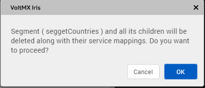

- Drag and drop a get method of an Integration or Object service (for example, getCountries) from the Data & Services panel onto the component that you just created. A dialog box appears asking you to select what type of form you want to generate: List Using Response or Details Using Response.
Select the List Using Response option. A Segment (for example, seggetCountries) is added to the component, a list form is generated on the Project Canvas, and the mappings between various elements are auto-generated in Mapping Editor.
On the Project Canvas, change the channel of the component from Mobile to Tablet, or vice-versa. For example, if you had been using the iOS Mobile: Native channel, change it to iOS Tablet: Native.
- On Project Explorer, select the Segment of the component, and go to Properties panel > Segment.
- For the Row Template list box, select the SampleRowTemplate option.
- On Project Explorer, select the parent FlexContainer of the component, and then go to Properties panel > Action.

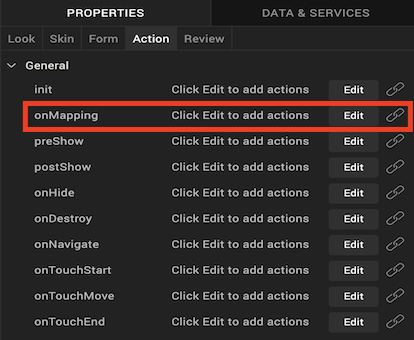

- Under the Component section, for the onMapping Event, click Edit. The Action Editor window appears, with Diagram View open by default.
- In the flow diagram, click the Add Mapping action. Mapping Editor opens on the right pane of Action Editor.
Map the required service parameters to the Segment rowData and associated rowData elements, as shown here.
8. Click Save.
9. Click Code View to see the code details of the data mappings. For Mobile
For Tablet
10. Click Save. You have successfully mapped service parameters to the Row Data widgets of the Segment in a component for the Mobile and Tablet channels.

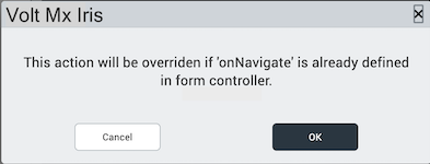

To use the data that is received from frm1, follow these steps:
Click frm2, and then go to Properties > Action.
For the onNavigate Event, click Edit. A confirmation dialog box appears stating that if you have already defined the onNavigate Event in FormController, the current action will not be respected.
3. Click Ok. The Action Editor appears. 4. From the list of actions on the left, scroll to the Functions section, and then click Add Snippet. The code snippet is added to frm2. 5. Click Generate Code. For this action sequence, you can access the data from the eventobject argument. This is the same argument that was passed from frm1.
Click Close.

Associated Data & Services Panel Features
Volt MX Foundry Node on the Data & Services Panel

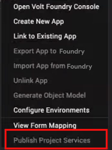

In Volt MX Iris V9 SP 2, the VoltMX Foundry node and associated actions have been shifted from the Project Explorer to the Data & Services panel. This feature has been introduced to enable a unified and enhanced user experience of using Volt MX Foundry data and services from within Volt MX Iris.
Click the hamburger menu icon
at the upper-right corner of the Data & Services panel. From the list of options that appears, you can perform the following Volt MX Foundry-related actions:
- Open Volt MX Foundry Console
- Create a Volt MX Foundry app
- Link (your Volt MX Iris project) to an existing Volt MX Foundry app
- Export app from Volt MX Iristo Foundry
- Import App from Foundry to Volt MX Iris
- Unlink a Volt MX Foundry app from your Volt MX Iris project
- Configure Volt MX Foundry environments
- View form mapping of linked Project Services
- Publish your Volt MX Irisapp to Volt MX Foundry
Mapping Event
Mapping event is available in the Mapping Editor. Service invocations dropped on a form or a FlexContainer in a canvas are mapped to the mapping event .
Note: When you map the Request and Response nodes, the Mapping Editor prompts a warning message The Request/Response query for this verb uses custom XML mapping in Foundry. Hence dynamic UI generation and mapping is not supported in Iris.
Note: If you add code to the preshow event dynamically, the new code added will override the mapping event.
View Mapping
When View Mapping is selected for a service on the data panel, the associated action is displayed.
If more than one action sequence is associated to a service, a fly-out menu is displayed with a drop-down list. You can select the Mapping Action Sequence you want to view. This opens the Action Editor. For more information, refer Action Editor.
