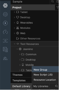

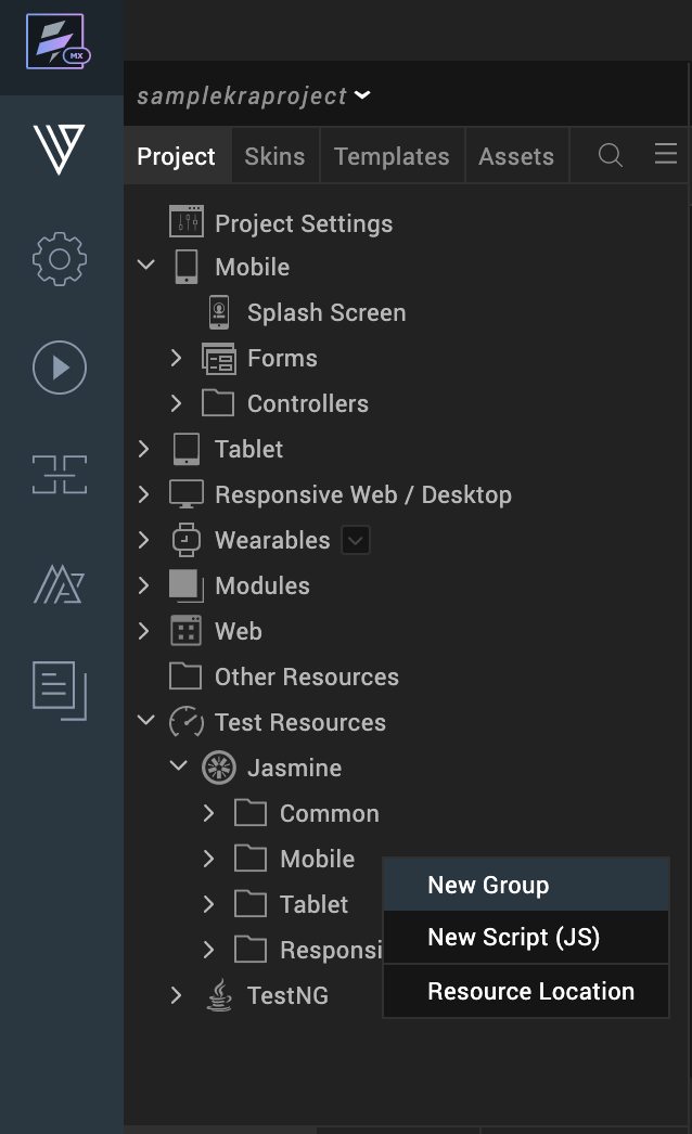

  2. From the Project explorer, go to Test Resources > Jasmine.
  3. Click on the drop-down icon of the channel in which you want to create the test script and then select New Script (JS).
    Note: It is not mandatory to create the new file. You can write all your automation scripts in the automationStartup.js file, that is auto generated. You must create a new file only when you want to segregate test scripts for each of your app flow.

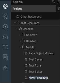

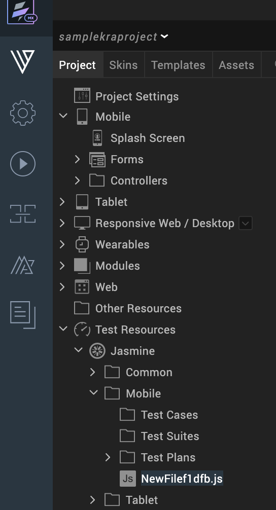

  4. A new test script is created.
  5. Enter your automation code in the new test script created. For instance, following is the code for testing a button on-click action.
