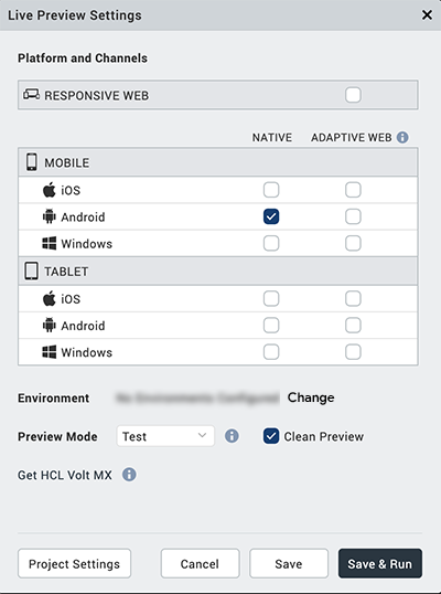

  1. In Iris, from the main menu, navigate to Build > Live Preview Settings.
    The Live Preview Settings window appears.
  2. Select the platforms and channels for which you want to build the application.
  3. From the Preview Mode drop-down list, select the Test mode.
  4. Click Save and Run.

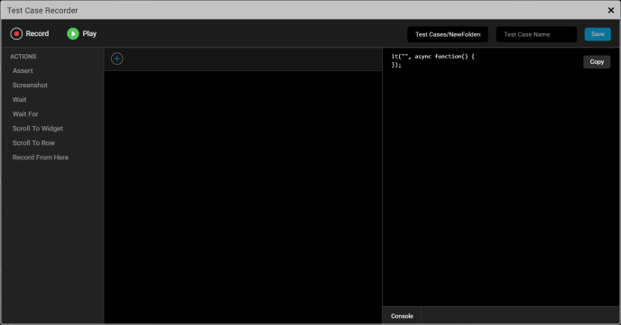

  6. Expand the required < channel >, right-click on Test Cases or any of the sub folders and select Create a Test Case.
    The Test Case Recorder window appears.
    When you minimize the Test Case Recorder window, a View option appears in the Test tab on the lower pane of Iris. You can click View to re-open the window that you have minimized.
    When you minimize the Test Case Recorder window while playing a test case, a progress bar appears in the Test tab indicating the progress of test case being played. Once the test case is played completely, a toast message appears on the lower-right of Iris.
    After minimizing the Test Case Recorder window, a few options such as Edit, Delete, and Rename* are disabled for the test files. Also, the options to create a new Test Case, Test Suite, or Test Plan are disabled.

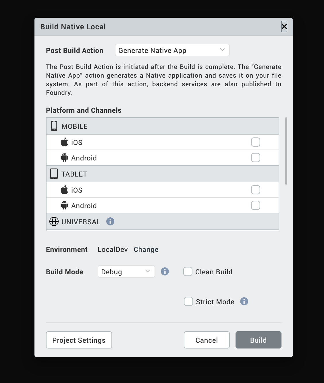

  1. In Iris, from the main menu, navigate to Build > Build Native Local.
    The Build Native Local window appears.
    Note: The Build Native Local feature enables you to build an app on the local machine. To know more about the feature, click here. If you want to build the app on the cloud, select Build and Publish Native.
  3. From the Post Build Action drop-down menu, select Run on my Device.
  4. From the Build Mode drop-down list, select the Test mode.
  5. Click Build. The build generation begins. You can check the status of your build in the Build tab. If there are any errors, they appear in the Build tab.

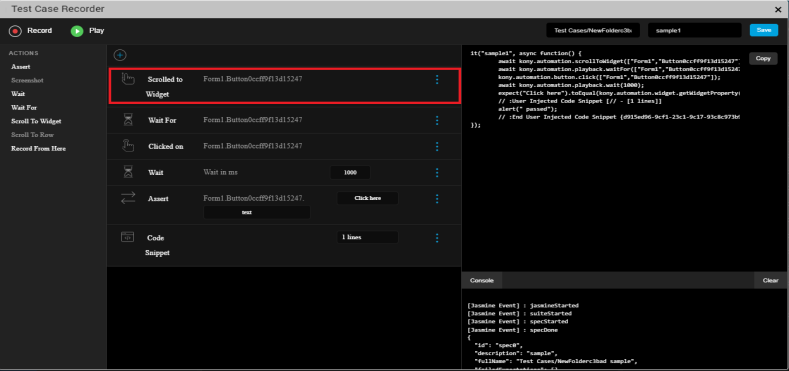

  3. Select any user activity that is recorded.
  4. Click the add icon to add any of the following actions to the top of the canvas:
    • Insert Code Snippet: Enter the code and description and click Save.
    • Wait: Delays the selected action by specified period of time.
    • Fetch Widget Path: This action enables you to get the path of a widget in the application by selecting the widget. The application can be launched in the device, web browser, or in the Live Preview window. To get the path of any widget in the Test Recorder window, follow these steps.
      1. From the top-left of the Test Recorder window, click Record.
      2. From the top of the canvas, click the add icon, and select Fetch Widget Path .
      3. Select the required widget in the application.
        A new node with the path of the widget is added to the canvas of the Test Recorder window.
      4. To complete the Fetch Widget Path action, select any of the following actions from the left of the Test Recorder window as per your requirement: Wait For, Assert, and Scroll to Widget.
      Note: In iOS platform, Fetch Widget Path action is not supported for FlexForm, FlexScrollContainer, and FlexContainer widgets.
      Note: In Android platform, you cannot perform any scrolling actions after the Fetch Widget Path action is performed. You must perform the scrolling action before the Fetch Widget Path action.
  5. From the Actions panel, select any of the following actions for the corresponding user activity.

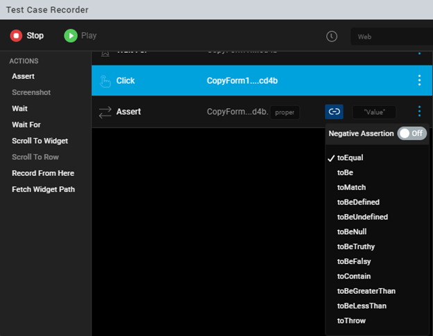

    • Assert: Validates the value of a specified property for any widget.
    In Volt MX Iris V9 SP 2 GA, when you add an assert action in the Test Case Recorder window, you can view the link icon in the assert statement. Click the icon to view a list of options that you can use to customize the type of assertion to be applied on the specified property of the widget.
    This feature allows you to add custom matches for any test case that improves the test automation.
    Prior to the V9 SP2 release, the default matcher was configured as expect(a).toEqual(b) and if a developer wanted to add a new match, they had to add the code manually.
    The following types of Assertion options are available:
    Important: When you toggle the button next to the Negative Assertion option to On, all the Assertion options turn into Negations.
    • The toBe matcher compares with ===.
    • The toEqual matcher works for simple literals and variables.
    • The toMatch matcher is for regular expression.
    • The toBeDefined matcher compares against an undefined value.
    • The toBeUndefined matcher compares against undefined.
    • The toBeNull matcher compares against a null value.
    • The toBeTruthy matcher performs boolean casting testing.
    • The toBeFalsy matcher performs boolean casting testing.
    • The toContain matcher finds an item in an Array and a substring.
    • The toBeLessThan matcher performs mathematical comparisons.
    • The toBeGreaterThan matcher performs mathematical comparisons.
    • The toThrow matcher tests whether a function throws an exception.

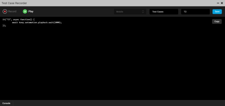

To play the test case, use the Open in Test Recorder option for the same test case. The following Test Case Recorder window appears.
From the Test Case Recorder window, you can click Play to run the test case that has been edited manually.
You can also rename the test case, if required. The Record option is disabled by default when you edit manually.

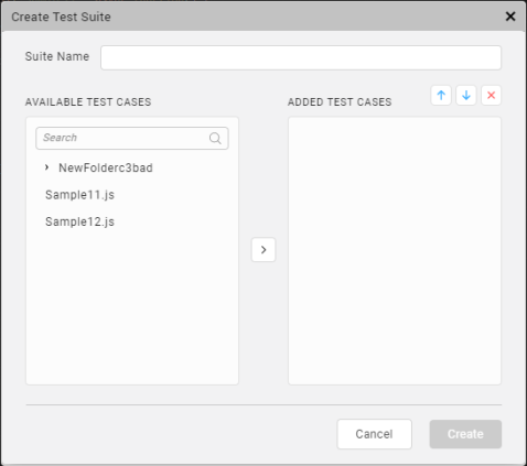

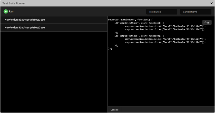

Test Suite
Test Suite is a collection of several test cases. Create a test suite to group various test cases and run them in an order in which they are grouped.

Follow these steps to create a test suite:
  1. From the Project explorer, go to Test Resources > Jasmine.
  2. Expand any channel, such as Mobile, and go to Test Suites.
  3. Right-click on Test Suites and select Create a Test Suite. The Create Test Suite window appears.
  4. From the available test cases, select the test cases that you want to add to the test suite.
  5. Drag and drop the selected test cases in the ADDED TEST CASES pane.
    By using the up and down icons, you can change the sequence to the order in which you want the test cases to run.
    If you want to remove a test case from the test suite, select the test case and click the delete icon.
  6. Type a name in the Suite Name box and click Create.
    A new < testSuite.js > file is created in the Test Suites folder.
You have successfully created a test suite. To edit the test suite, navigate to the Project explorer, right-click on the test suite and select Edit Test Suite. Once the modifications are done, click Save.

After creating a test suite, run the test suite to play the all the test cases and test the application.
Follow these steps to run a test suite:
  1. From the Project explorer, navigate to Test Resources > Jasmine.
  2. Expand any < channel > and go to Test Suites.
  3. Select a < testSuite.js > file.
  4. Right-click on the file and select Run.
    The VoltMX Iris Test Suite Runner window appears.
    The left pane of the window displays all the test cases in the specified test suite.
    The right pane of the window displays the code in the order of the test cases. On selecting a test case from the left pane, the corresponding code on the right pane is highlighted.
    The Console tab displays the results of the test.
    When you minimize the Test Suite Runner window, a View option appears in the Test tab on the lower pane of Iris. You can click View to re-open the window that you have minimized.
    When you minimize the Test Suite Runner window while running a test suite, a progress bar appears in the Test tab indicating the progress of test suite that is running. Once the test suite is run completely, a toast message appears on the lower-right of Iris.
    After minimizing the Test Suite Runner window, a few options such as Run, Edit, Delete, and Rename* are disabled for the test files. Also, the options to create a new Test Case, Test Suite, or Test Plan are disabled.
    Note: If you want to play all the test cases in the test suite, click Run on the upper-left corner of the Test Suite Runner window.

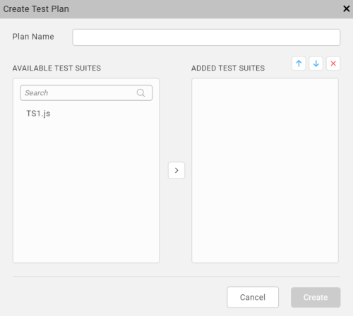

Create a Test Plan
You can create a new test plan from the Project explorer. Once a test pan is created, a corresponding JavaScript file is created.
To create a new test plan, follow these steps:
  1. From the Project Explorer, go to Test Resources > Jasmine.
  2. Expand the channel where you created the test cases and test suites earlier.
  3. Right-click on Test Plans and click Create a Test Plan.
    The Create Test Plan window appears.
  4. From the available test suites, select the test suites that you want to add to the test plan.
  5. Drag and drop the selected test suites under ADDED TEST SUITES.
    By using the up and down arrow icons, you can change the sequence to the order in which you want the test suites to run.
    If you want to remove a test suite from the test plan, select the test suite and click the delete icon.
  6. Type a name in the Plan Name box and click Create.
    The < PlanName.js > file is created in the Test Plans folder.
  7. If you want to edit the test plan that you have created, right-click on the file and select Edit Test Plan.
    Click Save after the modifications are made.

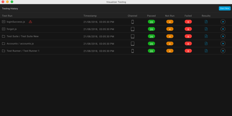

View the Testing History

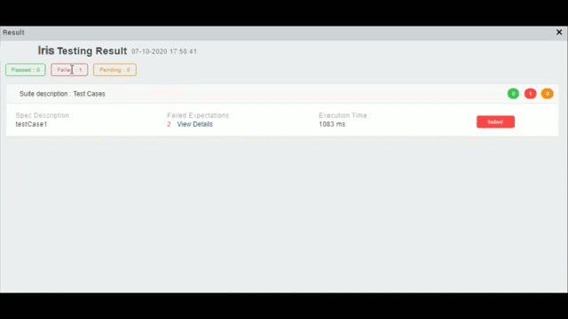

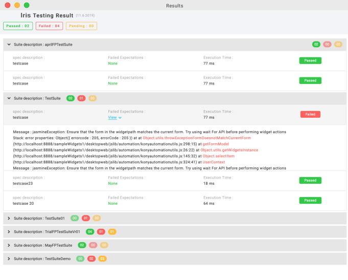

The Dashboard displays the information about the last five test results of the application. The latest tests that have executed can be test cases or test suites.
The Dashboard window displays the following details for each of the five tests that have been executed:
  • Time stamp: The time at which the test was executed.
  • Channel: The channel on which you ran a test case or test suite.
  • Passed: The number of the test cases that ran successfully.
  • Not Run: The number of ignored test cases that the user do not want to run.
  • Failed: The number of test cases that failed due to errors.
  • Results: Click on the file to view the test results of each test suite.
    The number of passed test cases, failed test cases, and pending test cases are displayed across each test suite. Furthermore, you can expand the test result of each test suite to view more information such as: * Spec description: Displays the name of the test case. * Failed exceptions: Displays the location of errors in the test case along with the file location.
    In Volt MX Iris V9 SP 2 , in the Results window, when you click View Details option, details of failed expectations appear. Details include the name of the test case, code line number, column number, jasmine message, stack trace, and the associated screen-shot of the failure. When you click on the screen shot, the image maximizes.
    • Execution Time: Displays the time taken by a test case for completing the execution.

  1. From the main menu, click Build > Live Preview Settings.
  2. In the Platform and Channels section, select the appropriate checkboxes.
    For the Preview Mode, select Test.
  3. Click Save and Run.
    The app launches on the device. In case of Inline preview, the Iris Preview window appears.

  5. In the upper-right corner of the window, click Start New.
  6. From the Iris Preview window, re-launch the application.
    The device connects successfully.
  7. On the upper right corner of the Test Case Recorder window, select the channel for which you want to create the test case.
  8. On the upper-left corner of the Test Case Recorder window, select Record to start recording a test script.
    After the recording starts, a stop option appears.
  9. To discontinue the recording, click Stop.
  10. On the upper-right corner of the window, type a name for the test case and click Save.
  11. To play the recorded script, re-launch the app and click Play.
    The recorded script plays in the Iris Preview window.
    You can view the result of the test case in the Console tab.
