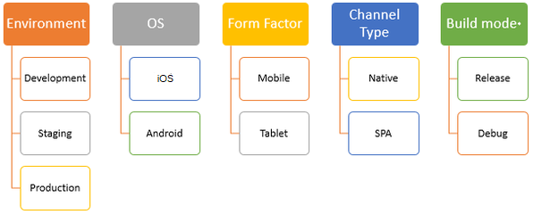

The buildIrisApp job initiates the Iris project build stage which depends on (but is not limited to) the following parameters:
  • The Volt MX Foundry Environment is used to build a Iris app and then publishing it. You can use different Foundry environments to split the release stages into three phases: Development, Staging, and Production.
    • Developers or testers use a development environment to test the features that are developed into a particular development branch
    • Developers or testers use a staging environment to test features that are developed in a sprint or a release
    • An administrator uses a production environment to deploy the features that are developed in a sprint or a release
  • The Operating System (OS) can be iOS or Android.
  • The Form Factor can be Mobile or a Tablet. Desktop is not supported.
  • The Channel type can be a native app or a web app
    • A Native build is generated by Xcode (for Apple) or by the Android SDK
    • A Single Page Application (SPA) build generates a WAR file that can be used to deploy the project as a web app
  • The Build mode* specifies the type of binaries that are produced after a build: release or debug. The debug mode is used during the development phase to test the builds. The Release mode is used to build the binaries for production. The binaries that are built in the Release mode must be signed accordingly.

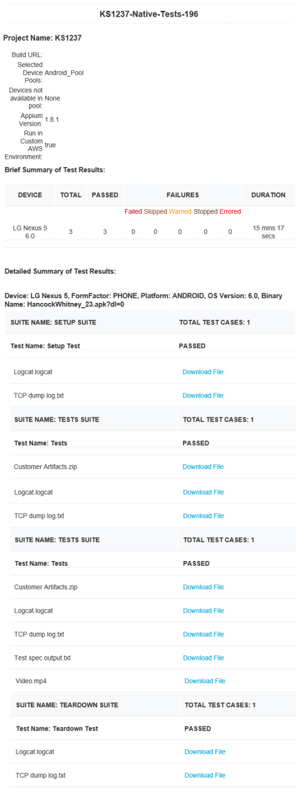

AWS Custom Environment Run
  • Logcat.logcat
  • TCP dump log.txt
  • Test spec output.txt
  • Video.mp4
  • Customer Artifacts.zip
The Customer Artifacts.zip file contains the test output contents. The Test spec output.txt file contains the AWS console output of the tests run on the Custom Environment.
