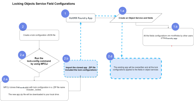

How Locking Fields Works
After you create your data model for an object service in an app in Foundry Console, the fields of the service can be modified when the app is accessed by other Foundry users. If you want to make any of these fields read-only, you can lock these fields by using the lock-config command of MFCLI. This command must include a valid lockconfig.json file. A lockconfig.json file must be defined with the required fields of an object that need to be locked. After you run the lock-config command successfully, the Foundry Console downloads a zip file to your original app file location. The name of the locked app file name is <OriginalFoundryAppName>_locked.zip. The new zip file contains the locked fields of objects.
Use the locked zip file to import the locked fields into your existing app. When you import the locked zip file, the existing app is overwritten. The locked fields of your objects are categorized as the BASE FIELDS and the rest of the fields in the objects are categorized as CUSTOM FIELDS.
Refer to the following diagram that explains how to lock fields of object services as read-only (2.d) fields:
