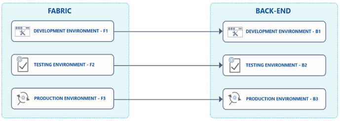

With service configurations, you can redefine the endpoints to which your Foundry application connects per environment.
Consider a scenario in which your app uses different back-end environments for different Foundry environments. For example: If your app runs on Foundry environment F1, it must connect to the back-end environment B1; and if the app runs on Foundry environment F2, it must connect to back-end environment B2.
This is useful because you typically want a development Foundry environment to connect to a development back-end environment, and so on for higher environments such as testing, UAT, or Production.
To avoid manually reconfiguring the endpoints every time you publish the app, you can create a service profile file, which contains the set of different back-end endpoints for a specific Foundry environment. You can then import the service profile when you publish the app. For example: You can import the service configuration for Foundry environment F3 to configure the endpoints for back-end environment B3.

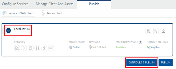

  1. In the Publish > Service & Web Client page, select the required environment.
  2. Click CONFIGURE & PUBLISH.

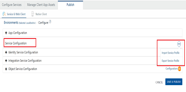

  3. In Service Configuration, click the More Options button. The Import Service Profile and Export Service Profile options are shown in the list.
    • To export the service profile, click the Export Service Profile option. The service profile details are downloaded in a JSON file.
      Note: The Export Service Profile option downloads the format version 2.0 with level as Delta. This reconfig file is in simplified JSON file structure.
