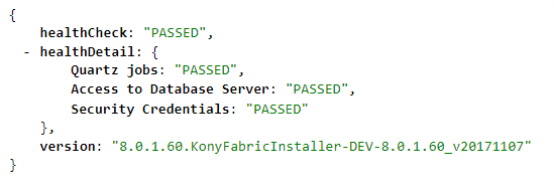

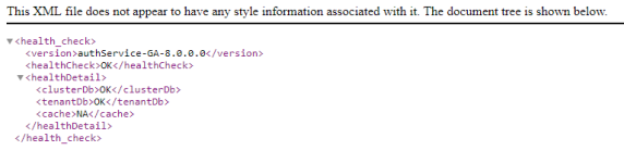

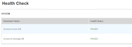

Test the Setup
Use the following Healthcheck URLs post-deployment to check the status of a Volt MX Foundry component on each node:
  • For Volt MX Foundry console: http://:/mfconsole/health_check/all
  • For Middleware: http://:/services/healthcheck
  • For Auth Service: http://:/authService/v1/manage/checkhealth
  • For Sync: http://:/syncconsole/healthcheck
  • For Messaging: http://::53409/vpns/service/healthcheck/json

  • Use the Healthcheck URLs mentioned at Test the Setup post-deployment to check the status of a Volt MX Foundry component on each node.
  • Ensure that all health-checks are passed.
