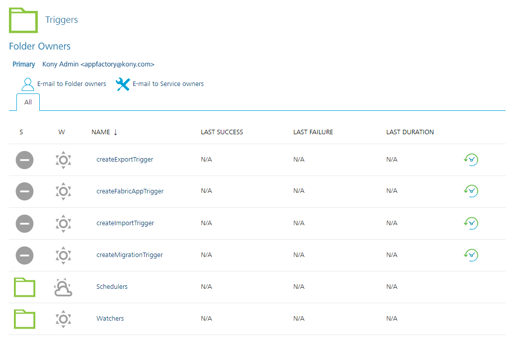

Every project contains a sub-folder called Triggers in the Foundry folder. The Triggers folder contains a job called createFoundryAppTrigger (to create auto-triggered jobs), and two sub-folders called watchers and schedulers (to store the created jobs).

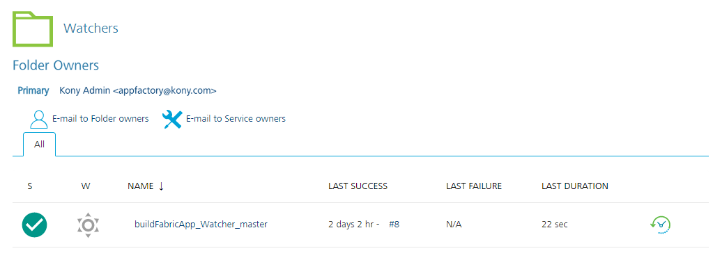

Jobs that are triggered by a push to the SCM are stored in the watchers folder. Every Watcher includes the branch in the name of Job to simplify searches.
