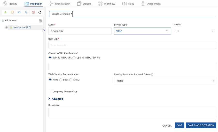

Configure SOAP End-point Adapter
To configure a SOAP service in Integration service definition tab, follow these steps:
  1. In the Name field, provide a unique name for your service.
  2. From the Service Type list, select SOAP.
    Note: XML is selected, by default.
  3. Provide the following details to create a SOAP service.
Fields Description
Version Specify the version number for the service.
Base URL Type the URL.
Identity Service for Backend Token Select the Identity service associated with your app if this service needs backend token like access_token from that Identity service to access the backend server.

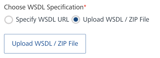

Select the option to specify the WSDL (Web Service Definition Language) URL or upload the WSDL / ZIP file.e.
Click Specify WSDL URL and type the WSDL URL.
Important: In case, if you are unable to read metadata from an integration service (for example, SOAP) that is protected by an SSL certificate, enable the integration service by following one of the ways:- Download the WSDL file from the https WSDL URL and upload the WSDL file on Volt MX Foundry console. - Importing the SSL into your cacerts in your Volt MX Foundry install location. For more details, refer to FAQs.Click Upload WSDL / ZIP File and follow these steps to upload your WSDL / ZIP file. The ZIP file that refers to local XSD files.Click Upload WSDL* / ZIP File button. Navigate to the WSDL or ZIP file from your local system and click *Open.
The selected WSDL or ZIP file gets uploaded.
Select one of the following modes:
None: Select this option if you do not want to provide any authentication for the service. Basic: Provide User ID and Password if the external Web service requires a form or basic authentication. NTLM: Your service follows the NT LAN Manager authentication process. You are required to provide the User ID, Password, NTLM Host, and NTLM Domain.
  1. For additional configuration of your service definition, provide the following details in the Advanced section.
Field Description
Custom code To specify a JAR associated to the service, select one from the Select Existing JAR drop-down menu or click Upload New to add a new JAR file. Make sure that you upload a custom JAR file that is built on the same JDK version used for installing Volt MX Foundry Integration. You can download the uploaded jars to your local system.
API Throttling If you want to use API throttling in Volt MX Foundry Console, to limit the number of request calls within a minute. do the following:
In the Total Rate Limit text box, enter a required value. This will limit the total number of requests processed by this API.In the Rate Limit Per IP field, enter a required value. With this value, you can limit the number of IP address requests configured in your Volt MX Foundry console in terms of Per IP Rate Limit.
To override throttling from Volt MX Foundry App Services Console, refer to Override API Throttling Configuration.
URL Provider Class Enter the qualified name of the URL Provider Class. For more information, refer URL Provider Support for XML, JSON, SOAP, and API Proxy.
Note: All options in the Advanced section are optional.
  1. Enter the Description for the service.
  2. Click SAVE to save your service definition.
