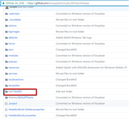

Native Prerequisites
  • Make sure that the Iris project contains the Appium test files at the following location:
    <Project-Root>/test/TestNG/

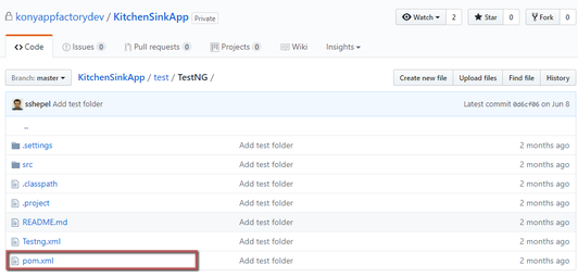

  • Tests must be compiled by using a Maven configuration file (pom.xml) that is available in the Tests root folder (<Project-Root>/test/TestNG)

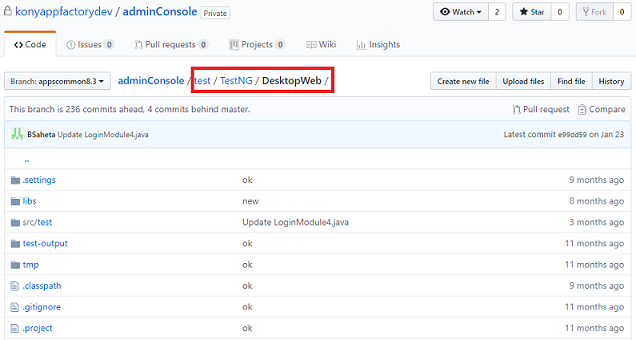

Desktop Web Prerequisites
  • Make sure that the Iris project contains the Selenium test files at the following location:
    <Project-Root>/test/TestNG/DesktopWeb/

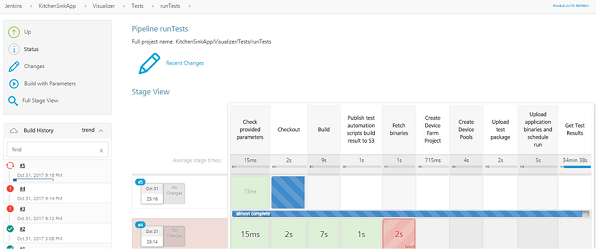

Building and running a test
Important:
  • To run tests that are independent from the build process, you need a Binary URL that is public (open) and accessible on the internet. For example, a URL to an S3 bucket from the email notification that is sent by the buildIrisApp job.
  • If you do not have a public Binary URL, HCL recommends that you run the tests as part of the build process.
To build and run a test, follow these steps:

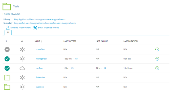

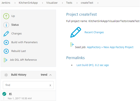

  1. From the Iris folder of your project, navigate to the Tests sub-folder.
  2. For the runTest job, click the Build with Parameters icon on the right side of the row.
    Alternatively, select the runTest job, and then from the left panel of the details page, select Build with Parameters.

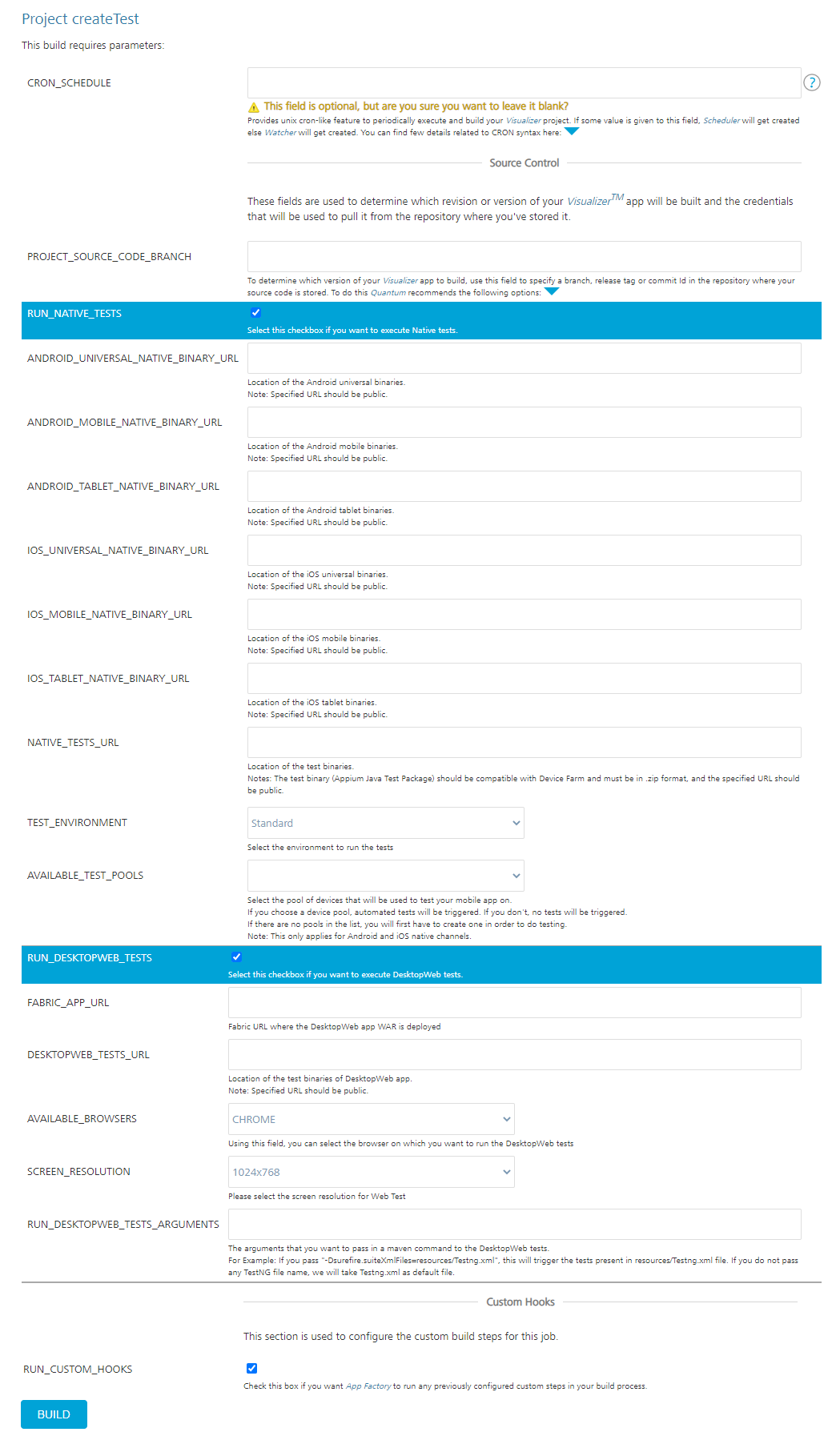

  3. Configure the build parameters for the runTest job. For more information about the parameters, refer to the following sections.
Source Control
<table style="width: 80%;mc-table-style: url('Resources/TableStyles/Basic.css');" class="TableStyle-Basic" cellspacing="0"><colgroup><col class="TableStyle-Basic-Column-Column1" style="width: 30%;"><col class="TableStyle-Basic-Column-Column1" style="width: 50%;"></colgroup><tbody><tr class="TableStyle-Basic-Body-Body1"><th class="TableStyle-Basic-BodyE-Column1-Body1">Parameter</th><th class="TableStyle-Basic-BodyD-Column1-Body1">Description</th></tr><tr class="TableStyle-Basic-Body-Body1"><td class="TableStyle-Basic-BodyE-Column1-Body1">PROJECT_SOURCE_CODE_BRANCH</td><td class="TableStyle-Basic-BodyD-Column1-Body1">Specifies the branch, release tag, or the commit ID of the repository that contains the test files.The tests must be placed at the following location:<code class="file_names"><Repository-Root>/<Project-Root>/test/testNG/</code>The <b><Repository_Root></b> and <b><Project-Root></b> must be configured while <a href="Setup.html#Iris" target="_blank">creating the Iris project in App Factory</a>.</td></tr><tr class="TableStyle-Basic-Body-Body1"><td class="TableStyle-Basic-BodyE-Column1-Body1">RUN_NATIVE_TESTS</td><td class="TableStyle-Basic-BodyD-Column1-Body1">Specifies whether App Factory must run tests for the Native platform.If you enable this parameter, the console displays additional parameters for Native tests. For more information, refer to <a href="#Build_Native" class="selected">Native build parameters</a>.</td></tr><tr class="TableStyle-Basic-Body-Body1"><td class="TableStyle-Basic-BodyB-Column1-Body1">RUN_DESKTOPWEB_TESTS</td><td class="TableStyle-Basic-BodyA-Column1-Body1">Specifies whether App Factory must run tests for the Desktop Web platform.If you enable this parameter, the console displays additional parameters for Desktop Web tests. For more information, refer to <a href="#Desktop_Build" class="selected">Desktop Web build parameters</a>.</td></tr></tbody></table>
<table style="mc-table-style: url('Resources/TableStyles/Basic.css');width: 90%;" class="TableStyle-Basic" cellspacing="0"><colgroup><col class="TableStyle-Basic-Column-Column1" style="width: 35%;"><col class="TableStyle-Basic-Column-Column1" style="width: 55%;"></colgroup><tbody><tr class="TableStyle-Basic-Body-Body1"><th class="TableStyle-Basic-BodyE-Column1-Body1">Parameter</th><th class="TableStyle-Basic-BodyD-Column1-Body1">Description</th></tr><tr class="TableStyle-Basic-Body-Body1"><td class="TableStyle-Basic-BodyE-Column1-Body1">ANDROID_UNIVERSAL_NATIVE_BINARY_URL</td><td class="TableStyle-Basic-BodyD-Column1-Body1">Specifies the URL of the Android universal binaries that are generated by a build job or generated locally.</td></tr><tr class="TableStyle-Basic-Body-Body1"><td class="TableStyle-Basic-BodyE-Column1-Body1">ANDROID_MOBILE_NATIVE_BINARY_URL</td><td class="TableStyle-Basic-BodyD-Column1-Body1">Specifies the URL of the Android Mobile binary that is generated by a build job or generated locally.</td></tr><tr class="TableStyle-Basic-Body-Body1"><td class="TableStyle-Basic-BodyE-Column1-Body1">ANDROID_TABLET_NATIVE_BINARY_URL</td><td class="TableStyle-Basic-BodyD-Column1-Body1">Specifies the URL of the Android Tablet binary that is generated by a build job or generated locally.</td></tr><tr class="TableStyle-Basic-Body-Body1"><td class="TableStyle-Basic-BodyE-Column1-Body1">IOS_UNIVERSAL_NATIVE_BINARY_URL</td><td class="TableStyle-Basic-BodyD-Column1-Body1">Specifies the URL of the iOS universal binaries that are generated by a build job or generated locally.</td></tr><tr class="TableStyle-Basic-Body-Body1"><td class="TableStyle-Basic-BodyE-Column1-Body1">IOS_MOBILE_NATIVE_BINARY_URL</td><td class="TableStyle-Basic-BodyD-Column1-Body1">Specifies the URL of the iPhone binary that is generated by a build job or generated locally.</td></tr><tr class="TableStyle-Basic-Body-Body1"><td class="TableStyle-Basic-BodyE-Column1-Body1">IOS_TABLET_NATIVE_BINARY_URL</td><td class="TableStyle-Basic-BodyD-Column1-Body1">Specifies the URL of the iPad binary that is generated by a build job or generated locally.</td></tr><tr class="TableStyle-Basic-Body-Body1"><td class="TableStyle-Basic-BodyE-Column1-Body1">NATIVE_TESTS_URL</td><td class="TableStyle-Basic-BodyD-Column1-Body1">Specifies the URL of the binaries for the compiled test project. If you provide Git parameters, you can skip this parameter.</td></tr><tr class="TableStyle-Basic-Body-Body1"><td class="TableStyle-Basic-BodyE-Column1-Body1">TEST_ENVIRONMENT</td><td class="TableStyle-Basic-BodyD-Column1-Body1">Specifies the environment on which the Device Farm runs the test. You can select a Standard Test Environment, or select a Custom Test Environment.For more information, refer to <a href="#Native" class="selected">Native Testing Environments</a>.If you select a Custom Test Environment, the console displays additional parameters. For more information, refer to Custom Test Environment parameters.</td></tr><tr class="TableStyle-Basic-Body-Body1"><td class="TableStyle-Basic-BodyB-Column1-Body1">AVAILABLE_TEST_POOLS</td><td class="TableStyle-Basic-BodyA-Column1-Body1">Specifies the device pool that must be used for the tests. If a device pool is empty, the build fails.For more information, refer to <a href="Configuring_Device_Pools.html" target="_blank">Configuring Device Pools</a>.</td></tr></tbody></table>
**Custom Test Environment parameters**
<table style="mc-table-style: url('Resources/TableStyles/Basic.css');width: 90%;" class="TableStyle-Basic" cellspacing="0"><colgroup><col class="TableStyle-Basic-Column-Column1" style="width: 35%;"><col class="TableStyle-Basic-Column-Column1" style="width: 55%;"></colgroup><tbody><tr class="TableStyle-Basic-Body-Body1"><th class="TableStyle-Basic-BodyE-Column1-Body1">Parameter</th><th class="TableStyle-Basic-BodyD-Column1-Body1">Description</th></tr><tr class="TableStyle-Basic-Body-Body1"><td class="TableStyle-Basic-BodyE-Column1-Body1">APPIUM_VERSION</td><td class="TableStyle-Basic-BodyD-Column1-Body1">Specifies the Appium version that is used to run the tests.</td></tr><tr class="TableStyle-Basic-Body-Body1"><td class="TableStyle-Basic-BodyB-Column1-Body1">TESTNG_FILES</td><td class="TableStyle-Basic-BodyA-Column1-Body1">Specifies the relative path of the TestNG.xml file in the test jar file, for example: <code class="file_names" style="font-size: 11pt;">appfactory/Testng.xml</code>.If the path is not specified, the root of the test jar file is taken as the default path.You can specify multiple file paths by using comma separated path values. For example:<code class="codefirst">voltmx/Testng.xml,voltmx/appfactory/Testng.xml,testng.xml</code><span class="autonumber"><span><b><i><span style="color: #0a9c4a;" class="mcFormatColor">Note: </span></i></b></span></span>If the specified TestNG file is not found in the source, the tests run independently similar to Standard Test Environment.</td></tr></tbody></table>
<table style="mc-table-style: url('Resources/TableStyles/Basic.css');width: 90%;" class="TableStyle-Basic" cellspacing="0"><colgroup><col class="TableStyle-Basic-Column-Column1" style="width: 35%;"><col class="TableStyle-Basic-Column-Column1" style="width: 55%;"></colgroup><tbody><tr class="TableStyle-Basic-Body-Body1"><th class="TableStyle-Basic-BodyE-Column1-Body1">Parameter</th><th class="TableStyle-Basic-BodyD-Column1-Body1">Description</th></tr><tr class="TableStyle-Basic-Body-Body1"><td class="TableStyle-Basic-BodyE-Column1-Body1">FOUNDRY_APP_URL</td><td class="TableStyle-Basic-BodyD-Column1-Body1">Specifies the URL of the Foundry app with which the Desktop Web WAR file is published.</td></tr><tr class="TableStyle-Basic-Body-Body1"><td class="TableStyle-Basic-BodyE-Column1-Body1">DESKTOPWEB_TESTS_URL</td><td class="TableStyle-Basic-BodyD-Column1-Body1">Specifies the URL of the Desktop Web binary that is generated by a build job or generated locally.</td></tr><tr class="TableStyle-Basic-Body-Body1"><td class="TableStyle-Basic-BodyE-Column1-Body1">AVAILABLE_BROWSERS</td><td class="TableStyle-Basic-BodyD-Column1-Body1">Specifies the browser on which you want to run the Desktop Web tests.</td></tr><tr class="TableStyle-Basic-Body-Body1"><td class="TableStyle-Basic-BodyE-Column1-Body1">SCREEN_RESOLUTIONS</td><td class="TableStyle-Basic-BodyD-Column1-Body1">Specifies the resolution at which the browser must launch and run the tests.</td></tr><tr class="TableStyle-Basic-Body-Body1"><td class="TableStyle-Basic-BodyB-Column1-Body1">RUN_DESKTOPWEB_TESTS_ARGUMENTS</td><td class="TableStyle-Basic-BodyA-Column1-Body1">Specifies additional arguments (parameters) that must be passed in the Maven command for the Desktop Web tests.For Example: If you pass <span style="font-family: monospace;">-Dsurefire.suiteXmlFiles=resources/Testng.xml</span>, the argument triggers the tests from the <span style="font-family: monospace;">resources/Testng.xml</span> file. If you do not pass the argument, <span style="font-family: monospace;">Testng.xml</span> is selected as a default file.</td></tr></tbody></table>
Custom Hooks
<table style="mc-table-style: url('Resources/TableStyles/Basic.css');width: 90%;" class="TableStyle-Basic" cellspacing="0"><colgroup><col class="TableStyle-Basic-Column-Column1" style="width: 35%;"><col class="TableStyle-Basic-Column-Column1" style="width: 55%;"></colgroup><tbody><tr class="TableStyle-Basic-Body-Body1"><th class="TableStyle-Basic-BodyE-Column1-Body1">Parameter</th><th class="TableStyle-Basic-BodyD-Column1-Body1">Description</th></tr><tr class="TableStyle-Basic-Body-Body1"><td class="TableStyle-Basic-BodyB-Column1-Body1">RUN_CUSTOM_HOOKS</td><td class="TableStyle-Basic-BodyA-Column1-Body1">Specifies whether Custom Hooks must be run in the after the tests are executed (the Post-Test stage). For more information, refer to <a href="CustomHooks.html" target="_blank">Custom Hooks</a>.</td></tr></tbody></table>

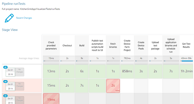

Standard Test Environment Run
The test run process consists of the following steps:
  1. Checkout of test project if GIT_BRANCH and GIT_CREDENTIALS are selected.
  2. Build the test project
  3. Publish test binaries at S3 based on the <S3 bucket>/<project name>/Tests/runTests/<build number>/KitchenSinkApp_TestApp.zip. For example: https://s3-eu-west-1.amazonaws.com/ voltmxdemo/KitchenSinkApp/Tests/runTests/4/KitchenSinkApp_TestApp.zip
  4. Fetch binaries to run them in AWS Device Farm
  5. Create a project in AWS Device Farm
  6. Create a device pool at AWS Device Farm, taking a device list selected from the configuration
  7. Upload test binaries to the Device Farm
  8. Upload application binaries to the Device Farm and schedule a run.
  9. Retrieve the test results.
Usually, the test run process takes around 20 minutes per each device in the device pool. Only the devices that are available in the Device Farm are used for testing. All unknown devices are skipped. If a particular application binary is missing, the devices for that channel are skipped from the test run.

  1. Place your test code in the root test folder that is available at the following locations:
    • For SP4 and higher versions, <project_root>/testresources/TestNG/.
    • For lower versions, <project_root>/test/TestNG.
    Note: Ensure that pom.xml is present in the required directory.

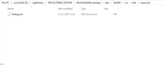

  2. Write the required TestNG XML and place it at <root_test_folder>/src/test/resources location.

  6. Extract the zip folder. To verify whether the TestNG XML file is present at the desired location (root, by default), extract the jar using xf command.
jar xf nameOfTheProjectFromPom-1.0-SNAPSHOT-tests.jar
Alternatively, you can use the **unzip** command to extract the contents of the jar.
unzip nameOfTheProjectFromPom-1.0-SNAPSHOT-tests.jar -d sampletestsjarcontents
If the XML is in the correct location, remove the target folder and check-in the code into a branch in Git. Now, you can run your tests on App Factory in the Custom Test Environment. For more information, please refer to AWS Documentation.

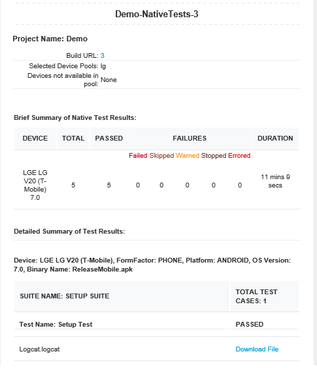

Native Test Results
When the project test build is complete and the test results are published at S3, e-mail notifications are sent to recipients:
On unsuccessful build for the tests run, the following e-mail is sent to the recipients:
In the final stage, the consolidated test run status is notified via e-mail. Refer the following screenshots for the sample email for consolidated status.
Sample email for Native tests
To download test data fetched from AWS Device Farm, click Download File link. Data is stored at S3 and available for review without time limitations.

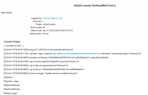

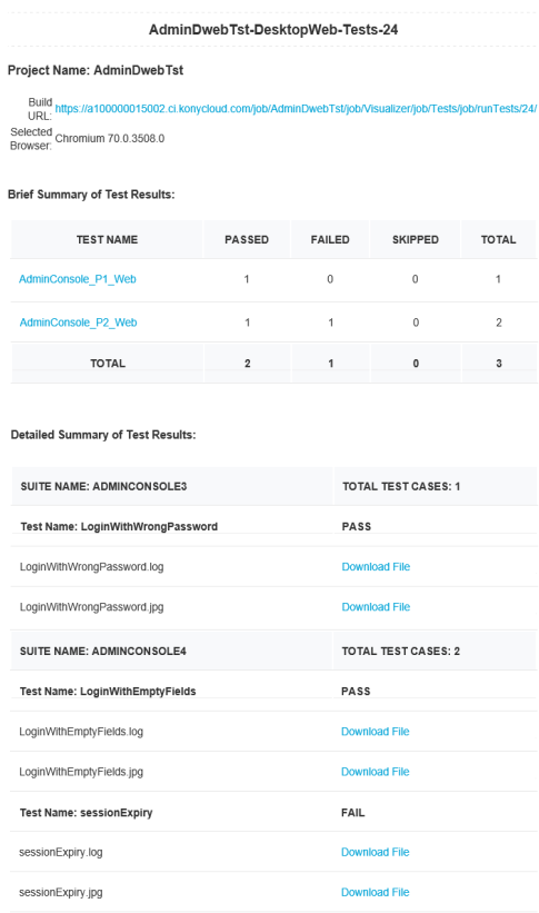

Desktop Web Test Results
Sample email for DesktopWeb tests
The summary of the test results are shown based on the tests executed on specified browser that includes passed, failed, skipped. Usually the tests are skipped when the driver initialization fails.
You can click the respective links in Brief Summary table to view the test summary.
To download the log files for each test case, click the respective Download File link. If you have any test failures, you can use these files to debug them.

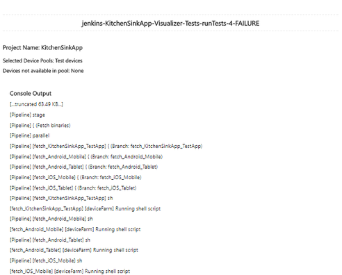

Troubleshooting Issues
The following errors can help you during troubleshooting runTests job fail:
  • Error: Jasmine Tests can only be executed when the app is built in Debug mode.
    Solution: Make sure that you have selected the build mode as debug when the app is built before running the tests.
  • Error: Please provide pool to test on.
    Solution: Make sure that you provide a value to AVAILABLE_TEST_POOLS parameter to run the native tests.
  • Error: Sorry, You can't run test for Android Universal binary along with Android Mobile/Tablet.
    Solution: The universal binary tests both the Mobile and Tablet binaries are based on the availability of the devices in the device pool. So it is not required to provide mobile/tablet binary when you give universal binary.
  • Error: Build parameter value is not valid URL!
    Solution: Make sure that the URL you provide for the following parameters is valid:
    • ANDROID_MOBILE_NATIVE_BINARY_URL
    • ANDROID_TABLET_NATIVE_BINARY_URL
    • IOS_MOBILE_NATIVE_BINARY_URL
    • IOS_TABLET_NATIVE_BINARY_URL
    • NATIVE_TESTS_URL
    • ANDROID_UNIVERSAL_NATIVE_BINARY_URL
    • DESKTOPWEB_TESTS_URL
    • IOS_UNIVERSAL_NATIVE_BINARY_URL

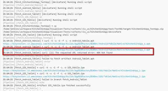

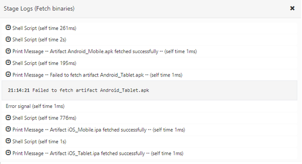

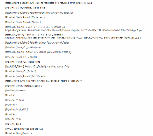

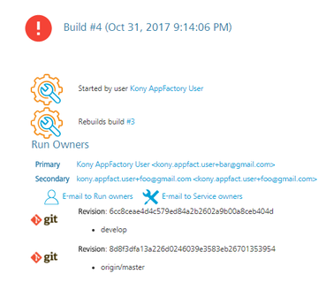

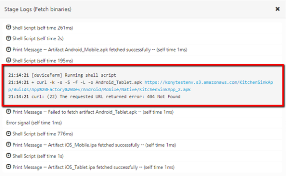

The builds that failed during the test can be tracked for the issues that caused the failure. For example, consider build #4 from the following screenshots of runTests job. To troubleshoot the issue, follow these steps.
  1. From your project folder, navigate to Iris > Tests.
  1. Select the runTests job, and then find the failed build.
    For example, find and click the link for build #4.

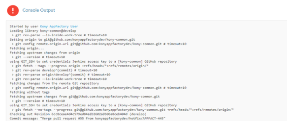

  1. From the details page of the failed build, select the Console Output on the left panel. The Console Output Log opens in the right pane.
  1. Scroll to find errors in the log that caused the build to fail. For example, you can trace an error that is related to invalid Android Tablet URL.
  1. Check if the ANDROID_TABLET_NATIVE_BINARY_URL parameter is valid.
Alternatively you can troubleshoot the issue from the stages of Manual Testing.
To troubleshoot the issue from the Stage View, follow these steps:
  1. From the Stage View, point to the failed stage, and then click Logs.
  2. From log messages in the Stage Logs window, identify the error message that corresponds to the failure of the build.
  1. Check whether the ANDROID_TABLET_NATIVE_BINARY_URL parameter is valid.

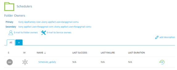

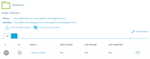

Auto Triggering Tests
Currently, there are two types of auto-triggered test jobs: scm-triggered (Watchers) and cron-triggered (Schedulers). Every project structure has folder called "Tests" in "Iris" sub-folder, that contains job for creation of auto-triggered jobs (createTrigger) and two sub-folders where created jobs are stored.
To setup auto-triggered job, perform the following steps:
  1. Go to Tests folder under project's root folder.
  2. Click on createTest job.
  1. Provide all required parameters (they are the same as in "Facade" job).
Important: Please note, that there is one additional parameter, which is called "CRON_SCHEDULE". If "CRON_SCHEDULE" parameter is given, then a cron-triggered job is created and stored in "Schedulers" sub-folder. If the parameter is not provided, a scm-triggered job is created and stored in "Watchers" sub-folder.
  1. Check that the createTest job is complete.
Important: Every Scheduler that is created, will have cron string in job's name to simplify the job search. Refer the image below.
Important: Every Watcher that is created contains the branch name in the job name to simplify job search.
