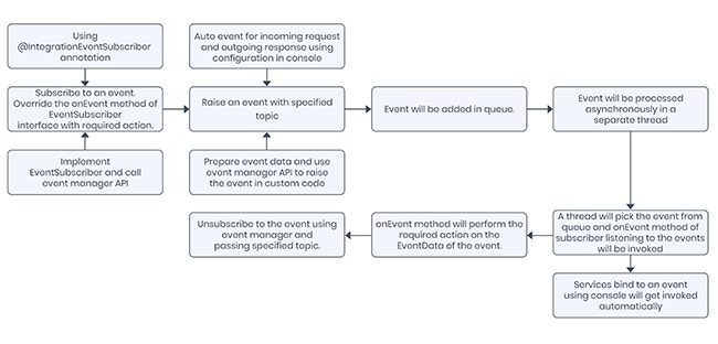

Server Events Processing
To process an event, you have to create a Subscriber. You can do it multiple ways like by using an Annotation or through custom java API or by binding a service using Volt MX Foundry Console to act as a subscriber. When an event is raised, the Subscriber listening to it will get the event data. There are two ways to raise an event which are through Auto Event or through Java API.
This event will be added to the memory queue in Volt MX Foundry. A separate thread runs in Volt MX Foundry which will pick the event from the queue and notify the subscribers listening to the specified topic.

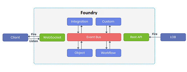

Terminology
Publisher - A service/custom code acts as a Publisher when it raises an event, when invoked. It sends the event data to the Event Bus for processing.
Subscriber - A service/custom code which is listening to a Topic is called a Subscriber. When an event is raised with that Topic, the Subscriber gets the related event data from Event Bus and processes the data.
Topic - Topics are classes or named logical channels to which Publisher can fire events. The Subscribers listening to a Topic will receive the related event data whenever an event is raised with the subscribed Topic.
Event - These are messages that contain event data. A Publisher raises an event and a Subscriber consumes the event data of an event.
Event Bus - It acts as a message broker which stores and routes the event data from Publishers to Subscribers.

Volt MX Foundry exposes a WebSocket end point to subscribe/unsubscribe/raise an event from an external client. Volt MX Foundry also exposed a HTTP end point to fire an event from any external client. . Once the event is created, the service or business logic will finish executing it. Another service or custom business logic should be configured to handle that event and perform the desired action and this work will be executed in a different process on the server asynchronously.
Note: HTTP end point doesn’t support subscribe and unsubscribe.

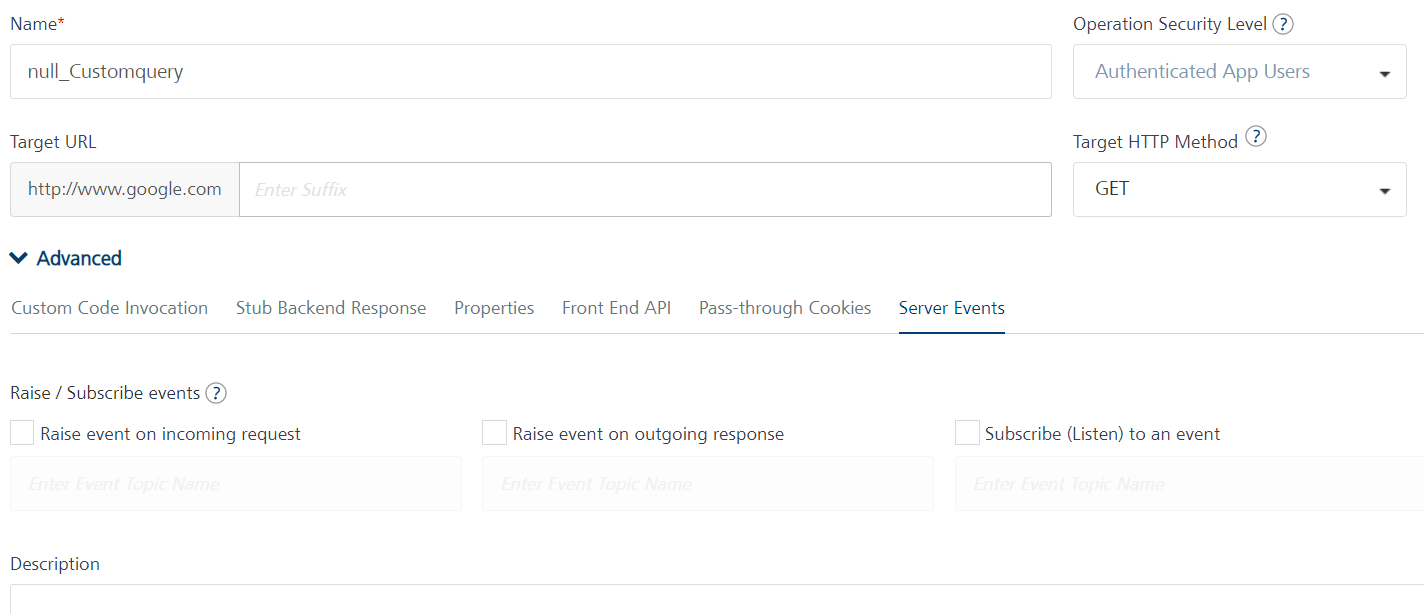

Create an Event from any Service
Create event on incoming request: To create the server-side event on the inbound request, in the Advanced settings tab of an operation, click the Server Events tab and then select the Raise event on incoming request checkbox. Provide the name of the event that describes the data or purpose of the event in the related Enter Event Topic Name box. The event will include the payload of the incoming request and default parameters like service id, operation id, object id, service version, headers, query parameters and more. You can provide semi-colon separated multiple event topic name.
Create event on outgoing response: To create the server-side event on the outbound response, in the Advanced settings tab of an operation, click the Server Events tab and then select the Create event on outgoing response checkbox. Provide the name of the event that describes the data or purpose of the event in the Enter Event Topic Name box. The event will include the payload of the outgoing response payload and default parameters like service id, operation id, object id, service version, headers, query parameters and more. You can provide semi-colon separated multiple event topic name.
Other services can listen to this event with the help of the given Topic name. Whenever this service is invoked, an Event is raised and subscribers to this Topic will get the relevant event data. You can also provide the Topic name in Parent topic and Child topic name format. When a service subscribes to the parent topic, the event data of all the child topics is sent to the subscriber. If you subscribe to any child topic, the event data related only to the subscribed child topic is sent to the subscriber. Use “/” as a separator for parent and child topic name.

Subscribe (Listen) to an event: To bind the service to an event of specified topic, in the Advanced settings tab of an operation, click the Server Events tab and then select the Subscribe (Listen) to an event checkbox. The service will be invoked whenever the subscribed event is triggered with the specified topic. Type the name of the event in the related Enter Event Topic Name box. You can provide semi-colon separated multiple event topic name.
