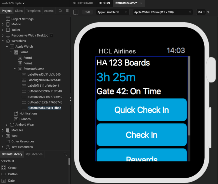

Adding a Watch App to your Volt MX Iris Project
In Volt MX Iris, you can add an Apple Watch app to your current project in just the same way that you would add a mobile, desktop, or tablet app to your project. In Iris's Project Explorer pane, you will see that in addition to the Mobile, Tablet, and Desktop channels, there is also a Watch channel displayed, as shown in the following illustration.
As you can see, the watch appears as an additional channel in the Project pane at the left of the illustration.
When you develop a mobile or tablet app, you do so by adding forms, widgets, and so forth to the appropriate channels. Likewise, you can build a watch app by adding forms and user interface objects to the Watch channel. The ability to interactively build both a Watch app and its associated iOS app interactively provides a simple, integrated, and intuitive method of creating an integrated phone and watch application.

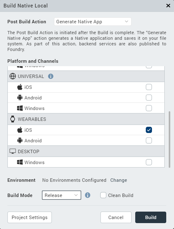

In addition, when you build your Watch app project, you also need to select Apple Watch apps in the build settings in Volt MX Iris, as shown below.

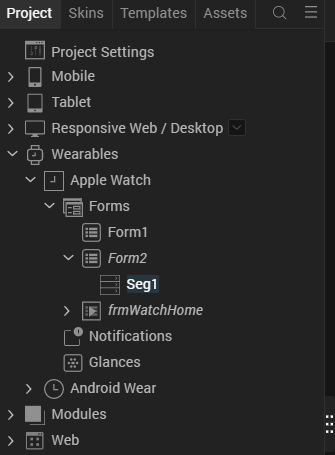

Watch Applications and Templates
To help you build the user interface for your app, Volt MX Wearables for Apple Watch supports templates, but only for SegmentedUI widgets. For example, the sample app shown in the figure below has a SegmentedUI widget on its frmSecond form. To use a template with the SegmentedUI widget, you first click on the Templates tab, as shown below.

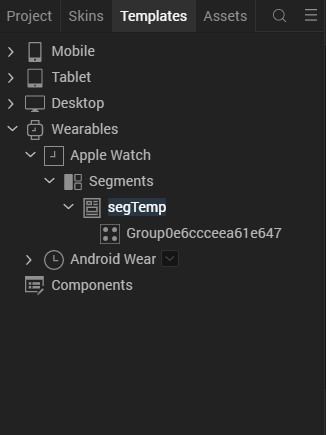

The Templates tab displays a list of all of the SegmentedUI widgets in your Watch app and enables you to add templates for each one. In this example, there is only one segment. It has a single template, and it's called segTemp, as the following figure illustrates.
In your templates, you can add Group widgets, buttons, images, and so forth. These are applied to segments and displayed in the UI when your app displays the segment.

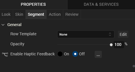

After you have your template looking the way you want it to, you can apply it to a segment by using the following steps.
  1. Click on the Project tab and then selecting the segment, as illustrated below.
  2. Go to the Properties pane and click the Segment tab, which is displayed in the following figure.
  3. Now select the template to apply to the segment from the Row Template list.

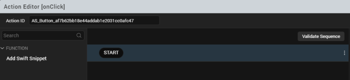

Adding actions enables you to build the business logic directly into your watch application. Watch app actions are typically event handlers that are triggered by user interactions with the UI. They can also be callbacks that are invoked by notifications. These are written in Swift. You add an action to a form or widget with the following steps.
  1. Click the Action tab in the Properties pane, as shown below.
  2. The Action tab displays the list of actions that the form or widget supports. Click the Edit button. Volt MX Iris displays a list of actions. Currently the only action that is supported is adding a Swift code snippet.

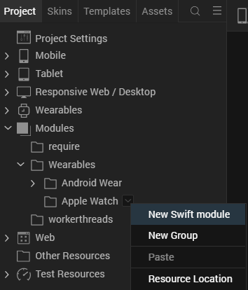

  3. Add Swift Snippet and add your code in the editor pane that appears.
If your snippet takes more than a few lines of code, you should consider putting it into a function an a Swift code module. Your app can then call the function from an action's code snippet. As with any other type of project, you can group your watch app's functions into modules and include them in your project. You create a Swift code module by clicking on Modules in the Project tree and then selecting New Swift module from the Watch node, as shown in the illustration below.
Note that you can put any valid code in your custom Swift modules that you need for you app. This includes classes, methods, constants, module global variables, or whatever else you may need to write your app.

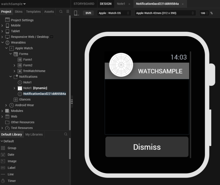

Creating Notifications on the Watch

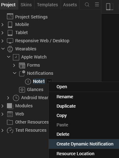

To create notifications, use the following steps.

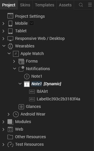

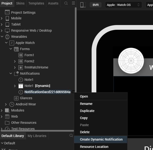

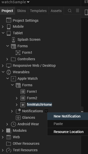

  1. Go to the Notifications node in the Volt MX Iris Project pane and select it.
  2. In the menu that appears, click New Notification. By default, this creates a static notification that cannot be interacted with. It can only display information and alerts.
  3. If you want to change the notification to a dynamic notification, which can have interactive elements such as buttons, select the notification that you created in step 2.

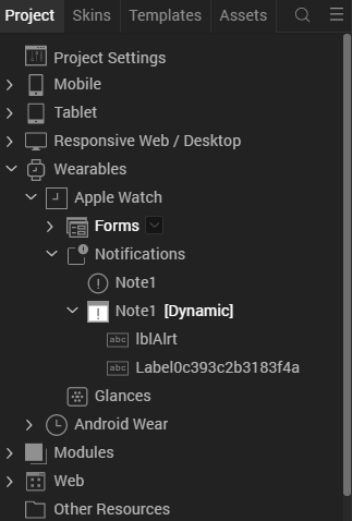

  4. Use the down arrow next to the name of the notification to pull down the context menu and click Create Dynamic Notification, as shown in the following illustration.
    Volt MX Iris adds a new node for the dynamic notification form to your project, as depicted in the illustration below.
When you create a dynamic notification form, the form can receive events. Therefore, you can add event handlers to the form by clicking the Action tab in the Properties pane, and then choosing the Edit button followed by Add Swift Snippet.

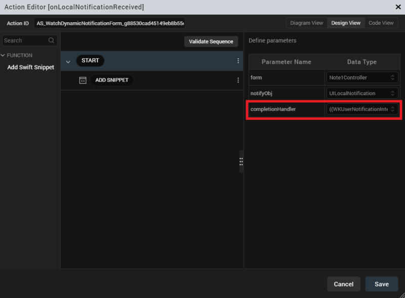

Many notification event handlers have a parameter named completionHandler, as indicated by the red circle in the figure below.
The completionHandler parameter contains a callback function that your event handler must call upon successful completion in order for the event to be handled properly. This call must be placed at the end of your event handler. Failure to invoke the completionHandler function results in undefined behavior.

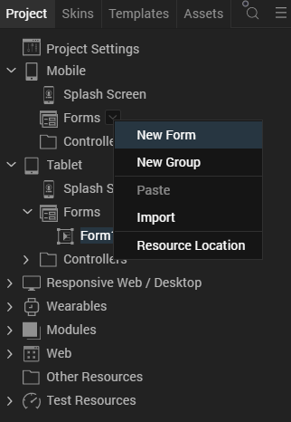

When you build your own watch app, it must be built in conjunction with an iOS app. So the first step is to create an iOS app in Iris. To do so, you add forms and code to the Mobile or Tablet nodes (or both) in the Volt MX Iris Project tree, as the following illustration shows.
You must ensure that your iOS app has at least one form or your app will not build.
If you need information on creating iOS mobile or tablet apps in Volt MX Iris, please see the VoltMX Widget Programmer's Guide and the VoltMX Iris API Developer's Guide.

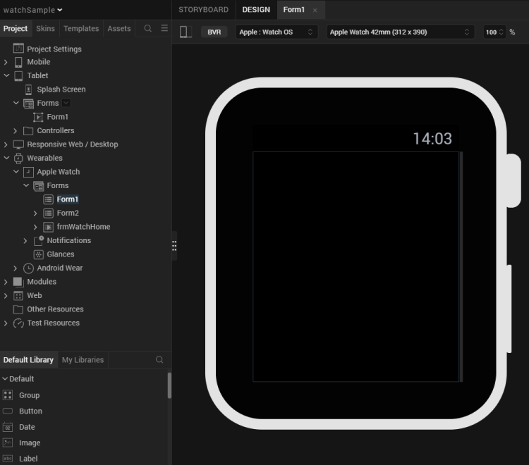

In the Volt MX Iris Project tree there is an additional platform (also called a channel) that is specifically for the watch. This channel, named Watch, contains three sub-items; one for forms, one for notifications, and one for glances, as shown below.
Adding Forms to the Sample Watch App
You can design a user interface for your watch app by dragging user interface objects and forms from the Widgets list in the lower left of the Iris screen and dropping them onto the Forms node, as illustrated below.
In this figure, you can see that the watch app has a single form, which is highlighted in the Project tree on the left. This is a container form that you can drag other widgets into.

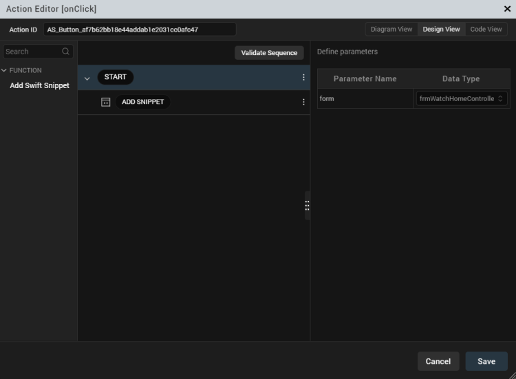

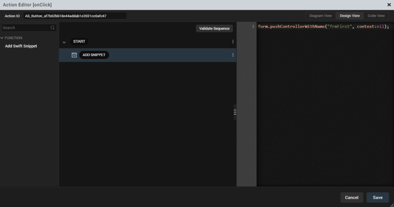

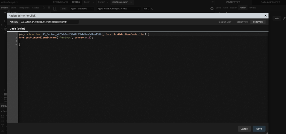

To add code for an action such as a Button widget's onClick event handler, use the following procdedure.
  1. Select the widget that you want to add the event handler to in the Project tree
  2. In the Properties pane, click the Action tab, as shown in the following figure.
  3. Click the Edit button in the Action pane of the Volt MX IrisProperties window, as shown in the previous illustration. When you do, you are presented with the option of adding a Swift code snippet, which is illustrated in the following figure.
  4. When you click Add Swift Snippet, Iris opens a window for you to define the parameters to your callback. This is shown in the figure below.
Notice in the preceding figure that Code Snippet has been added to the list of actions that respond to the button's onClick event. The onClick event for a button takes one parameter, called form, that contains the button's form. The form parameter is of type frmHomeController. When you build your app, Volt MX Iris turns all of this into Swift code for your event handler.
Form controllers are generally the targets of your app's actions. So Volt MX Iris creates a form controller for every form in your app. In the example above, Iris created the frmHomeController type for the button's form. As the illustration above indicates, when the button's onClick event handler is invoked, it is passed the form controller of the form that invoked the handler.
Other actions have more parameters than the Button widget's onClick event does. In such cases, the additional parameters are listed in the Define Parameters window.
To type code into your event handler, click the Code Snippet node, which is shown in the preceding illustration. Volt MX Iris responds by displaying a code editor window. Use the code editor window to enter the Swift code that you want in our event handler, as shown in the figure below.
In the preceding illustration, the event handler pushes a new form. By this action, the app navigates to a form called frmFirst. The Swift method call in the example above is simply a standard call to an Apple API function. In general, this is exactly how your app responds to events. That is, it uses actions and code snippets written in Swift to process input from the user.
Clicking the Generate button generates the Swift code for the event handler and pops it up in a window, as the following figure shows.
As you can see, Volt MX Iris generates the Button widget's handler for the onClick event using the parameters shown previously and the code snippet given above. When you build your project, Volt MX Iris stores the code for your actions, like the code for the onClick event shown in the preceding figure, in a file called SwiftCallbacksBridge.swift. If you need to debug the code in your actions, that's where you will find it.
Important: Many event handlers have a parameter named completionHandler. The completionHandler parameter contains a callback function that your event handler must call in order for the event to be handled properly. Failure to invoke the completionHandler function results in undefined behavior.

Adding Notifications to the Sample Watch App
You can add notification forms by clicking the notification in the Project tree and selecting the down arrow to pull down the context menu. From the context menu, choose New Notifications.
When you do, a notifications form will be added to your app. In this example, we will create a form for the fictional Volt MX Airlines that will display such information as flight schedules. The form appears below.
As with regular forms, you can drag user interface objects onto your notification form. Because they display primarily only static information, the palette of user interface objects that are available for notification forms is more limited than with regular forms. But you are able to add such user interface elements as images, labels, timers, and so on.
Dynamic notifications are also available if you need them. To add a dynamic notification, simply select a notification form, click on its down arrow, and select Create Dynamic Notification from the context menu.
Note: Each static notification in your app can have at most one dynamic notification associated with it.

Building the Sample Watch App
When you have finished adding widgets, actions, code snippets, and code modules to your app, you can build it by selecting Product from the Volt MX Iris main menu. Next, click Build. The Volt MX Iris Build Generation dialog box appears. In this dialog box, you must check iOS to build your Watch app's parent iOS app. You must also check Apple Watch to build your Watch app.
If the app builds correctly, Volt MX Iris outputs a .KAR file. The .KAR file contains the storyboards for your app, the code for the actions and other event handlers, and any code that you added in custom Swift modules.
To compile, debug, and run your app, you must next extract the .KAR file and load it into Xcode,With your app in Xcode, you are ready to compile and debug it. If you make changes to you app's code in Xcode, it is recommend that you copy the changes back into the code editor in Volt MX Iris.

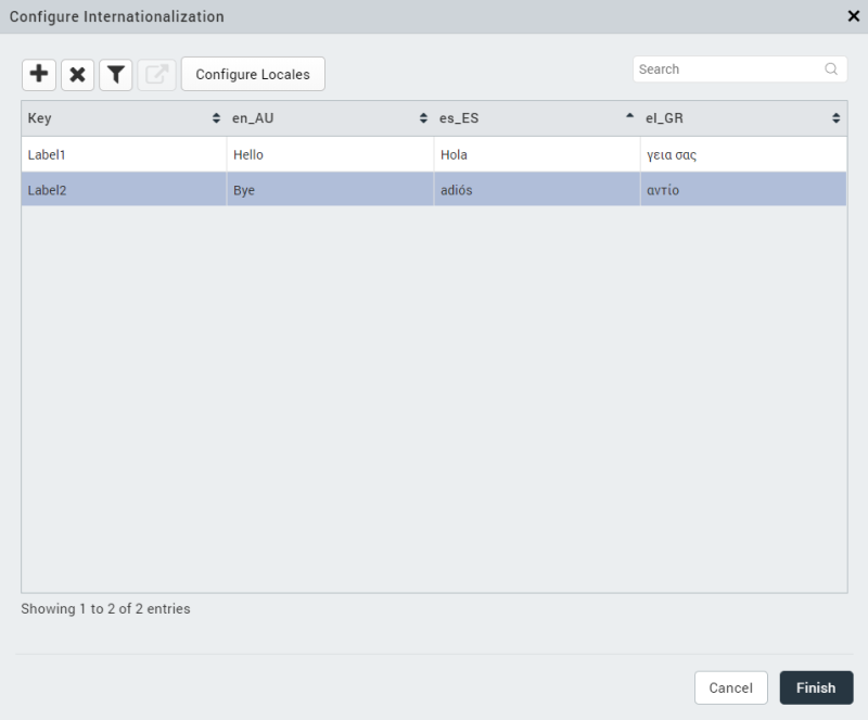

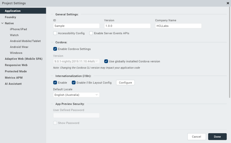

Apps for Volt MX Wearables can be customized for international use. In particular, you can define different strings that your app can use in its user interface for different locales. There are two ways to do this. First, you can define locale strings using Volt MX Iris. Second, you can add them to your app programmatically.
To define locale strings in Volt MX Iris, use the following steps.
  1. Select Edit from the main menu, and then choose Internationlization(i18n), as shown in the figure below.
  2. In the dialog box that appears, enter the keys for the text you want to localize, as shown in the following figure. Use the plus symbol at the right of the dialog box to select the languages that you want to localize for. For each language that you add, enter the localized string. Click Finish. The Configure Internationalization dialog box closes.
  3. Select the widget whose UI text you want to localize.
  4. In the Properties pane, select the key you create in step 2.
    For example, if you created a key called sKey, selected the locales, and entered the localized strings in step 2, you would then select a widget as instructed in step 3. The Properties pane for the label widget would look similar to the figure above. You would next select the key sKey in the Text i18n Key field. The result would be that, instead of the string "Label" being used for the Label widget's label when you app runs, your app would automatically use the localized strings if the app was being on a device is set to one of the locales you chose in step 2.
