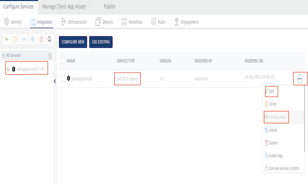

  • When an app that contains an SAP JCo service is migrated, the Service Type field is filled in SAP JCO Legacy in the integration tab of the Volt MX Foundry Console, shown below:
  • In the Volt MX Foundry Console, you can publish SAP JCo services like the other services supported in the Volt MX ecosystem.
  • You cannot edit SAP JCo services in the Volt MX Foundry Console. If you click the Settings cogwheel button for the service, the following app menu appears.
Note the following supported actions:
  • Edit and Sample code are not supported.
  • Clone, Unlink, Delete, Console Access Control, Export are supported. For details, refer to How to Use Actions on an Existing Integration Service
  • You cannot view operations of an SAP JCo service in the Volt MX Foundry Console.
  • An SAP JCo service is not clickable in Volt MX Foundry Console. You can only access operations for an SAP JCo service via the service definition XML directly. The Configure Operation button support is not available in the console.

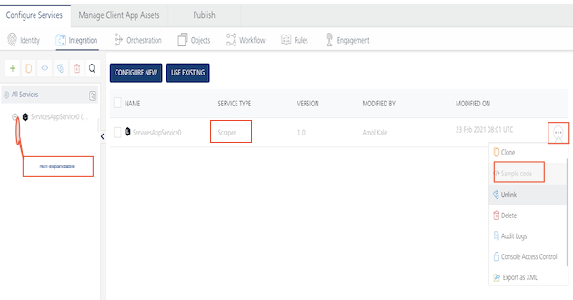

Limitations - Scraper Connector
Click here for more details
  • For each scraper service, there should be a corresponding dsl file.
  • When an app that contains a scraper service is migrated, then the Service Type field is filled in Scraper in the integration tab of Volt MX Foundry Console, shown below:
  • In Volt MX Foundry Console, you can publish Scraper services like the other services supported in the Volt MX ecosystem.

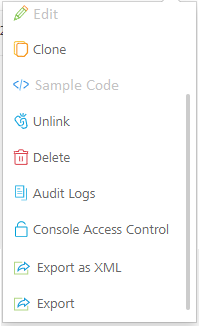

  • You cannot edit scraper services in Volt MX Foundry Console. If you click the Settings cogwheel button for the service, the following app menu appears.
  • Clone, Unlink, Delete, Audit Logs, Console Access Control, Export as XML, and Export are supported. For details, refer to How to Use Actions on an Existing Integration Service.
  • You cannot view operations of a scraper service in Volt MX Foundry Console.
  • Scraper service is not clickable in Volt MX Foundry Console. You can only access operations for a scraper service via the service definition XML directly. The Configure Operation button support is not available in the console.
  • You cannot create scraper services in Volt MX Foundry Console. To create scraper services, use a version of Volt MX Studio 6.5 or older.
  • For scraper services, in the integration service designer, the tree view on the left pane when expanded, it will not show any operations. The operations can only be accessed from within the XML file.
