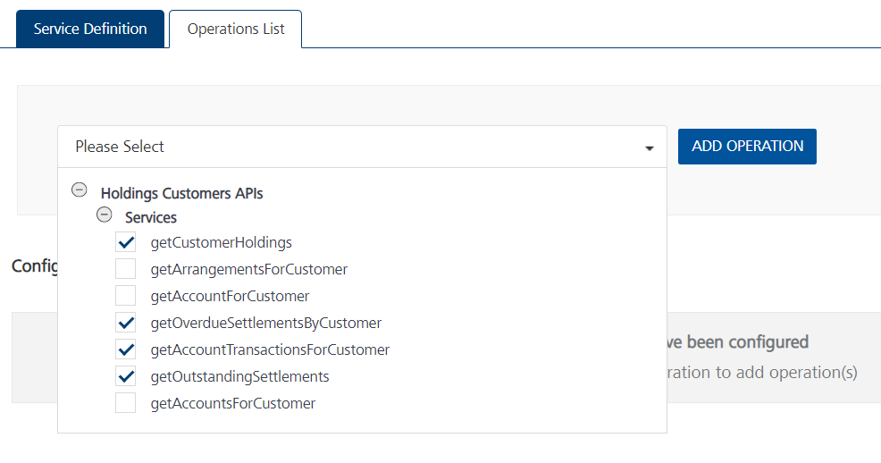

After you create a service, you can view the existing operations and also create operations on the Operations List tab. For an OpenAPI endpoint, the operations are the paths that are defined in the Swagger file, for example: addPet or updatePet.
To create an operation, follow these steps:
  1. From the Service Definition page, switch to the Operations List tab.
    Alternatively, click the plus (+) icon on the left pane, and then click Add New Operation.
  2. On the Operations List tab, from the drop-down list, select the operations that you want to add to the service.
    When you select a path (operation), all the corresponding fields of the operation are populated.

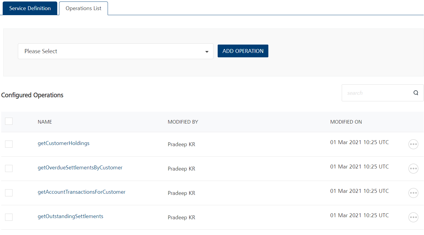

  3. After you select the operations, click ADD OPERATION. Foundry adds the selected operations to the Operations List tab.

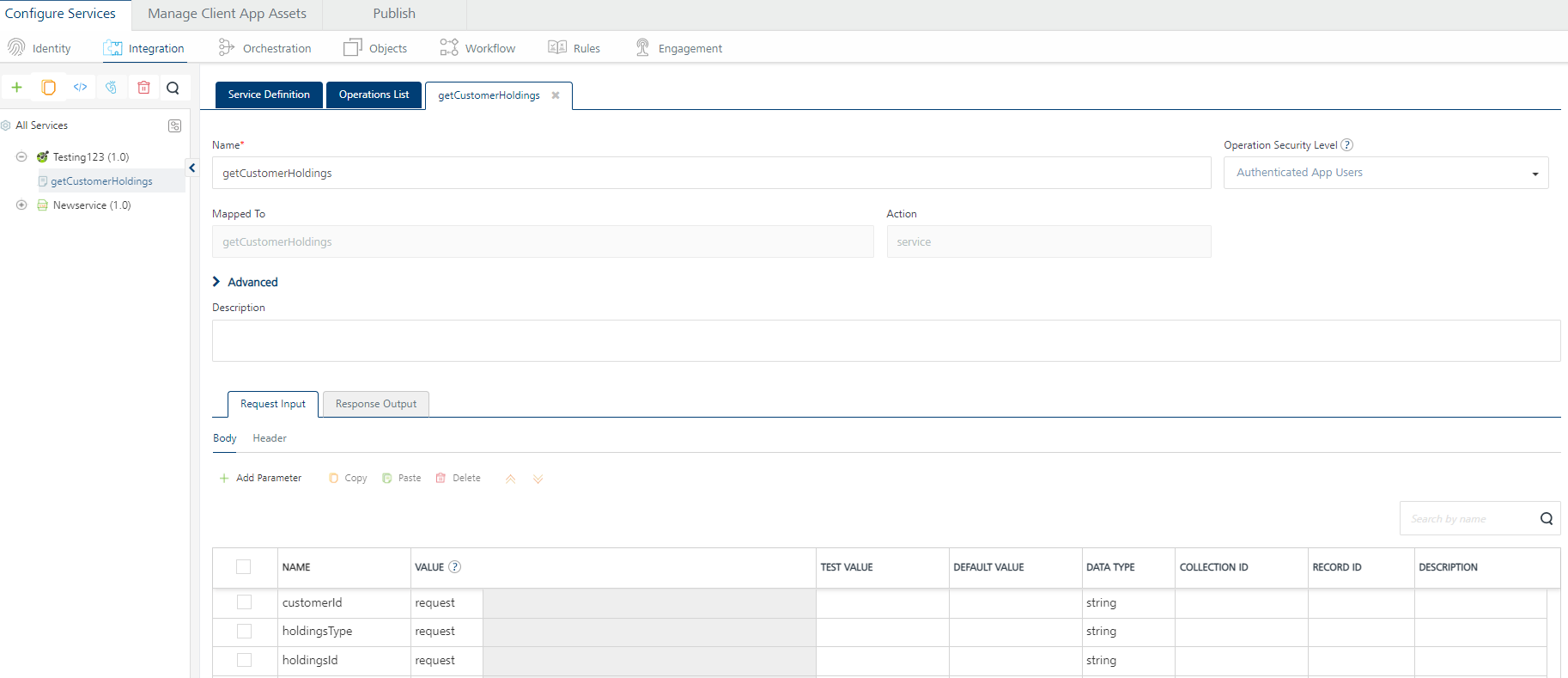

  4. Under Configured Operations, click an operation to view the details of the operation.
  5. Foundry displays the selected operation in the edit mode. You can configure the parameters to update the operation. For more information, refer to the following table.
    Field Description
    Name Specifies the name that Foundry uses to identify the operation on the console.
    Operation Security Level Specifies the authentication that is required to invoke the operation. Contains the following options: Authenticated App User – It restricts the access to clients who have successfully authenticated using an Identity Service associated with the app. Anonymous App User – It allows the access from trusted clients that have the required App Key and App Secret. Authentication through an Identity Service is not required. Public – It allows any client to invoke this operation without any authentication. This setting does not provide any security to invoke this operation and you should avoid this authentication type if possible. Private - It blocks the access to this operation from any external client. It allows invocation either from an Orchestration/Object Service, or from the custom code in the same run-time environment.
    Description Specifies the description of the service that is displayed on the console.
  6. Configure the parameters in the Advanced section based on your requirement. For more information, refer to the following table.
Advanced
Custom Code InvocationYou can add pre and post processing logic to services to modify the request inputs. When you test, the services details of various stages in the service execution are presented to you for better debugging. All options in the Advanced section are optional. For more details, refer to Preprocessor and Postprocessor.
Additional Configuration PropertiesAdditional Configuration Properties allows you to configure service call time out cache response. For information on different types of configuration properties, refer Properties.
Front-end APIFront-end API allows you map your endpoint (or) backend URL of an operation to a front-end URL. For detailed information, refer Custom Front-end URL.
Server EventsUsing Server Events you can configure this service to trigger or process server side events. For detailed information, refer Server Events.

Configuring Request Parameters
The request input parameters are picked from the uploaded OpenAPI specification file. Any changes that are made to the parameters from the console are ignored.
Important: Make sure that the input parameters are form-url-encoded.
To create a new parameter on the Request Input tab, follow these steps:
  1. On the Body tab, click Add Parameter. A new row is added to the table of parameters.
  2. Configure the fields (columns) for the input parameter. For more information, refer to the following table.
    Field Description
    Name Specifies a unique identifier for the parameter. The name is the key of the parameter in the request.
    VALUE Specifies the source of the value of the parameter. Contains the following options.requestThe value is picked from the configuration of the request parameter. If you select request as the source, you need to configure the TEST VALUE and DEFAULT VALUE fields.sessionThe value is picked from the session context. If you select session as the source, the TEST VALUE and DEFAULT VALUE fields are disabled.constantThe value is a constant that is defined on the Foundry console. If you select constant as the source, you need to type a value for the parameter.identityThe value is picked from the response that is sent by the specified identity provider. If you select identity as the source, you need to configure the provider, attribute, and value. For example: sampleAuth.profile.userID
    TEST VALUE Specifies the value of the parameter that is used while testing the service.
    DEFAULT VALUE Specifies the value of the parameter that is used if the test value is empty.
    DATA TYPE Specifies the data type of the parameter. Contains the following options:stringA combination of alpha-numeric and special characters. Supports all formats (including UTF-8 and UTF-16) with no maximum size limit.booleanA value that can be true or false.numberAn integer or a floating point number.dateA value that contains the day, month, year, and time.collectionA set of multiple records.recordA set of multiple objects.> Note: The binary data type is not supported for operations in OpenAPI (Swagger).
    Record ID Specifies the ID of the record that contains the parameter. This field is applicable for nested payloads.
    Collection ID Specifies the ID of the collection that contains the parameter. This field is applicable for nested payloads.
    Description Specifies the description for the request parameter.
