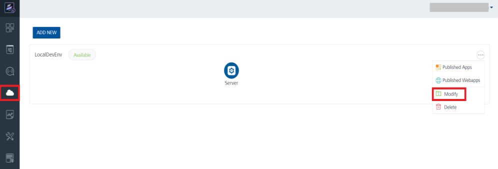

    1. Log in to Foundry Console which you upgraded for V9.x.
    2. In your Volt MX Foundry account, click Environments. The Environments page appears.
    3. Click MODIFY for the environment. The Modify Environment page appears, shown below:
    4. In the Modify Environment page, click SAVE.

**Workaround**
1.  Log in to your Foundry Console.
2.  In your Volt MX Foundry account, click **Environments**. The Environments page appears.
3.  Click **MODIFY** for the environment. The **Modify Environment** page appears, shown below:
    ![](Resources/Images/Foundry-Environments-onpremise_613x268.png)
4.  Click **SAVE**.
    Now you can execute the aforementioned services successfully.
