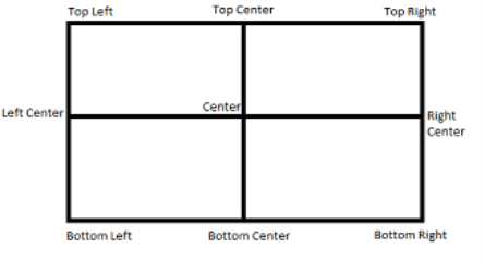

Pin Image Anchor Constants
The Pin Image Anchor Constants define the positions that your app can anchor a pin image to on a map. The image positions are illustrated in the image below.
Constant Description
voltmx.map.PIN_IMG_ANCHOR_BOTTOM_CENTER Anchors the pin image at the bottom center position.
voltmx.map.PIN_IMG_ANCHOR_BOTTOM_LEFT Anchors the pin image by its lower left corner.
voltmx.map.PIN_IMG_ANCHOR_BOTTOM_RIGHT Anchors the pin image by its lower right corner.
voltmx.map.PIN_IMG_ANCHOR_CENTER Anchors the pin image at the center position.
voltmx.map.PIN_IMG_ANCHOR_MIDDLE_LEFT Anchors the pin image at the middle left position of the image.
voltmx.map.PIN_IMG_ANCHOR_MIDDLE_RIGHT Anchors the pin image at the middle right position of the image.
voltmx.map.PIN_IMG_ANCHOR_TOP_CENTER Anchors the pin image at the top center position.
voltmx.map.PIN_IMG_ANCHOR_TOP_LEFT Anchors the pin image by its upper left corner.
voltmx.map.PIN_IMG_ANCHOR_TOP_RIGHT Anchors the pin image by its upper right corner.
