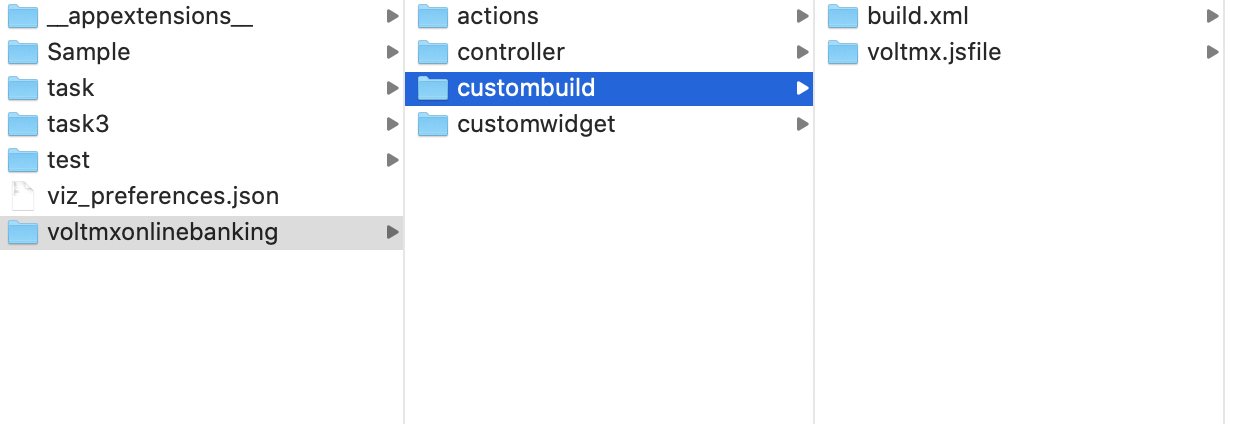

To implement obfuscation in your web apps, do the following:
  1. Navigate to the location of your project. For example, <your workspace folder>/<appid>/.
  2. Create a New Folder with the name custombuild.
  3. In the custombuild folder, create a new file, build.xml.
  4. In the build.xml file, create an ANT task, postbuild.
    1. In the postbuild task, write a code that implements an obfuscation of your choice.
    2. After you implement an obfuscation, write a code to replace the existing artifact in the web artifact folder with the protected artifact.
      The protected artifact is generated as the output from the obfuscator tool.

  1. Navigate to the location of your project. The path may look like <your workspace folder>/<appid>/
  2. Download the custombuild.zip file
  3. Copy the securejs.properties file received over customer service ticket into <your workspace folder>/<appid>/custombuild folder.
