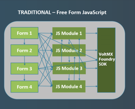

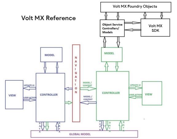

The following diagrams illustrate the differences between traditional Free Form JS app development and app development by using Volt MX Reference Architecture.
The diagrams show that because virtually everything is global in the traditional JavaScript model, any form could invoke any JavaScript module or any SDK function at any time. The result is that apps are nearly impossible to develop in a modular style. Code reuse is low and each new app often has to be rewritten from scratch, even if a previous app contained similar functionalities.
However, under VoltMX's implementation of the MVC architecture, Volt MX Reference Architecture structures app elements into three distinct components: Model, View, and Controller. This leads to benefits such as a structured separation of the code, parallel development of each app component, reduced complexity, and easier testing mechanism. For detailed information on the several advantages of using Volt MX Reference Architecture, click here.
