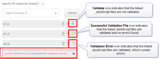

    JavaScript file Validation for the JavaScript service:
    You can validate the associated JavaScript files for the JavaScript service before saving the integration service. To validate the JavaScript file, click the Validate icon available for that file.
    While uploading a JavaScript file, and if the JavaScript file has no errors, the Validation icon turns into the Successful Validation File icon for that file. And the JavaScript file is uploaded to the Workspace.
    Note: When you link the validated JavaScript file to another JavaScript service, the Successful Validation File icon is displayed for that file in the new JavaScript Service.
    While uploading a JavaScript file, and if the JavaScript file has errors, the Console validates the file and displays the Error message dialog with a Download link to the validation results. When you click Download, a .txt file with the validation results will be downloaded to your local system. In this case you must upload a valid JavaScript file and ensure that the upload is successful.
    Important: While uploading the JavaScript file, and if found errors, the Console does not allow you to upload the file to the Workspace.
    For the existing linked JavaScript files, the validation statuses icons are treated as follows:
    Validate icon indicates that the linked JavaScript files are not validated
    Successful Validation File icon indicates that the linked JavaScript files are validated, and no errors found.
    Validation Error icon indicates that the linked JavaScript files are validated, which contain errors.
    For example:
    For the linked JavaScript files, the following icons If you click Validate for the linked JavaScript file, and if the JavaScript file has no errors, the Validation icon turns into the Successful Validation File icon for that file.
    If you click Validate for the linked JavaScript file, and if the JavaScript file has errors, the Error message dialog is displayed with a Download link to the validation results. When you click Download, a .txt file with the validation results will be downloaded to your local system. In this case you must provide a valid JavaScript file, validate the updated file, and only then you can save the service.
    Important: If you have validated the existing JavaScript file and found errors, the Workspace does not allow you to save the service.
    If you have not validated the existing linked JavaScript file, the Validate icon for that file is displayed. If you do not want to validate the JavaScript file, and want to save the service, do not click Validate.

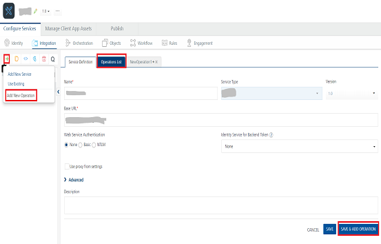

Create Operations for JavaScript
The Operation List tab appears when you click Add Operation in the Service Definition page.
Note: Click Operations List tab > Configure Operation. The Configured Operations list appears.
  1. Click SAVE & ADD OPERATION in your service definition page to save your service definition and display the NewOperation tab for adding operations.
                        OR
    Click Add Operation to add a new operation or from the tree in the left pane, click Add > Add New Operation.
Click to View image
Note: To use an existing integration service, refer to How to Use an Existing Integration Service.
  1. Under Operations List tab, in the JS Library drop-down list, select the required .JS file. For example, Sample.js. This will populate the Function drop-down list.
  2. From the Function drop-down list, select the required functions. Each function equates to an operation.
  3. Click ADD OPERATION to create operations with the selected functions.
    The new operations are created and listed under the Configured Operations. Operation names are auto-generated in the format : _. For example, sample_addTwoNumbers
