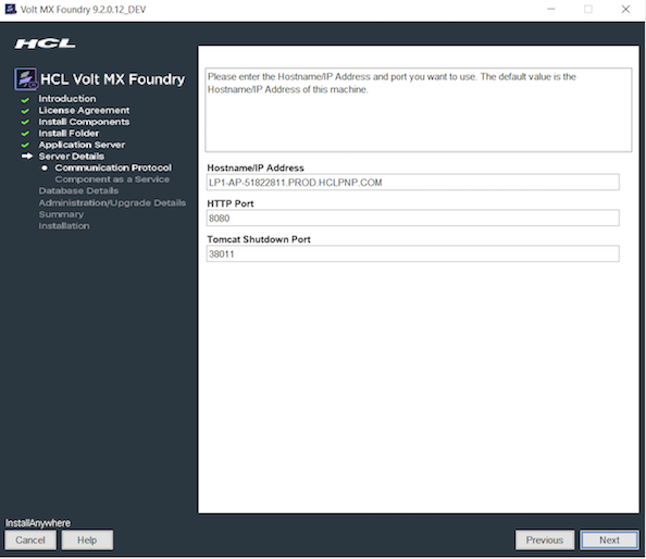

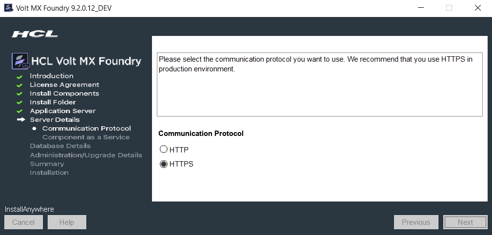

Enable SSL/TLS
Serving web requests over HTTPS is essential to protect data between the client and the application server.
To make your web application accessible through HTTPS, you must implement SSL certificate.
While installing Volt MX Foundry, ensure that you select HTTPS as a communication protocol and provide valid CA certificates.

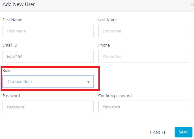

Users and Account roles
Volt MX Foundry provides a mechanism to create a store of users in Volt MX Foundry Console (locally) or import from Active Directory.
Users listed in the User Management can access Volt MX Foundry Console to create apps.
There are a total of four account roles in Volt MX Foundry:
  • Owner: An owner has the most privileges and can do the following:
  • Add, modify, and delete an environment.
  • Add, modify, and delete other owners, admins, and members.
  • Admin: An admin has fewer privileges than an owner and can do the following:
  • Add other admins and members.
  • Modify and delete other admins and members.
  • Grant and deny environment access to other admins and members.
  • Member: A member has the fewest privileges, which includes creating, editing or deleting new Volt MX Foundry applications or services. A member does not have permissions to invite a new user to the cloud or change the environment access of other members.
  • Developer Portal Only: This provides access to specific Developer Portals only and does not provide access to the Volt MX Foundry Console.

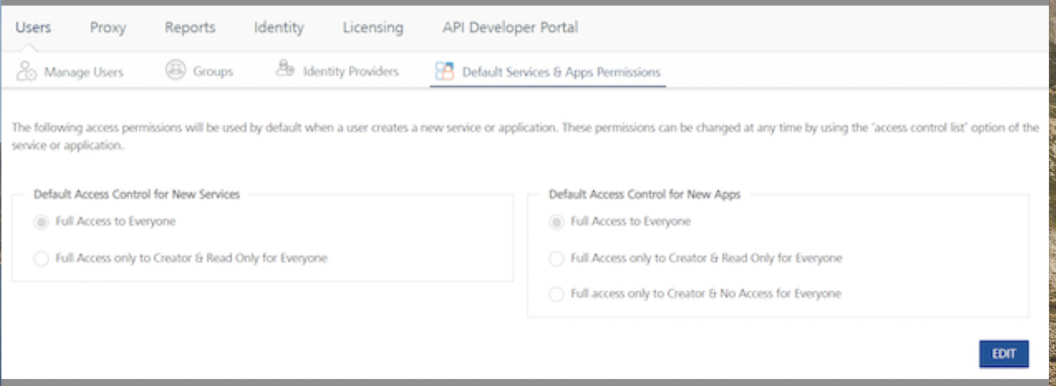

Default Services and Apps Permissions
You can configure access control for Volt MX Foundry applications and services. By default, all the users have full access rights to create and access apps and services.
Use the Apps Console Access Control page to control access to an application. Use the Services Console Access Control page to control access to a service.
Change the default access permissions for a new service or application according to the company’s access policy. This setting can be found in: Settings -> Default Services & Apps Permissions.

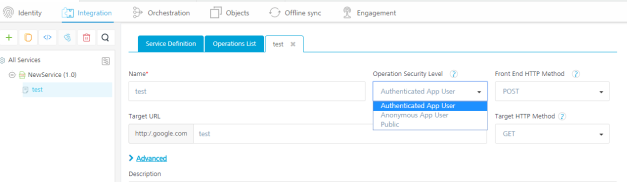

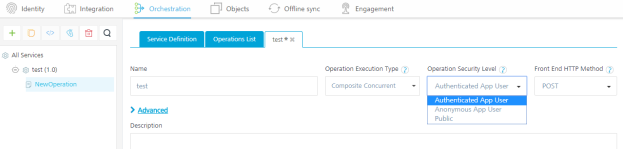

Operation Security Level for Integration and Orchestration services
Select one of the following security operations in the Operation Security Level field for integration and orchestration services. By default, the field is set to Authenticated App User:
  • Authenticated App User – indicates that the operation is secured. To use the operation, an app user must be authenticated by an associated identity service.
  • Anonymous App User – indicates that a user must have the app key and app secret to access this operation.
  • Public – indicates that the operation requires no special security.
For Integration Services:
For Orchestration Services:

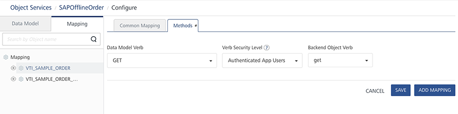

Verb Security Level for Object Services
The Verb Security Level specifies how the client must authenticate to the verb. You can restrict access to this verb to only authenticated app users who have successfully been authenticated using an Identity service. An anonymous app user verb allows access from a trusted client that has the required App Key and App Secret, but the client does not need to authenticate the user through an identity service.
Set the security level to Public to allow any client to access this verb without any authentication requirement. Authenticated App User – indicates that the operation is secured. To use the operation, an app user must be authenticated by an associated identity service.

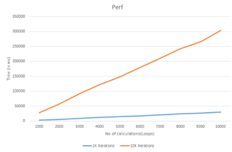

Volt MX Foundry currently encrypts the user credentials with PBKDF2 with 1000 iterations. The password is salted is 24 random bytes generated using java.security.SecureRandom.
As per NIST, it is recommended to use at least 10,000 iterations. If the user wants PBKDF2, iterations to be increased, he can achieve that by setting a property called 'PBKDF2_ITERATIONS'. but this might AFFECT THE PERFORMANCE. Below are the performance statistics for 1k iterations and 10k iterations.
No of calculations (loops)1K Iterations (in ms)10K Iterations(in ms)
1000327828159
2000578057280
3000863491604
400012423122031
500014862148167
600017967179345
700020966210320
800024736242198
900026720266217
1000030150302918

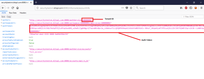

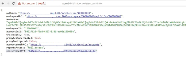

Steps to get Auth token and Tenant ID
  1. Login to Volt MX Foundry using Owner account.
  2. Goto http://<VoltMX_host>:8080/mfconsole/accountInfo
  1. Note down the tenant id and auth token as shown in below image.

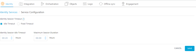

Idle Session Timeout for Volt MX Foundry App
Volt MX Foundry supports configuring session timeout (idle timeout and fixed timeout) for an app identity session.
You can configure either an idle timeout or fixed timeout for apps in the Applications > Identity page.
  • Idle Timeout: Specifies the amount of time in minutes that a session can remain idle before Volt MX Foundry automatically terminates the app.
  • Identity Session Idle Timeout: When an app session on a device remains idle for a certain amount of time, the app session expires automatically. The user will need to log in to the app again.
  • Maximum Session Duration: An apps log-in session is active until the maximum session duration time is met.
  • Fixed Timeout: Specifies the app session’s idle timeout (HH:SS). When the timeout is reached, the session expires automatically, and the user will need to log into the app again.
Volt MX Security Team recommends Identity Session Idle Timeout to be set to 00:05 hours (5 Minutes).

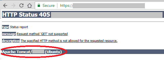

  • Services must display minimal information about the installed version.

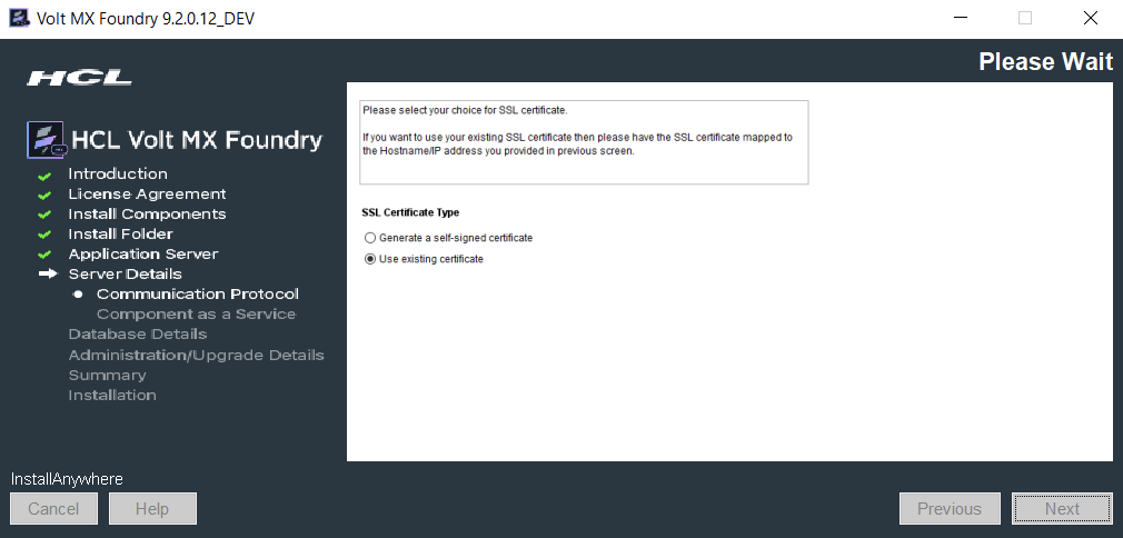

  10. SSL Certificate Type
    Recommended using your own existing SSL certificate rather than going with a generated self-signed certificate.

Preventing Tomcat Version from Error Pages
When you access Volt MX Foundry V9.x by using a particular URL directly from a browser, the web page displays Tomcat Application Server's version.
For example, the Apache Tomcat server version is disclosed, as shown in the following screen shot:
For security reasons, you must disable the server information disclosure for Tomcat application server.
To prevent disclosure of the Tomcat Application Server version, follow these steps:
  1. Open the Tomcat Server > server.xml file.
  2. Add the following:
    <Valve className="org.apache.catalina.valves.ErrorReportValve"
        showReport="false"
        showServerInfo="false"/>
  3. Save the server.xml.
  4. Restart the server.

You must obtain an authToken to configure the number of failed attempts to sign in and blocking threshold time in Identity.
Follow these steps to get the authToken.
  • Log on to the Volt MX Foundry Console from a browser and open the <Volt MX Foundry Url>/mfconsole/accountInfo API in a new tab.
  • The console displays the following response:
  • Copy the authUrl and authToken from the response.

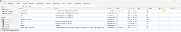

Secure your Cookies (Secure and HttpOnly flags)
For Tomcat as Web Server
Cookies let websites store data directly on the web browser of a user. Websites primarily use cookies to identify the user session based on their browsing. Cookies contain sensitive data that must be protected.
To make your cookies secure, modify the web.xml files of the webapp for the required components.
  • WebApps > mfconsole for Volt MX Foundry Console
  • WebApps > admin for Volt MX Foundry Admin Console
  • WebApps > vpns for Volt MX Foundry Engagement
  • WebApps > authService for Volt MX Foundry AuthService
Add the following code in the web.xml file:
<cookie-config>
<http-only>true</http-only>
<secure>true</secure>
</cookie-config>
  • Restart the Application Server.
You can use developer tools to verify the changes.

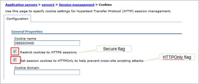

For WebSphere as the Web Server, follow these steps.
  1. Sign in to Volt MX Foundry Console.
  2. Select Environments from the left navigation pane.
  3. Go to Admin Console.
  4. In Application servers
    1. Select your server.
    2. Go to Session management > Cookies, enable the cookies .

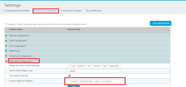

Setting the response header for Volt MX Foundry version V9 SP2 or later versions.
To add the OWASP Secure Header to WebApp Static Files, follow these steps.
  3. Select App Services to open the Server Admin Console.
  4. Go to Settings > Runtime Configuration > Web Apps Configuration > Custom Response Header.
  5. Add the required header in the following format:
    'name': 'X-Content-Type-Options',
    'value': 'nosniff'
    'name': 'X-Frame-Options',
    'value': 'DENY'
    'name': 'X-XSS-Protection',
    'value': ' 1; mode=block'
    'name': 'Strict-Transport-Security',
    'value': 'max-age=86400; includeSubDomains'

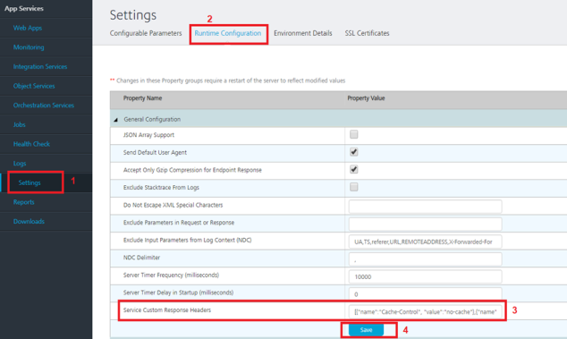

To add OWASP Secure Headers to Middleware Service, follow these steps.
  4. In Admin Console, select Settings from the left navigation pane.
  5. In Settings > Runtime Configurations > General Configuration > Service Custom Response Headers, add the headers in the following format:
        "name": "Cache-Control",
        "value": "no-cache,no-store,must-revalidate"
        "name": "Pragma",
        "value": "no-cache"
        "name": "X-Content-Type-Options",
        "value": "nosniff"
        "name": "X-Frame-Options",
        "value": "DENY"
        "name": "X- XSS-Protection",
        "value": "1; mode=block"
        "name": "Expires",
        "value": "0"
        'value': 'max-age=86400;includeSubDomains'

Setting the header for Volt MX Foundry version V9 SP2 Hotfix version or later versions.
To add response headers to middleware services, follow these steps.
        "name": "Pragma",
        "value": "no-cache"
        "value": "nosniff"
        "value": "DENY"
        "name": "Expires",
        "value": "0"
