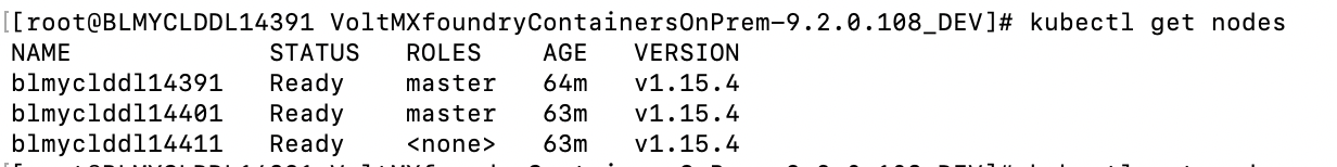

  1. All Kubernetes masters and nodes must have the swap disabled. This is the recommended deployment as per the Kubernetes community.
    a. Run the following command to disable swap.
    sudo swapoff -a
    b. Run the following command to update fstab so that the swap remains disabled even after a reboot.
    sudo sed -i '/ swap / s/^\(.\*\)$/#\1/g' /etc/fstab
    c. Restart the node after the swap is disabled.

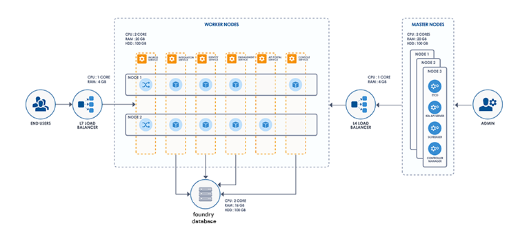

Architecture
Following is the architecture diagram of the Volt MX Foundry Container Cluster Solution.

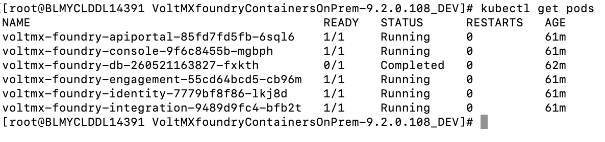

The complete Volt MX Foundry Container Cluster Solution will have a total of six pods.
Following is the list of pods present in the VoltMX Foundry Container Cluster Solution:
  • Console
  • API Developer Portal
  • Identity
  • Integration
  • Engagement
  • Database (exits on completion of the Database scripts execution)
The following is the list of Docker images used for the pods in the VoltMX Foundry Container Cluster Solution:
  • Foundry Console (Contains mfconsole.war,   workspace.war,  and  accounts.war)
  • API Developer Portal (Contains apiportal.war)
  • Identity (Contains authService.war)
  • Integration (Contains admin.war, services.war,  middleware.war, and apps.war)
  • Engagement (Contains vpns.war)
  • Database (Contains Database migration scripts)
The docker images will be pulled when you execute the installation scripts in the "HCL Volt MX Foundry Container Installer" found on HCL's FNO download website: https://hclsoftware.flexnetoperations.com/flexnet/operationsportal/entitledDownloadFile.action?downloadPkgId=HCL_Volt_Foundry_v9.2.x&orgId=HCL

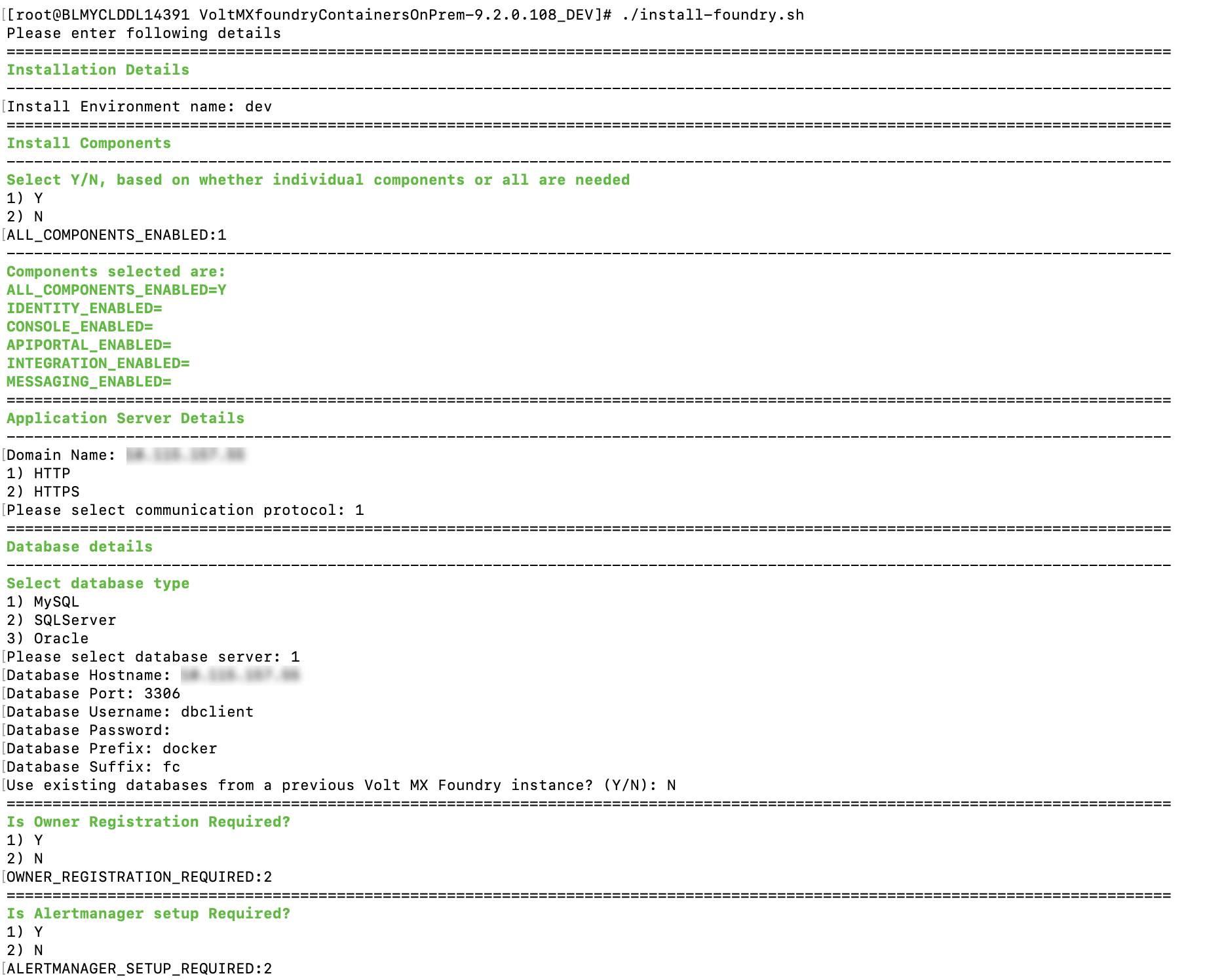

Installation Types
Inputs for installation can be gathered through two modes. Any of the following modes can be chosen for installation.
  • Command Line - Volt MX Foundry Container Cluster Solution can be installed using the bundled install shell script, which will prompt the user for required values.
    The syntax for installing through the Command Line:
    sudo ./install-foundry.sh
  • Silent Installation - The installation script also supports silent installation if the config.properties file is passed as an argument (for example, /path/install-foundry.sh config.properties). Using this, you can have additional ability to pass custom Tomcat JAVA_OPTS, Heap memory settings, and time-zone settings as well.
    The syntax for installing using the config.properties:
    sudo ./install-foundry.sh config.properties
Configuration
The following parameters are to be provided by the user during Installation:
  1. INSTALL_ENV_NAME - The install environment name can be anything in lowercase (String). The possible values are: dev, qa, prod, or eastusprod.
    Note: The Install Environment Name must not contain numbers.
    • IMAGE_REGISTRY_USERNAME: - This is the email ID you use to log in.
    • IMAGE_REGISTRY_PASSWORD: - This is the CLI secret found under your User Profile in HCL Harbor.
  2. Install Components: The following properties must be set to either Y (yes) or N (no). If ALL_COMPONENTS_ENABLED is set to Y, the rest of the inputs can be left empty. If ALL_COMPONENTS_ENABLED is set to N then at least one of the following input properties must be set to Y.
    • ALL_COMPONENTS_ENABLED
    • INTEGRATION_ENABLED
    • IDENTITY_ENABLED
    • MESSAGING_ENABLED
    • CONSOLE_ENABLED
    • APIPORTAL_ENABLED
  3. Application Server Details
    • SERVER_DOMAIN_NAME: The Domain Name for Volt MX Foundry. This value should be the hostname of the LoadBalancer. For example: abc.companyname (DNS name).
    Note: Domain name cannot be an IP address or 'localhost'.
    • COM_PROTOCOL: The communication protocol for Volt MX Foundry. This value can be either http or https.
    • HTTPS_CERT_FILE: The path to the existing certificate and key files. This value can be empty if the communication protocol is HTTP. The path should point to a valid pem file.
    • HTTPS_KEY_FILE: The path to the existing certificate and key files. This value can be empty if the communication protocol is HTTP. The path should point to a valid pem file.
  4. Database Details:
    • DB_TYPE - This is the Database type you want to use for hosting Volt MX Foundry. The possible values are:
    • For MySQL DB server: mysql
    • For Azure MSSQL or SQL Server: sqlserver
    • For Oracle DB server: oracle
    • DB_HOST - This is the Database Server hostname used to connect to the Database Server.
    Note: If the Database Hostname is an IP address, it should be a static IP address.
    • DB_PORT– This is the Port Number used to connect to the Database Server. This can be empty for cloud manage service.
    • DB_USER - This is the Database Username used to connect to the Database Server.
    • DB_PASS - This is the Database Password used to connect to the Database Server.
    • DB_PREFIX – This is the Database server prefix for Volt MX Foundry Schemas/Databases.
    • DB_SUFFIX – This is the Database server suffix for Volt MX Foundry Schemas/Databases.
    • Database Prefix and Suffix are optional inputs.
    • In case of upgrade, ensure that the values of the Database Prefix and Suffix that you provide are the same as you had provided during the initial installation.
    • If DB_TYPE is set as oracle, the following String values need to be provided:
    • DB_DATA_TS: Database Data tablespace name.
    • DB_INDEX_TS: Database Index tablespace name.
    • DB_LOB_TS: Database LOB tablespace name.
    • DB_SERVICE: Database service name.
    • USE_EXISTING_DB: If you want to use an existing databases from a previous Volt MX Foundry instance set this variable to Y. If not the set the USE_EXISTING_DB variable to N.
    You must provide the location of the previously installed artifacts (the location should contain upgrade.properties file).
    For example: PREVIOUS_INSTALL_LOCATION = /C/voltmx-foundry-containers-onprem/kubernetes.
  5. VoltMX Foundry Account Registration Details: The following properties are required for owner registration. It is not required for an upgrade. If OWNER_REGISTRATION_REQUIRED is set to Y (yes), then you must provide all the following inputs:
    • OWNER_REGISTRATION_REQUIRED - Y/N.
    • OWNER_USER_ID – E-mail ID used for Volt MX Foundry Registration.
    • OWNER_PASSWORD – Password used for Volt MX Foundry Registration.
    • OWNER_FIRST_NAME – First Name used for Volt MX Foundry Registration.
    • OWNER_LAST_NAME – Last Name used for Volt MX Foundry Registration.
    • OWNER_ENV_NAME – Environment name to which the generated applications should be published.
  6. TIME_ZONE - The Time Zone of the Database used for Volt MX Foundry installation. The Time Zone variable must be set to maintain consistency between the Application server and the Database server. For determining what value to set for the time zone you can refer to List of tz database time zones on Wikipedia.
    Note: The Time Zone is an optional value. If you do not provide any Time Zone, it is set to Etc/UTC.

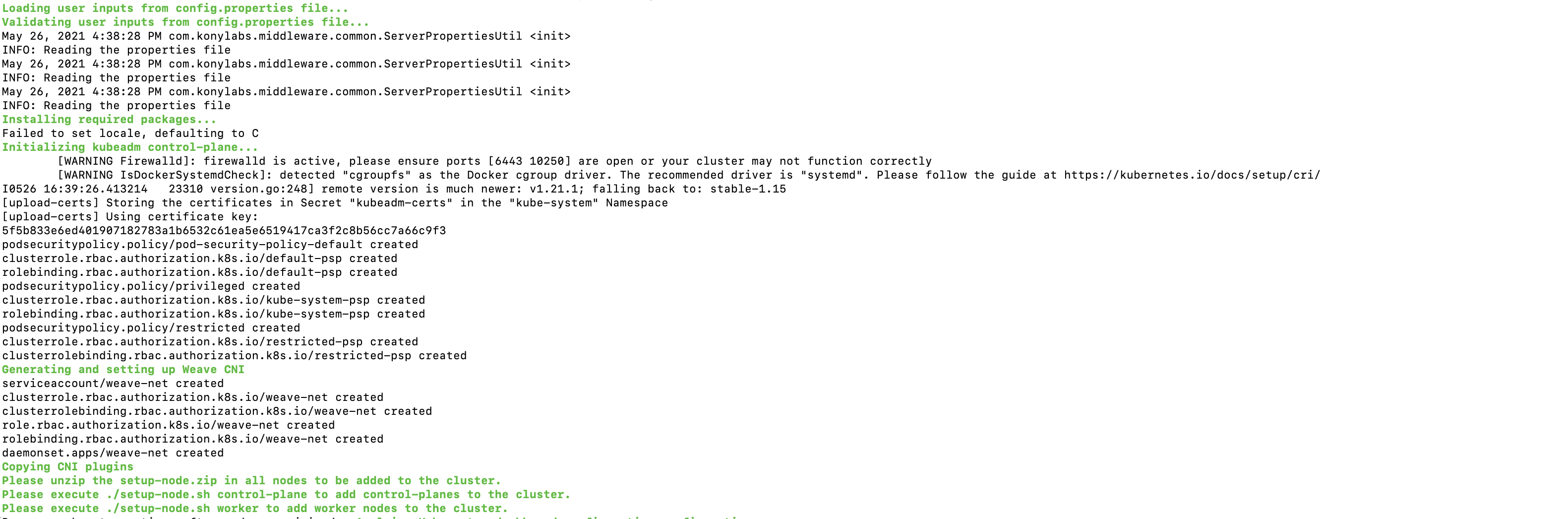

  3. Run the following command to setup the master. It downloads and installs cluster packages, initializes kubeadm, sets up Weave CNI, generates token and waits for the worker node to join the master to proceed further.
    Note: You must provide execute permissions to run the install-foundry.sh file on Linux.

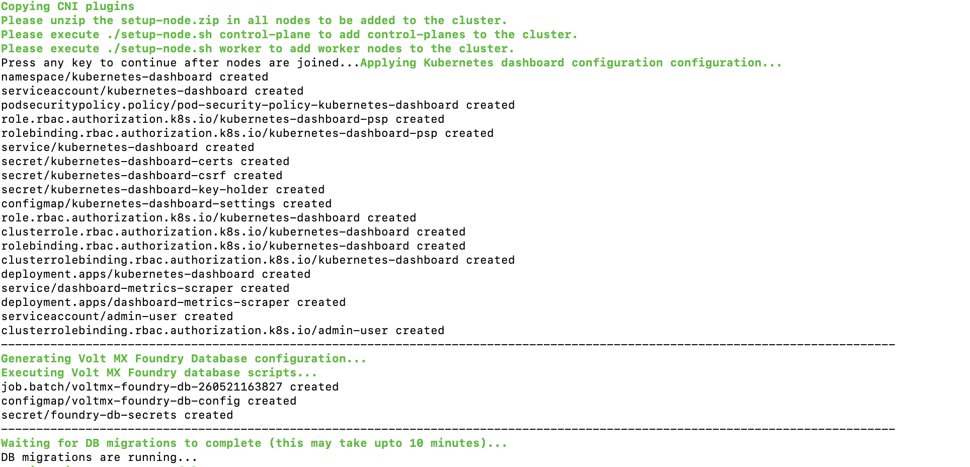

  4. To join other nodes as master/worker, copy the setup-node.zip file which is available in the Foundry Container artifact folder(VoltMXFoundryContainerOnPrem-9.0.0.0_GA) into the node to join as the master/worker and then perform the following steps.
    1. Extract the setup-nodes.zip file.
      sudo unzip setup-node.zip -d setup-node
    2. Navigate to the setup-nodes folder.
      cd setup-node
    3. Execute the following command.
      For Master:
      sudo ./setup-node.sh control-plane
      For Worker:
  5. After the cluster setup is done to get the list of nodes in cluster, use below command.
    kubectl get nodes
Resuming Installation In Master Node

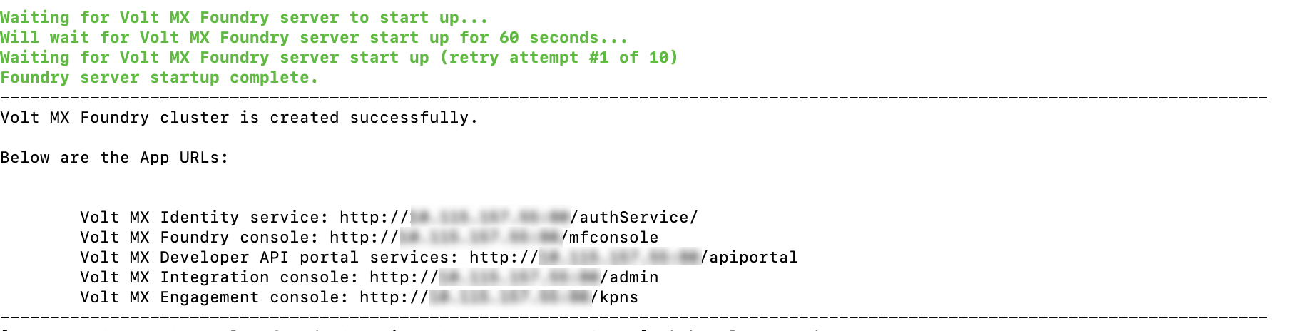

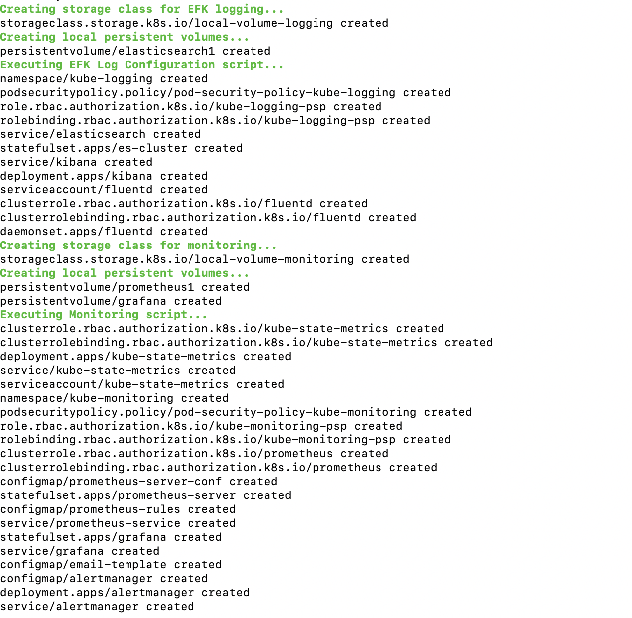

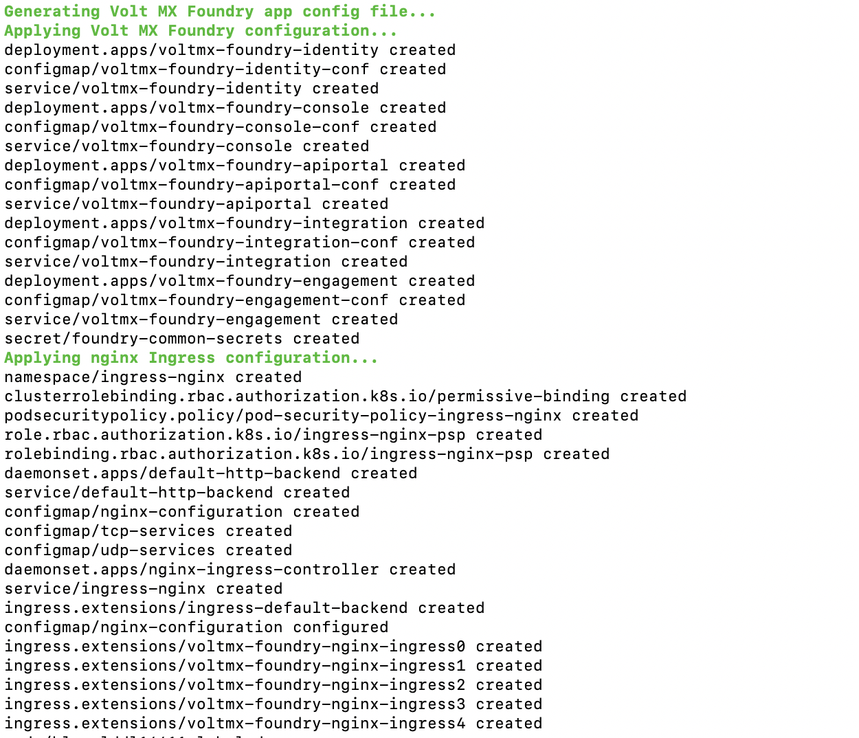

After joining masters and worker nodes, you must press enter in the master node terminal to resume the installation.
  1. Kubernetes Dashboard and DB Migrations
  2. Foundry and Ingress configuration
  3. EFK , Prometheus, and Grafana Monitoring tool configuration.
  4. Foundry healthcheck
  5. Run the following command to check status of pods.
    sudo kubectl get pods
