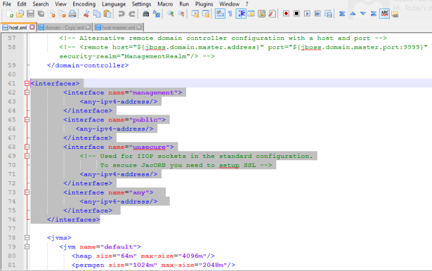

For JBoss domain mode installation, configure the following interface address.
  1. Go to <JBOSS EAP dir>/domain/configuration/host.xml
  2. In place of existing  interfaces xml tag, replace the default content with below details:
<interfaces>
        <interface name="management">
            <any-ipv4-address/>
        </interface>
        <interface name="public">
           <any-ipv4-address/\>
        </interface>
        <interface name="unsecure">
            <!-- Used for IIOP sockets in the standard configuration.
                 To secure JacORB, you need to set up SSL -->
            <any-ipv4-address/>
        </interface>
        <interface name="any">
            <any-ipv4-address/>
        </interface>
    </interfaces>
