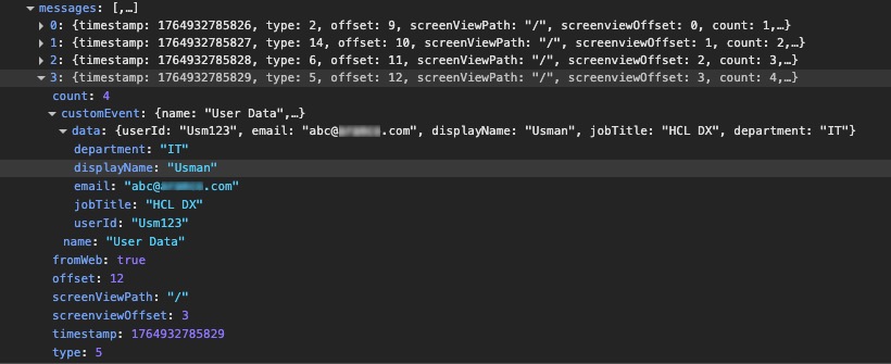

Lastly, a UIC config item would be required in the core:modules section. Highlighted in the config below is the configuration for when the custom module should be executed.
modules: section Config
userData: {
    events: [{
        target: window
The resulting output is sent to Discover as a Type 3 message.
