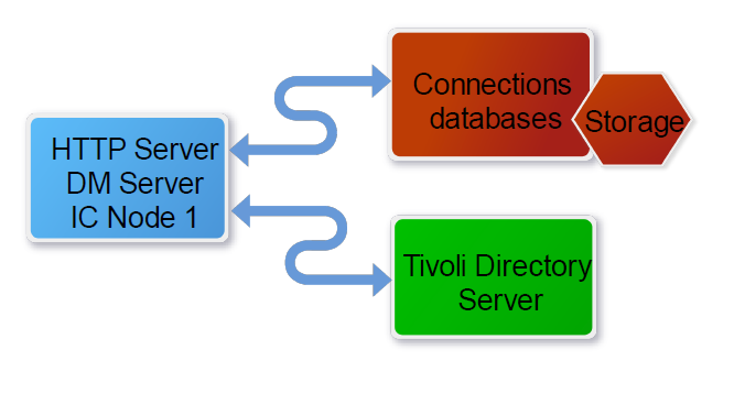

Single-Server Topology
For smaller deployments, some of these tiers might be run on a single system. For example, a common configuration is to use a single node to run the HTTP server and the application server, while the database and directory servers are run on separate servers. This is the configuration we have used for most performance benchmarks on Linux.
Figure 1 illustrates a typical system diagram used for the performance benchmark tests.
Figure 1: Connections Performance Benchmark System Diagram

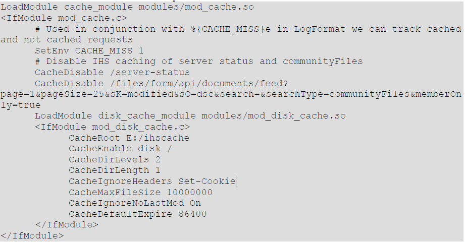

HCL Connections includes resources that can be cached and compressed. Implementing a caching solution reduces the impact on the Application Server, therefore increasing capacity. Implementing a compression solution reduces the network bandwidth usage, improving users' experience. Compression is particularly recommended if the site will be accessed by users with slow network links or who are a long distance from the application server (for example, users on a different continent from the application servers).
Content Caching Details and Implementation Choices
HCL Connections includes resources that change infrequently, such as static page elements, JavaScript, stylesheets, and images. Also cacheable are some public requests otherwise processed by the application server. For example, the list of public Wikis can be cached for a short period of time. Caching them reduces the load on the application and database servers for a busy site. We recommend including a caching solution in any large-volume deployment.
There are two choices for caching: using a reverse proxy or enabling caching in the HTTP server. In this section, we discuss both options.
Note: For our single server benchmark configurations, we enabled caching on the HTTP server.
We suggest having the HTTP server reside on a different server than Connections for high workloads. Caching on the HTTP server is a good solution for this setup.
A reverse proxy can be used:
- as an alternative to an HTTP server to cache and compress public content
- to support a high number of concurrent "LongPoll" connections.
Other configurations are viable, but make sure that large cacheable resources are cached and compressed.
The advantage of using a reverse proxy over an HTTP server for caching depends on the topology used. In general, it is best to have the caching done on a system other than the application server. If the HTTP server is on the same server as the application server, it is good to use a separate server as a caching reverse proxy.
We used IBM HTTP Server 8.5 in our measurement environments. Our Single-Server configurations have the web server running on the same system as the Connections application server. If, during your monitoring, you notice insufficient processor capacity on the system when running the web server and the Connections server co-located on a single system, consider separating the servers onto different systems.
Key point: Caching is recommended for increasing server performance and improving the client experience.

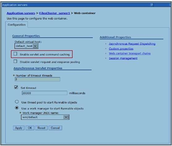

To ensure smooth downloads of multiple large files in a single session, follow these steps for large deployments:
- Disable servlet caching on the Files application server cluster.
- Monitor Java heap usage and size accordingly.
Note: These instructions are applicable to the "Large Deployment" option where the Files application is deployed to its own application server cluster.
To disable Files servlet caching, in the WebSphere Integrated Solutions Console, click: Servers → Server Types → WebSphere application servers → FilesCluster → Container Settings: Web Container Settings → Web container → Un-check "Enable servlet and command caching".
Figure 2: Disable Files servlet caching

The typical environment used for the benchmark workload is as follows:
- 1 WebSphere Application Server node – typically a 16-core server with 64GB of RAM running the HCL Connections Version 8 product in 19 clusters (JVMs) with the HCL HTTP Server co-located.
- WebSphere Deployment Manager (DM) node serving to administer the environment. Note that the DM has minimal impact on the system.
- 1 database server – typically a 16-core with 64GB of RAM server running IBMDB2® software.
- 1 LDAP server, running Tivoli® Directory Server – processor load on this tier is minimal.
- A dedicated network file-system having 2T of disk
- Note that in a large production environment, a dedicated file server is recommended.
- For the DB2 server and the mapped network file-system, we used a high-performing disk subsystem.

Enabling Caching in IHS
For the performance evaluation of HCL Connections Version 8, disk caching was used since in-memory caching is deprecated. With proper setup of the operating system's file system buffering, disk caching achieves results similar to in-memory caching. Disk caching implicitly uses system memory as file system cache which can be swapped out if needed.
How to Set Disk Caching
These values are set in the HTTP server's httpd.conf file:
On Linux, make sure that the HTTP server has permission to write to the location specified by CacheRoot by running the command: chown nobody /ihscache
Make sure to select either disk or in-memory caching, but not both. If a caching reverse proxy is used, in most cases there is no need for caching on the HTTP\ server as well.

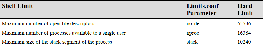

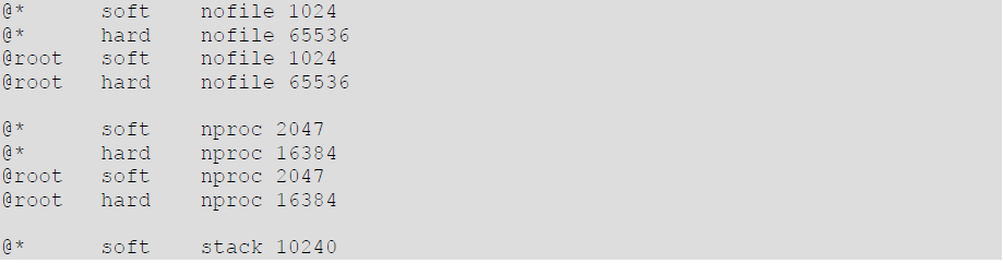

Table 5: Setting User Limits for DB2
| Shell Limit | Limits.conf Parameter | Hard Limit |
| Maximum number of open file descriptors | nofile | 65536 |
| Maximum number of processes available to a single user | nproc | 16384 |
| Maximum size of the stack segment of the process | stack | 10240 |

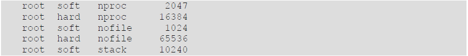

To increase the shell limits for root install:
- Add the following lines in the /etc/security/limits.conf file:
- Add the following line to the /etc/pam.d/login file, if it does not already exist:
session required pam_limits.so

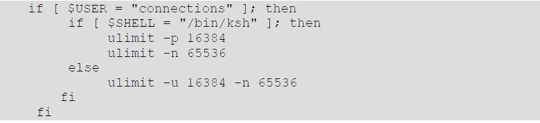

Setting Shell Limits for the Connection User on the Application Server Tier
To improve the performance of the WAS software, increase the following shell limits for the user running Connections.
Setting Shell Limits for the Connections User
To increase the shell limits:
Depending on the root user's default shell, make the following changes to the default shell startup file:
For the Bourne, Bash, or Korn shell, add the following lines in the /etc/profile file (or the /etc/profile.local file on SUSE Linux Enterprise Server systems):
- For the C shell, add the following lines in the /etc/csh.login file (or the /etc/csh.login.local file on SUSE Linux Enterprise Server systems):

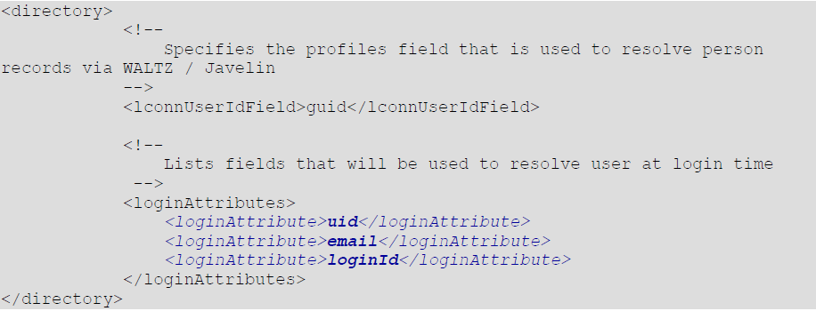

Profiles Login Attributes
A user can log in with a number of attributes, depending on their company policy, (User ID, eMail ID, and so on). These attributes can be specified in profiles-config.xml. The default out of the box installation of HCL Connections specifies three of the most common attributes that customers might use to login, as in the following example. A customer can also specify other attributes:
Each attribute listed in the profiles-config.xml incurs a look-up performance cost. For the majority of customers using a single attribute login option, the system can be configured to use a single value to avoid unnecessary multiple look-ups and therefore improve performance. Here is an example for a customer using the UID as the login attribute:

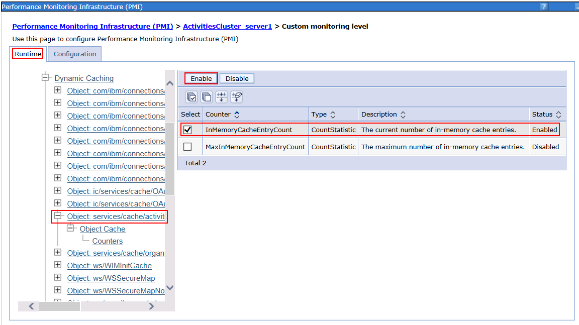

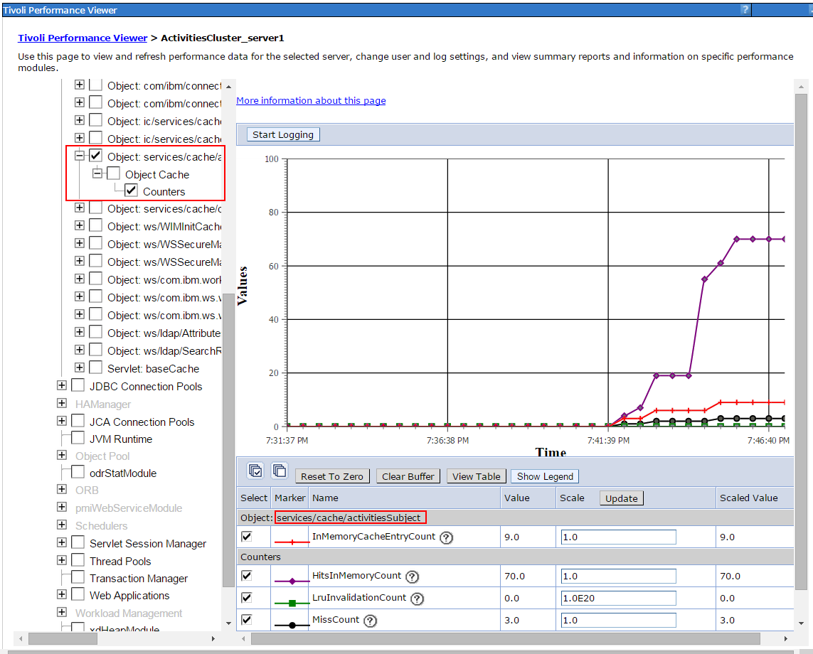

Step 3. Monitor the cache size occupancy and hit rate. Ensure that the cache has sufficient space (i.e. not full) and verify hitrate %

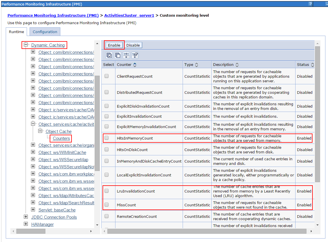

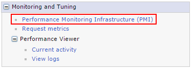

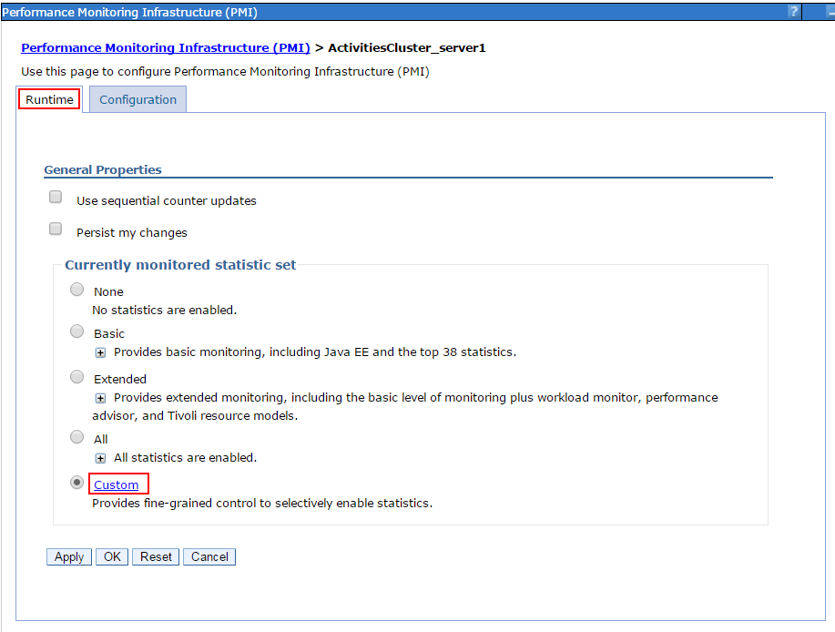

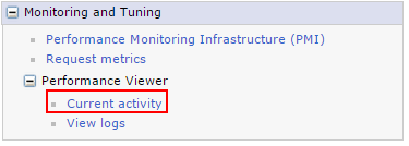

Setup Monitoring From the WebSphere Application Server (WAS) Integrated Solutions Console
Monitor cache statistics under load
Calculate Hit rate
hitrate% = (HitsInMemoryCount) / (HitsInMemoryCount + MissCount) * 100
e.g. 70 / (70+3) * 100 = 95.89%
Cache Size Occupancy
Ensure the InMemoryCacheEntry count is below the cache.instance.0.cacheSize you have set in Step 1
Note: Poor hit rate would also suggest the cache size was not sufficient.
