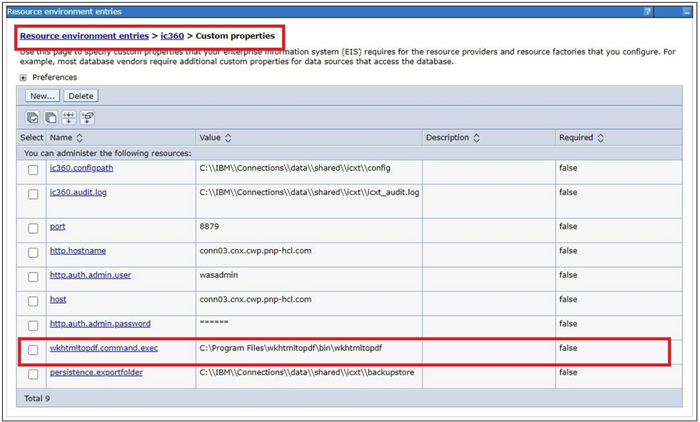

      • Enter the WebSphere administrative console (e.g.: https://your.dmgr.host:9043/ibm/console) and navigate to Resources > Resource Environment > Resource Environment entries
      • Look for the ic360 resource environment entry and click on it
      • Navigate to Additional Properties > Custom properties
      • Click New... to create a new property
      • Enter the name wkhtmltopdf.command.exec and the path to the wkhtmltopdf binary (including its name) as the value, e.g. C:\Program Files\wkhtmltopdf\bin\wkhtmltopdf.exe on Windows or /opt/HCL/Connections/wkhtmltox/bin/wkhtmltopdf on Linux.
      • Click Apply and OK.
      • Save the changes to the master configuration.
      • Restart ICXT server. wkhtmltopdf configuration

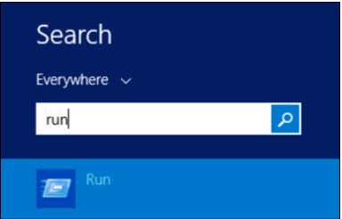

      • Search for "run"
      Fonts Windows open Run

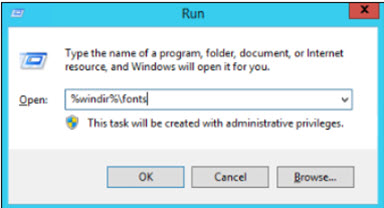

      • Enter %windir%\fonts

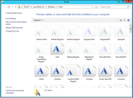

      Open fonts Config
      Fonts Config

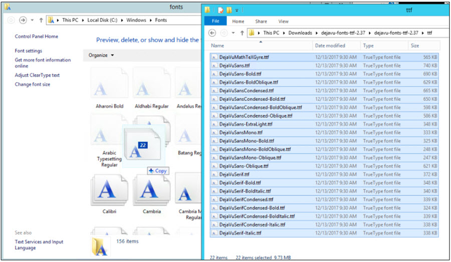

      • Drag and drop the extracted fonts from the ttf folder to the Fonts config window
