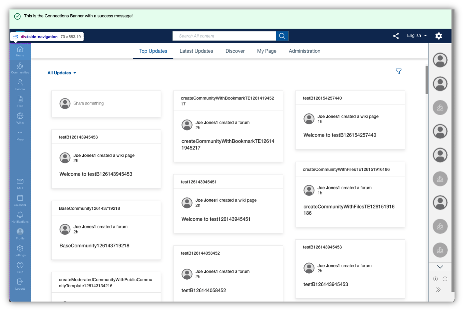

The side navigation bar contains menus that are specific to the available Connections apps and important user links. These are separated into a main and bottom area, as well as sub-menus.
Custom styling
You can customize the visual properties of the side navigation bar, such as its background color and text color. For more information, refer to Customizing the look and feel of HCL Connections.

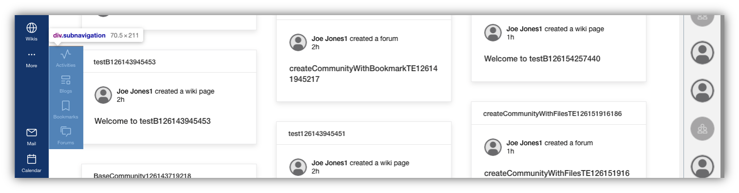

submenu |
Lets you add a menu with more options. This configuration expects the entries within the submenu to be provided as a list. For an example, refer to the more element in the default entries snapshot below. The submenu is only recognized and applied in the main area. |
