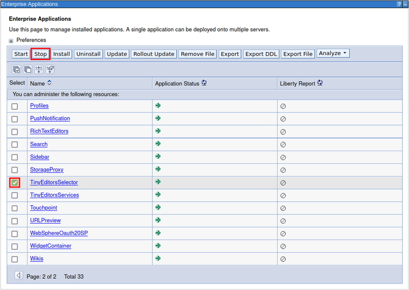

  3. Select the checkbox for TinyEditorsSelector from the list of applications and click Stop.
    Stop TinyEditorsSelector

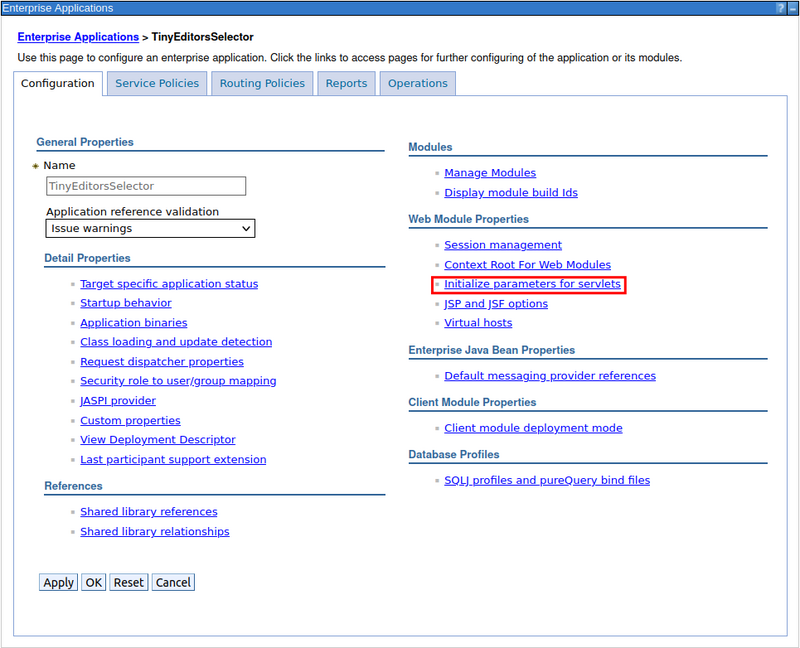

  5. On the Configuration tab, click the Initialize parameters for servlets link.
    "Initialize parameters for servlets" link

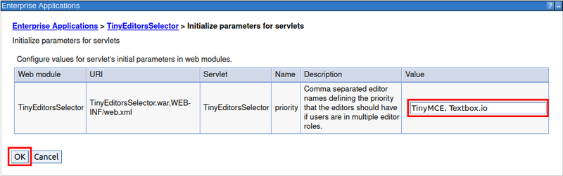

  6. Set the priority value to "TinyMCE" in any order separated by a comma then click OK.
    "Initialize parameters for servlets" dialog

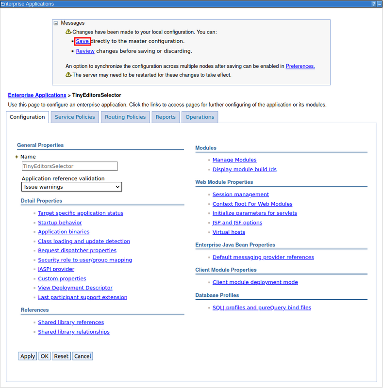

  7. Click Save to save the change.
    Save configuration changes
  8. Select the checkbox for TinyEditorsSelector from the list of applications and click Start.
    Start TinyEditorsSelector
