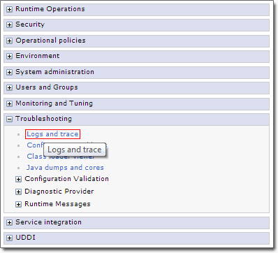

|Click Troubleshooting > Logs and trace.

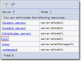

|Click the Cluster/ AppServer, where you have mapped and installed the Connections Engagement Center application.

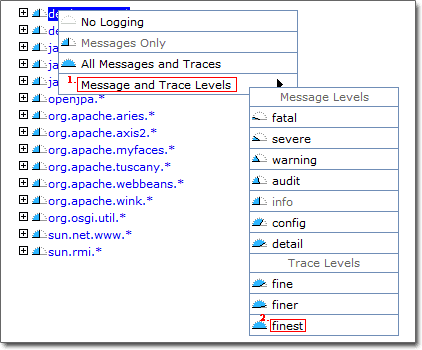

|In the list that appears, search the list section de.timetoact.*.
| |9
|Click de.timetoact.* and a pop-up menu menu appears. Sometimes it may happen that you have to scroll to the bottom of the page to see the pop-up window.
Now click Message and Trace Levels and then select finest.

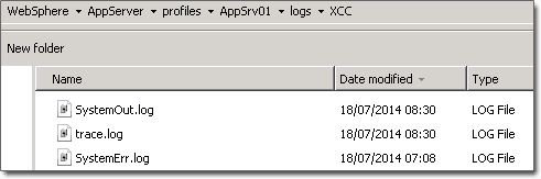

|Go to your Connections Engagement Center page and try to reproduce the issue to be traced. Make sure that the page is loaded completely once so that the trace logs are written. Then, open the log files from your Cluster / AppServer on your server.
| |12|Either copy or include the files SystemOut.log, trace.log and SystemErr.log with the Problem Management Report (PMR) submitted with your Service Request. Go to the HCL Connections Support Portaland click Tickets > Service Request from the drop down menu to get started.
