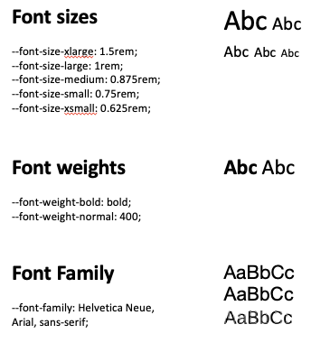

Fonts
Connections primarily uses the following font sizes, weights, and families:
// Font sizes
--font-size-xlarge : 1.5rem;
--font-size-large : 1rem;
--font-size-medium : 0.875rem;
--font-size-small : 0.75rem;
--font-size-xsmall : 0.625rem;
--font-size-header : 1rem;
// Font weights
--font-weight-bold : bold;
--font-weight-normal : 400;
// Font Family
--font-family : Helvetica Neue, Arial, sans-serif;
Which renders as the following:
