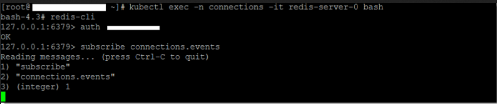

  2. Subscribe to the connections.events channel.
    To subscribe to the Redis connections.events channel, you must first connect and authenticate with the password (secret) set during bootstrap installation.
    1. Connect to the Redis server:
      redis-cli
    2. Authenticate with the server:
      auth <redis-password>
    3. Subscribe to the channel:
      subscribe connections.events
    For example: The connections.events Redis channel

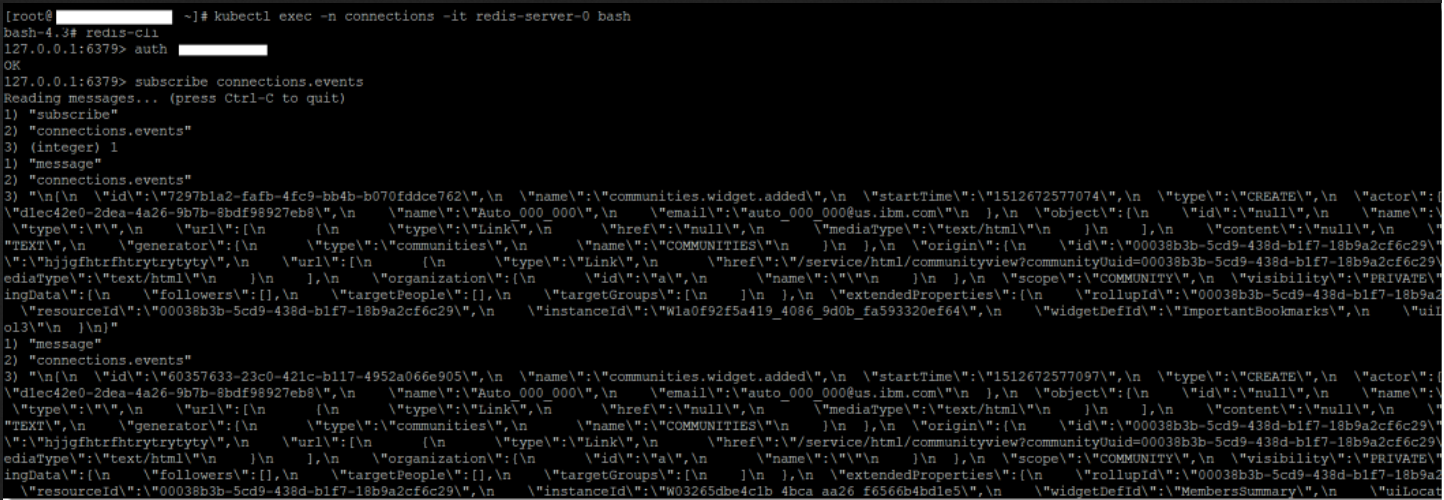

  3. Follow these steps to validate that events are populated in the connections.events channel.
    1. Keep the channel from the previous step open, and browse to the Homepage of your Connections server.
    2. Log in as a user with rights to create a community.
    3. Create a community, then switch back to the Redis pod. You should see events being posted in the channel.
      For example: Redis events
