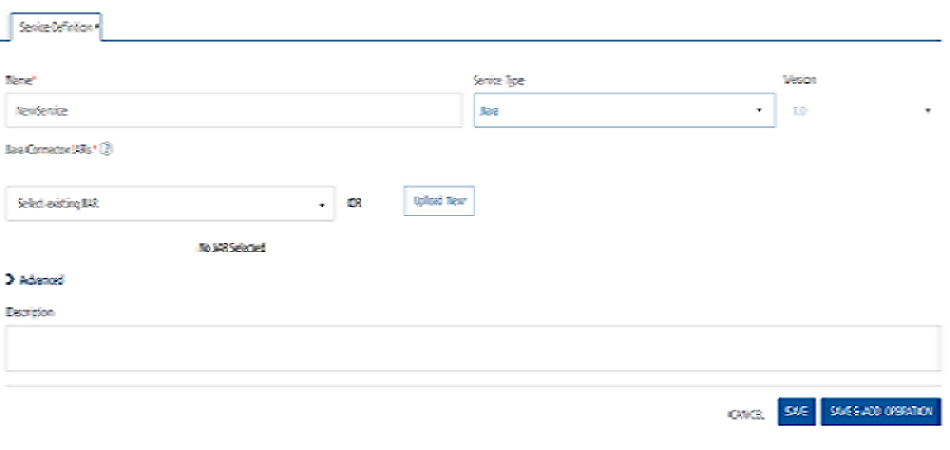

Configure Java Endpoint Adapter
To configure Java service in the Integration Service Definition tab, follow these steps:
  1. In the Name field, provide a unique name for your service.
  2. From the Service Type list, select Java.
  3. From the Java Connector JARs list, select the required JAR file that contains the classes that implement the JavaService interface for this Integration Service from existing JARs in the account or click UploadNew to select the JARs from your local machine.
    Note: You can select multiple JAR files from the Java Connector JARs list if required.
    Important: To upload an updated JAR file, upload the new file, which must have the same name as the old JAR file. The new JAR file overrides the existing file.dsd
  4. For additional configuration of your service definition, provide the following details in the Advanced section:
