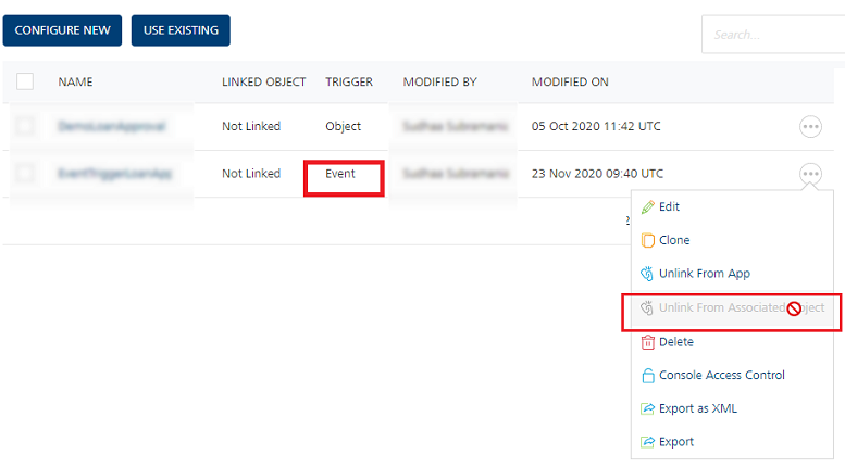

Event triggered workflow
This type of workflow as the name suggests can be made to trigger by listening to Events on Foundry. You can configure Workflow service to listen to an existing Server-event Topic of integration/object service verb invocations or via custom code. An event triggered workflow is initialized through the Signal Start node, which is listening to a Server Event that is raised on the Foundry event bus.

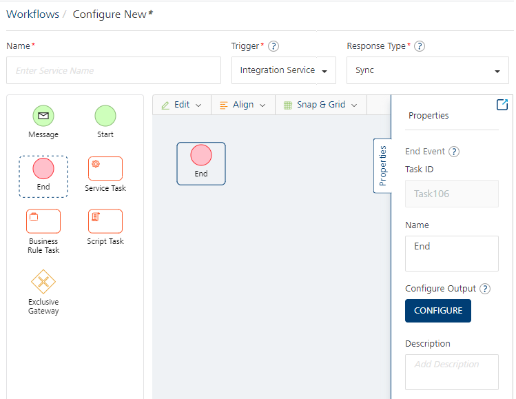

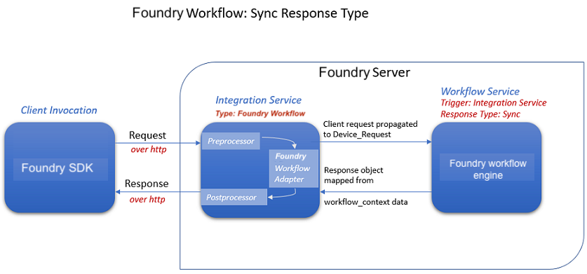

These new category of workflows can send responses to clients either Synchronously or Asynchronously. Synchronous workflows are essentially complex service orchestrations or straight-through processing workflows in which the calling integration service waits till the workflow responds with the final result. Asynchronous workflows are more suited for long-running processes that have to wait for an update from back-end systems. These workflows immediately respond to the calling integration service with an “Acknowledgement” and the final result(s) from workflow is sent to client as Websocket messages.
The following supported Response Types are supported in workflow service trigger type Integration:
  • Sync (Synchronous): The calling Integration Service will send a response to the client after the workflow execution is complete. This type of response is primarily used for straight-through-processing when the workflow is expected to be completed quickly.
    • The Integration service response will be blocked until workflow execution is complete for Sync and the final response is sent with a workflow instance_id.
    • Sync workflows will not have Timer, User Task, Start Signal, Catch signal, Throw signal.
    • Sync workflows should have Start and End nodes.
    • Each output path should have one End node with an output mapper. The End node will have output response mapper that will get sent back to client via the Integration service response.
    The following flow diagram details how the Sync Workflow works:

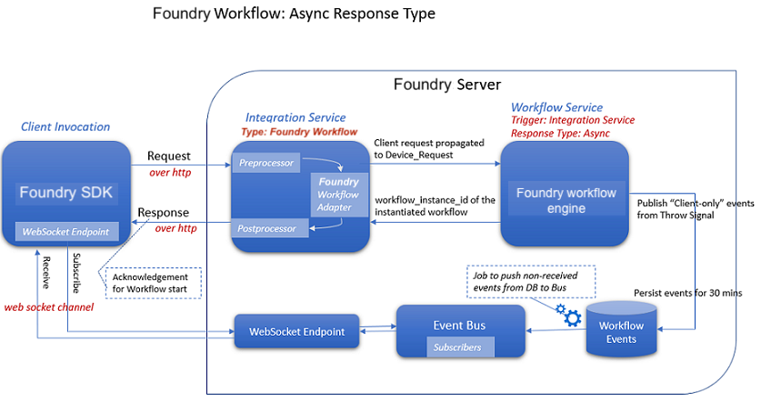

  • Async (Asynchronous): The calling Integration Service will send an acknowledgment that the Workflow is triggered. This type of response is primarily used for long-running Workflows. Responses to clients/devices are sent as Events that are received using a websocket.
    • Integration service response get an immediate Acknowledgement response from the workflow engine with a workflow instance_id.
    • Server-broadcast response: Server - broadcast event type allows you to raise a server event that can be listened by other Foundry services.
    • Private client response: Client-only event type allows you to raise a private event on configured Topic Name over a web socket channel associated with a specific client.
      Only clients subscribed to the Topic Name over a web socket channel will receive private responses to the workflow execution.
      For more details, refer to Server Event APIs SDKs - VoltMX Iris.
    • Each output path may have a Throw signal with output response mapper. The websocket message event will contain the output response mapped via the Throw signal mapper. However configuring a Throw signal and sending Async response to clients via websocket is optional and dependent upon the business use-case.
      The following flow diagram details how the Async Workflow works:

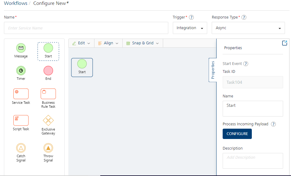

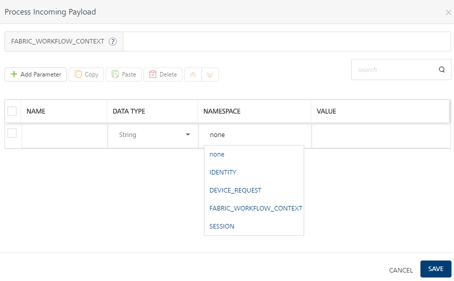

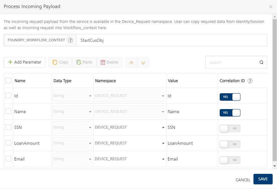

Start – It is an event that represents where the workflow starts. The Start event has one outgoing flow.
IMPORTANT: For Integration Service triggered workflow > Sync, the Process Incoming Payload configuration is a mandatory, in the Start node. Refer to Start node for Integration Service workflow > Sync.
IMPORTANT: For Integration Service triggered workflow > Async, the Process Incoming Payload along with the Correlation ID configuration is a mandatory, in the Start node. Refer to Start node for Integration Service workflow > Async.

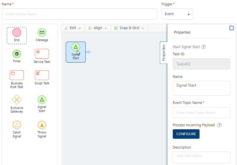

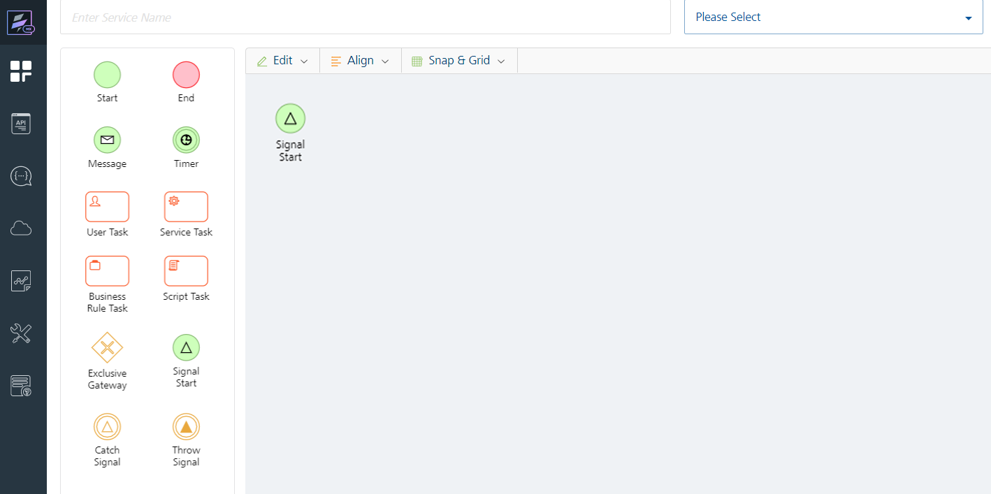

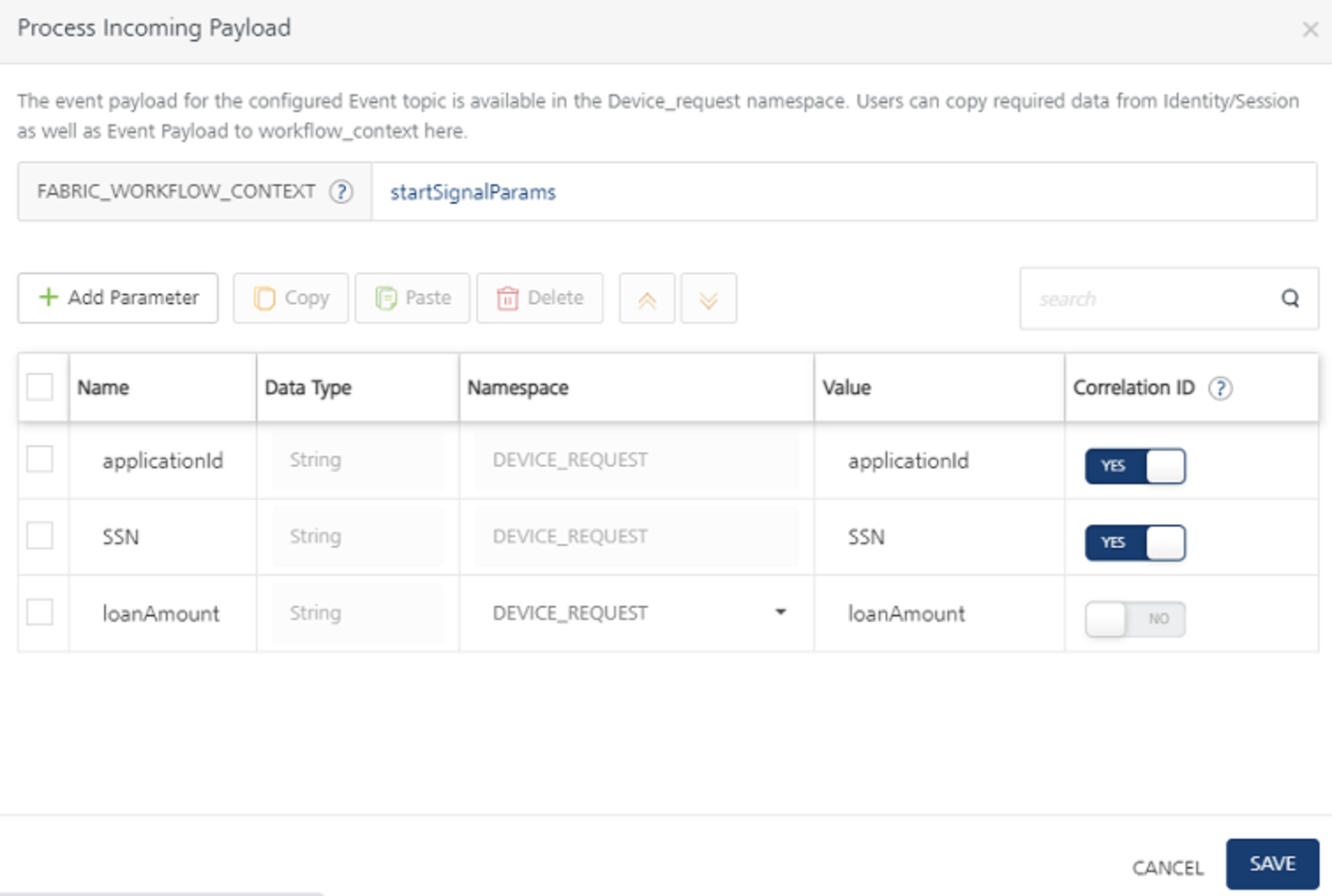

Signal Start - Start Signal node is used to start a workflow based on listening to an Event on Foundry bus.

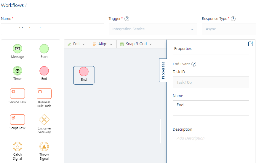

End – It is an event that represents the end of a workflow.

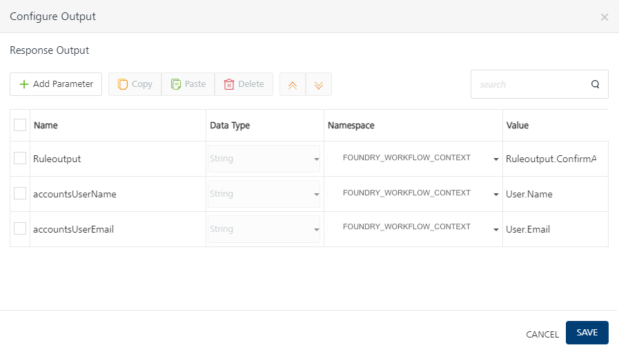

IMPORTANT: For Integration Service triggered workflow > Sync, the Response Output configuration is a mandatory, in the End node. Refer to End node for Integration Service workflow > Sync.
IMPORTANT: End event that represents the end of an Async workflow.
Refer to End node for Integration Service workflow > Async.

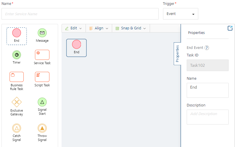

Event Triggered workflow:
  1. Click Configure New from the Workflow landing page, the Configure new screen appears.
  2. In the Name field, type a unique name for the new Workflow service.
  3. Select the Event from the Trigger list if you want to design an Event triggered workflow type.
    Note: A workflow should begin with a Signal Start event and finish with an End event for Event triggered workflow.

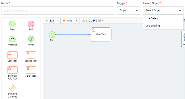

Object Triggered workflow:
You can do the following in the Configure New screen:
  • In the Name field, type a unique name for the new Workflow service.
  • Select the Object from the Trigger list if you want to design an Object linked workflow.
  • From the Linked Object list, select the required object to which you want to link the new Workflow service. The list contains two options:
    • Use Default - It creates a new object service with a default name as per the new Workflow service name and this workflow is linked to that Object. The new object service created will be a storage object service.
    • Use Existing – You can select this option if you want to link the new workflow with any existing object available in the current Foundry app. The linked object service can be a storage object service, RBMS service or an SDO (Integration or Orchestration service) service. If you want to use SDO as linked object, the GetByPK verb is mandatory.
      Note: If you want to use SDO as linked object, the GetByPK verb is mandatory.
      Click Use Existing, and from the Existing Services screen select the required Object service, Object, Field, and then click Add. The new Workflow is linked to an existing Object service.
      Note: Make sure that you designate a Field or create a new Field in the required object to store the workflow state if you want to use an existing workflow. For more information, refer to Object Services.
  • From the Nodes pane, double click on required nodes and drag and drop them on the canvas area. To know more about the activities that you need to perform for each node type, refer to Nodes.
    Note: A workflow should begin with a Start event and finish with an End event for Object linked workflow.

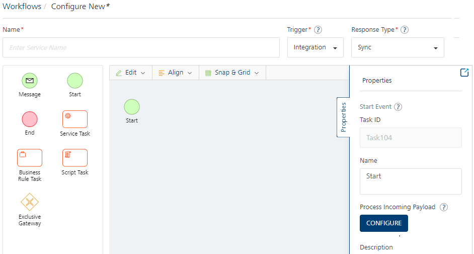

  1. Create the workflow service trigger type Integration Service:
    3. Select the Integration from the Trigger list if you want to design an Integration Service triggered workflow type.
    4. From the Response Type list, select the response type to which you want to create the new Workflow service.
      Note: A workflow should begin with a Start event and finish with an End event for Integration Service triggered workflow.

Signal Start
Signal Start node is used to start a workflow based on listening to an Event on Foundry bus. An Event triggered workflow always begins with a Signal Start node. The Signal Event's property pane contains the following fields:
  • Task ID: A task ID is automatically allotted to the Signal Start Event in the canvas area. You cannot edit this field.
  • Name: Displays the name of the node. Modify it as per the activity the node performs.
  • Event Topic Name: Type the topic name of the event of Foundry. An event topic name is mapped to the Signal Start event.
    Important: An event Topic name is mandatory for the Signal Start event.
  • Process Incoming Payload: You can use this mapping editor to copy data from incoming Event payload into Fabric_workflow_context.
    • You can copy identity/session scope variables to workflow_context in this mapping editor.
    • Payload of the incoming event is copied and available in DEVICE_REQUEST scope. You can also set params from the Event Payload as Correlation ID.
      A Correlation ID can only be set on DEVICE_REQUEST parameters. Correlation ID is required to uniquely identify a workflow instance to start or resume. You can map Correlation ID to any parameter from the Event payload that is available in the DEVICE_REQUEST namespace.
  • Description: You can write description for this node.

For Sync
Start Event (Sync Workflow)
The Start Event’s property pane contains the following fields:
  • Task ID: A task ID is automatically allotted to the Start and End Event when you drag and drop them in the canvas area. You cannot edit this field.
  • Process Incoming Payload: You can use this mapping editor to copy data from incoming request payload into Fabric_workflow_context.
    For more information on using the best practices for workflow, refer to Workflow Best Practices.
    Refer to Namespaces.
End Event (Sync Workflow)
The End Event’s property pane contains the following fields:
  • Task ID: A task ID is automatically allotted to the End Event when you drag and drop them in the canvas area. You cannot edit this field.
  • Configure Output: The End node of Sync workflow will have output response mapper that will get sent back to client via the Integration service response.
    Click Configure Output to configure response output parameters for the End node of the Sync workflow such as , name, data type, namespace, and value.

Start Event (for Async Workflow)
  • Process Incoming Payload: You can use the Process Incoming Payload mapping editor to copy data from incoming request payload as well as identity/session scope variables into FABRIC_WORKFLOW_CONTEXT for further processing in the workflow.
    Note: When a workflow needs any kind of attributes from an IDENTITY or SESSION scope, always try to populate the necessary data from all these scopes to FABRIC_WORKFLOW_CONTEXT and use these values from FABRIC_WORKFLOW_CONTEXT.
    • Correlation ID is required to uniquely identify a workflow instance to start or resume. You can map Correlation ID to any parameter from the Event payload that is available in the DEVICE_REQUEST namespace.
End Event (for Async Workflow)

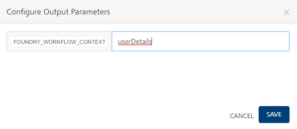

  • Click Configure under Output Parameters to manage the output response parameters.
    The Configure Output Parameters screen appears.
    The output parameters are copied into a single variable under namespace (FABRIC_WORKFLOW_CONTEXT) as JSON. Individual elements of the output can be accessed by using a dot(.) notation with a key.
    For example, assume your output {"name":"John", "age":30, "car":null } is stored in Variable Profile under FABRIC_WORKFLOW_CONTEXT.Profile, you can access age by using FABRIC_WORKFLOW_CONTEXT.Profile.age.
    For more details, refer to Advanced Configuration > Enable Looping.

End Event

    Finally after the loop completes, the individual user data from each integration service execution is combined into the configured output param.
    Output Parameters:
    Final Response in FABRIC_WORKFLOW_CONTEXT:
        "usersDetails":[
    { "id":"123", "firstName":"John", "lastName":"Matthew", "isActive":true }, { "id":"234", "firstName":"James", "lastName":"Smith", "isActive":false } ] }

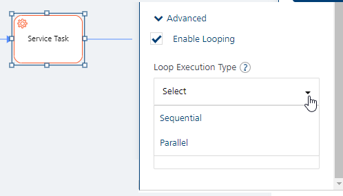

Enable Looping
From V9SP4, support for the Looping feature is available for Service tasks, Script tasks, and Business Rule tasks.
Looping allows invoking a service for a collection of items and combining all the invoked responses.
You can choose the Looping feature to specify if the task is looped Sequentially or Parallelly. For a use case where for each input value, the associated service must be processed in order, you can choose Sequential looping.
For other scenarios, you can choose Parallel to execute each input value simultaneously. For example, for a use case where Account details are fetched for a set of user IDs, a Parallel execution type can be used. This would run the associated services in parallel, independently for each user ID.
How to enable looping for Workflow services:
  1. Create a Workflow service.
  2. Select a Service task, Script task, or Business Rule Task node.
  3. Click the Properties pane to expand it.
  4. Configure Service Type, Linked services and Operations.
  5. While configuring the Input Parameters, configure the LOOP_INPUT_VAR namespace.
    For Looping, two namespaces are introduced: LOOP_INPUT_VAR and LOOP_OUTPUT_VAR. These namespaces are visible only when Looping is enabled. Refer to Namespaces for more details.
  6. Go to the Advanced section in the Properties pane.
    You can enable Looping from the node's context menu. Right-click the node and then select Parallel or Sequential.
  7. Select the Enable Looping check box.
    The Loop Execution Type list appears. This specifies if the task must be looped Sequentially or Parallelly. For each input value, if the associated service must be processed in order, you can choose Sequential. Otherwise, choose Parallel to execute simultaneously.
  8. Select the Sequential or the Parallel option from the Loop Execution Type list.

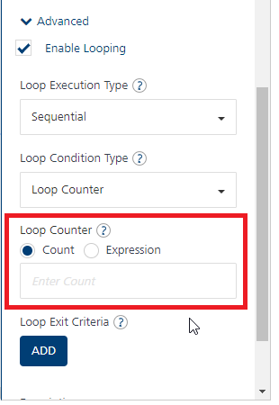

    After you select the Loop Execution Type option, the Loop Condition Type list appears: This helps the Workflow Engine to decide on how to loop a particular task. The list provides two options: Loop Counter and Loop Collection.
    These options define how many times the loop executes.
  9. Select one of the options from the Loop Condition Type list:
    • The Loop Counter option indicates that the task is iterated based on the specified count. The Loop counter expects a static number or an expression, which is evaluated at runtime.
      If you select Loop Counter from the Loop Condition Type list, the Count and Expression options are displayed:
      Configure one of the following:
      • Count: Select the option and specify the number of iterations as a numeric value.
      • Expression: Select the option and specify the number of iterations as evaluated from the provided expression.
        The Expression can be configured by using any Workflow namespace.

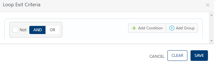

  10. This step is required If you have selected Sequential Loop. Configure Loop Exit Criteria to specify a condition that (if met) will break the execution out of the loop and proceed to the next workflow step.
    Loop Exit Criteria: If you want to break the loop based on certain conditions, you can use the Loop Exit Criteria.For example, if you want an additional validation where you want to execute the task if minimum balance in the account is 10,000, then you can configure a logical expression such as BACKEND_RESPONSE.balance >=10,000.
    To create an expression, follow these steps:
    • Click ADD. The Loop Exit Criteria dialog appears.
    • Click Add Condition to configure a logical expression. You can also click Add Group and configure a group that can have multiple logical expressions within it.
    • Each condition or group is associated with a logical operator (AND, OR). Select the required operator to determine the logic to execute the condition or group. If you select the Not check box, the selected condition is inverted.
    • Select the namespace from the list, and then add the related parameter in the Value field. For example, if you select BACKEND_RESPONSE from the namespace list, and add balance in the Value field, it would be read as BACKEND_RESPONSE.balance.
    • Select a comparison. The available options are ==, == null, >, <, !=, != null, >=, < =. For example, >=
    • Select the namespace from the list, and then add the related parameter in the Value field. For example, you can select none from the namespace list, and add 10,000 in the Value field.
      Now based on the example, the complete condition will be read as BACKEND_RESPONSE.balance >=10,000
    • For Looping, two Name spaces are introduced: LOOP_INPUT_VAR and LOOP_OUTPUT_VAR.
    • Click SAVE.

Manage Workflows
You can manage the details of a service from the Contextual menu available adjacent to each service. The following options are available in the Contextual Menu:
  • Edit – Click to edit the details of a selected service. After you edit a service, save and republish all the apps that use this service to apply the changes.
  • Clone - Duplicates an existing service. Clone a service to create a different version of the same service. Changes made to a cloned service will not affect the original service. The name of a cloned service indicates that it is a copy of an existing service. You can edit the name of a cloned service.
  • Unlink From App - Use this option to unlink the required workflow from the linked Foundry app.
  • Unlink from Associated Object - Use this option to unlink the required workflow from the linked object of the Object service.
    Note: This option is disabled for event triggered workflow services.
  • Delete - Deletes a selected Workflow from Foundry Console. You cannot delete a service if the service is in use. You must do the following to delete the service:
    • Unpublish the foundry app.
    • Unlink the linked Object.
    • Unlink the service with the Foundry app.
    • Navigate to API Management > Workflow and delete the service from there.
    When you delete a service that has multiple versions, only the active version is deleted.
  • Console Access Control – You can manage the users who can access this service from here. To know more, refer to Console Access Control.
  • Export as XML - Exports the current version of a service in the form of an XML file.
  • Export – Exports the service details in the form of a zip file. You can import this zip file to another Foundry app and use it. For more information, refer to Export and Import an Application.
Note: To view the Usecase related to Object Triggered Workflow and the implementation of the Usecase, refer to Object Triggered Workflow Implementation.
Note: To view the Usecase related to Event Triggeed Workflow and the implementation of the Usecase, refer to Event Triggered Workflow Implementation.
Note: To view the execution status of a workflow service by using App Services Console, refer to App Services Console > Workflow Services section.
