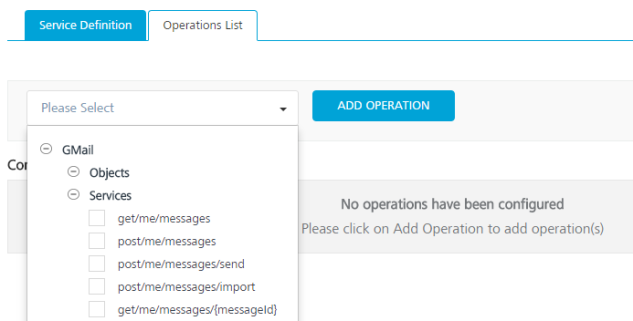

  2. Under Operations List tab, Please Select drop-down lists all the supported operations based on the uploaded RAML file..
    1. Expand an operation.
    2. Under Objects and Services, select the required check boxes.
  3. Click ADD OPERATION. The system adds your operation to the Operations List page.
