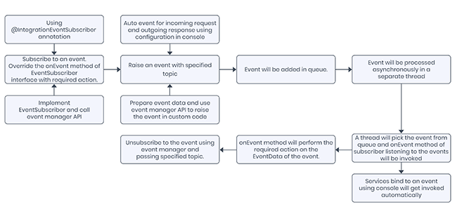

Server Events Processing
To process an event, you have to create a Subscriber. You can do it multiple ways like by using an Annotation or through custom java API or by binding a service using Volt MX Foundry Console to act as a subscriber. When an event is raised, the Subscriber listening to it will get the event data. There are two ways to raise an event which are through Auto Event or through Java API.
This event will be added to the memory queue in Volt MX Foundry. A separate thread runs in Volt MX Foundry which will pick the event from the queue and notify the subscribers listening to the specified topic.

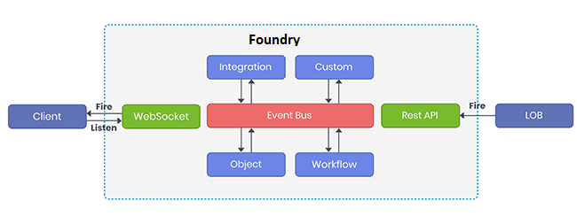

Event Bus - It acts as a message broker which stores and routes the event data from Publishers to Subscribers.
Create a Server-Side Event
Events can be created (i.e. “raised” or “fired”) as part of a service invocation or from custom business logic. Volt MX Foundry support auto creation and fire of events for incoming request and outgoing response of a service. User can also bind a service to one or more events with specified topics. Custom business logic can subscribe/unsubscribe/raise an event using exposed APIs.
Volt MX Foundry exposes a WebSocket end point to subscribe/unsubscribe/raise an event from an external client. Volt MX Foundry also exposed a HTTP end point to fire an event from any external client. . Once the event is created, the service or business logic will finish executing it. Another service or custom business logic should be configured to handle that event and perform the desired action and this work will be executed in a different process on the server asynchronously.

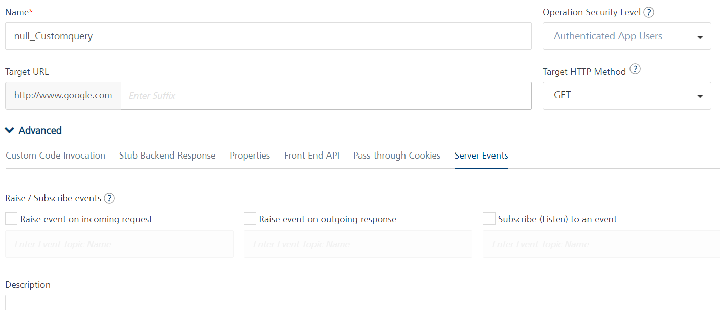

Create an Event from any Service
Create event on incoming request: To create the server-side event on the inbound request, in the Advanced settings tab of an operation, click the Server Events tab and then select the Raise event on incoming request checkbox. Provide the name of the event that describes the data or purpose of the event in the related Enter Event Topic Name box. The event will include the payload of the incoming request and default parameters like service id, operation id, object id, service version, headers, query parameters and more. You can provide semi-colon separated multiple event topic name.
Create event on outgoing response: To create the server-side event on the outbound response, in the Advanced settings tab of an operation, click the Server Events tab and then select the Create event on outgoing response checkbox. Provide the name of the event that describes the data or purpose of the event in the Enter Event Topic Name box. The event will include the payload of the outgoing response payload and default parameters like service id, operation id, object id, service version, headers, query parameters and more. You can provide semi-colon separated multiple event topic name.
Other services can listen to this event with the help of the given Topic name. Whenever this service is invoked, an Event is raised and subscribers to this Topic will get the relevant event data. You can also provide the Topic name in Parent topic and Child topic name format. When a service subscribes to the parent topic, the event data of all the child topics is sent to the subscriber. If you subscribe to any child topic, the event data related only to the subscribed child topic is sent to the subscriber. Use “/” as a separator for parent and child topic name.
For example, Parent service name can be “transaction” and its child can be “transaction/credit” and “transaction/debit”.

Handling Server Side Events
Once an event is created, a service or custom business logic is configured to handle that event. The execution of the event handler occurs asynchronously in a separate thread. If the event is handled by a service, the event payload is passed as the request to the service similar to a client invoking the service as a REST API. If the event is handled by custom code, the event payload is passed into the custom logic as part of the event data.
Handle Events from Service
Subscribe (Listen) to an event: To bind the service to an event of specified topic, in the Advanced settings tab of an operation, click the Server Events tab and then select the Subscribe (Listen) to an event checkbox. The service will be invoked whenever the subscribed event is triggered with the specified topic. Type the name of the event in the related Enter Event Topic Name box. You can provide semi-colon separated multiple event topic name.
Handle Event from Custom Logic:
APIs
  • EventSubscriber: This class provides mechanism for receiving notification from notifier and perform the required actions. User can implement this class in their custom code. This class contains the following API:
    • onEvent: Receives notification when any event of the subscribed topic is triggered. Make sure that this API is thread-safe as multiple threads can call this API simultaneously.
Note: Refer to the Foundry Queue Service java document for more information on Foundry Queue Service APIs.

WebSocket endpoint for events (/ServerEvents/Stream)
A WebSocket supports bi-directional communication between a client and a server. With VoltMX Foundry, a client app can connect to a WebSocket, and then subscribe and unsubscribe from events to the server. For more information about the client-side APIs, refer to Server Event APIs.
Note: A client device can only subscribe and unsubscribe from events that are configured on the Throw Signal node in Workflows. To subscribe to an event from a client device, the event type must be Client Only.
After a connection is established between a client and a WebSocket, the server sends a ping to the client every 30 seconds. If the client responds to the server ping, the WebSocket session continues to run. If the client closes the connection, or if the client does not respond after three pings, the WebSocket session is terminated.
