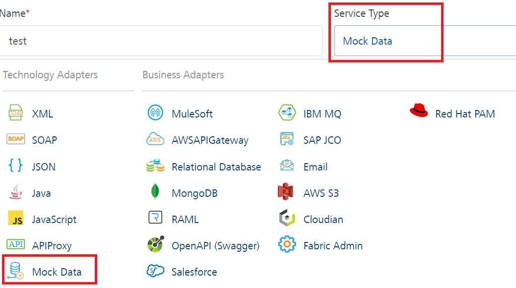

To configure your Mock Data Adapter, provide the following details:
  1. In the Name field, provide a unique name for your service.
  2. From the Service Type list, select Mock Data.

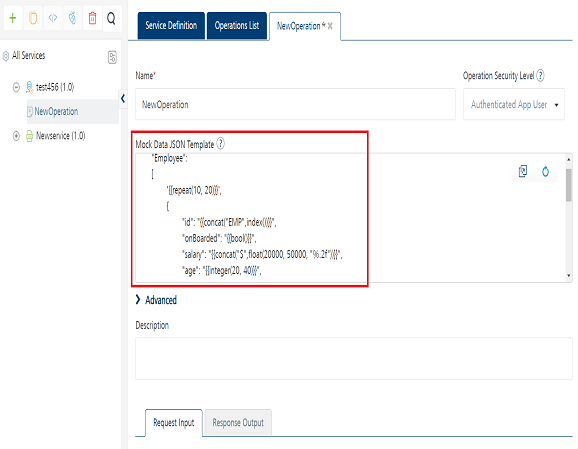

  1. Configure your Mock data template in the Mock Data JSON Template text field. By default this field is enabled with a sample mock response template.
    Note: For more information on Pre-built functions supported in Mock Data template, refer Mock Data Template and Supported Pre-built functions in Mock Data
