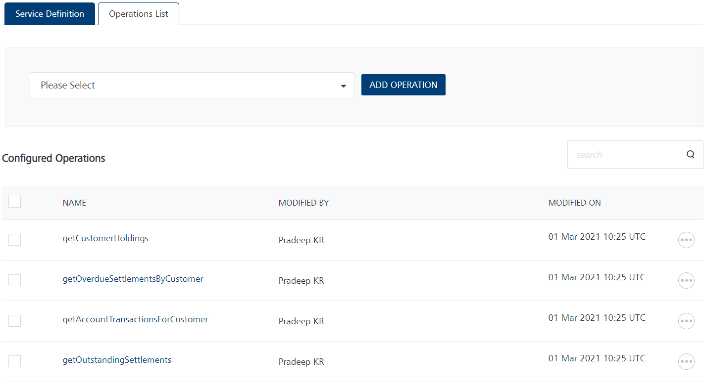

Creating Operations for OpenAPI (Swagger)
After you create a service, you can view the existing operations and also create operations on the Operations List tab. For an OpenAPI endpoint, the operations are the paths that are defined in the Swagger file, for example: addPet or updatePet.
To create an operation, follow these steps:

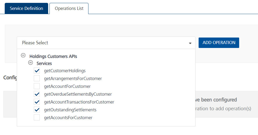

  1. From the Service Definition page, switch to the Operations List tab.
    Alternatively, click the plus (+) icon on the left pane, and then click Add New Operation.
  2. On the Operations List tab, from the drop-down list, select the operations that you want to add to the service.
    When you select a path (operation), all the corresponding fields of the operation are populated.
  3. After you select the operations, click ADD OPERATION. Foundry adds the selected operations to the Operations List tab.

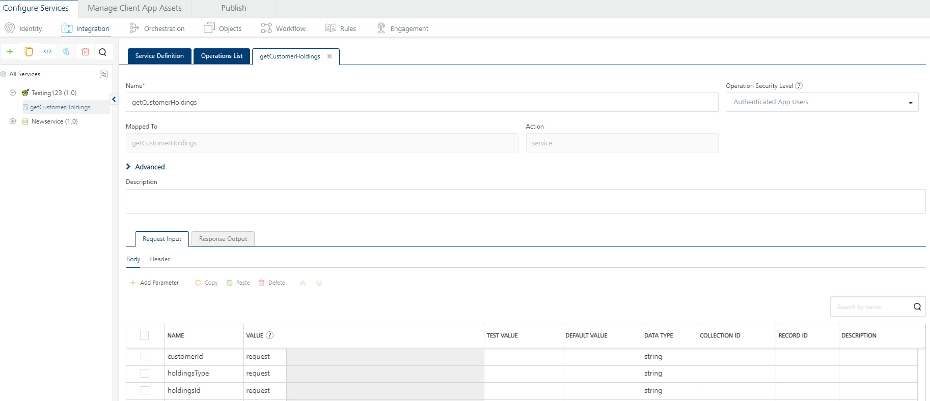

  4. Under Configured Operations, click an operation to view the details of the operation.
  5. Foundry displays the selected operation in the edit mode. You can configure the parameters to update the operation. For more information, refer to the following table.

Configuring Request Parameters
The request input parameters are picked from the uploaded OpenAPI specification file. Any changes that are made to the parameters from the console are ignored.
Important: Make sure that the input parameters are form-url-encoded.
To create a new parameter on the Request Input tab, follow these steps:
  1. On the Body tab, click Add Parameter. A new row is added to the table of parameters.
  2. Configure the fields (columns) for the input parameter. For more information, refer to the following table.
    Field Description
    Name Specifies a unique identifier for the parameter. The name is the key of the parameter in the request.
    VALUE Specifies the source of the value of the parameter. Contains the following options.requestThe value is picked from the configuration of the request parameter. If you select request as the source, you need to configure the TEST VALUE and DEFAULT VALUE fields.sessionThe value is picked from the session context. If you select session as the source, the TEST VALUE and DEFAULT VALUE fields are disabled.constantThe value is a constant that is defined on the Foundry console. If you select constant as the source, you need to type a value for the parameter.identityThe value is picked from the response that is sent by the specified identity provider. If you select identity as the source, you need to configure the provider, attribute, and value. For example: sampleAuth.profile.userID
    Note: For more information on Externalizing Identity Services, refer to Replace the Identity Service references in a Foundry app.
    TEST VALUE Specifies the value of the parameter that is used while testing the service.
    DEFAULT VALUE Specifies the value of the parameter that is used if the test value is empty.
    DATA TYPE Specifies the data type of the parameter. Contains the following options:stringA combination of alpha-numeric and special characters. Supports all formats (including UTF-8 and UTF-16) with no maximum size limit.booleanA value that can be true or false.numberAn integer or a floating point number.dateA value that contains the day, month, year, and time.collectionA set of multiple records.recordA set of multiple objects.> Note: The binary data type is not supported for operations in OpenAPI (Swagger).
    Record ID Specifies the ID of the record that contains the parameter. This field is applicable for nested payloads.
    Collection ID Specifies the ID of the collection that contains the parameter. This field is applicable for nested payloads.
    Description Specifies the description for the request parameter.
