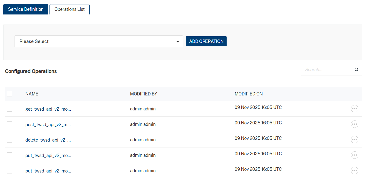

Creating Operations for HCL Universal Orchestrator
After you create a service, you can view existing operations and create new ones on the Operations List tab. For an HCL Universal Orchestrator endpoint, the operations correspond to the paths defined in the specification file (for example, POST AI Agent model or PUT AI Agent model).
To create an operation, follow these steps:

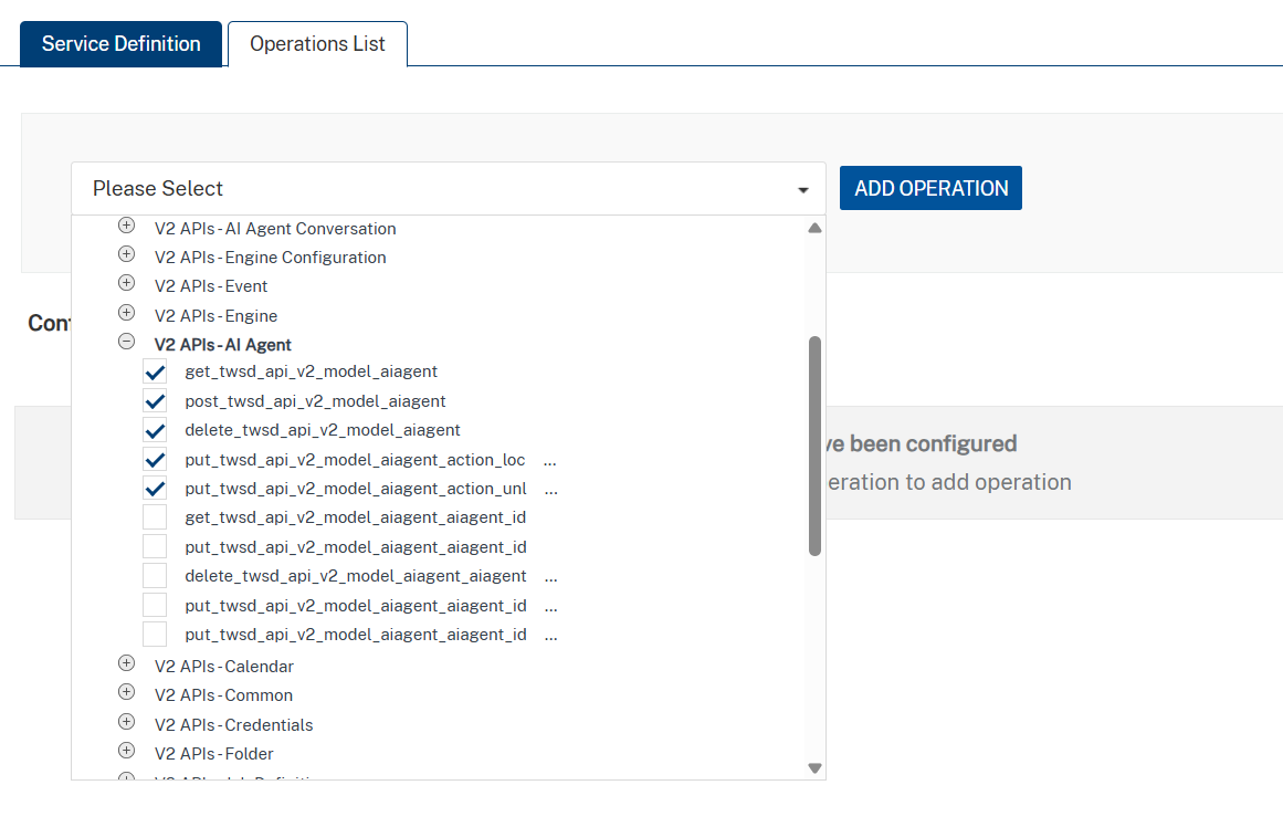

  1. On the Service Definition page, open the Operations List tab. Alternatively, click the + icon in the left pane, and then select Add New Operation.
  2. On the Operations List tab, select the operations you want to add from the drop-down list. When you select a path (operation), Volt Foundry automatically populates all the fields associated with that operation.
  3. After you select the operations, click ADD OPERATION. Volt Foundry adds the selected operations to the Operations List tab.

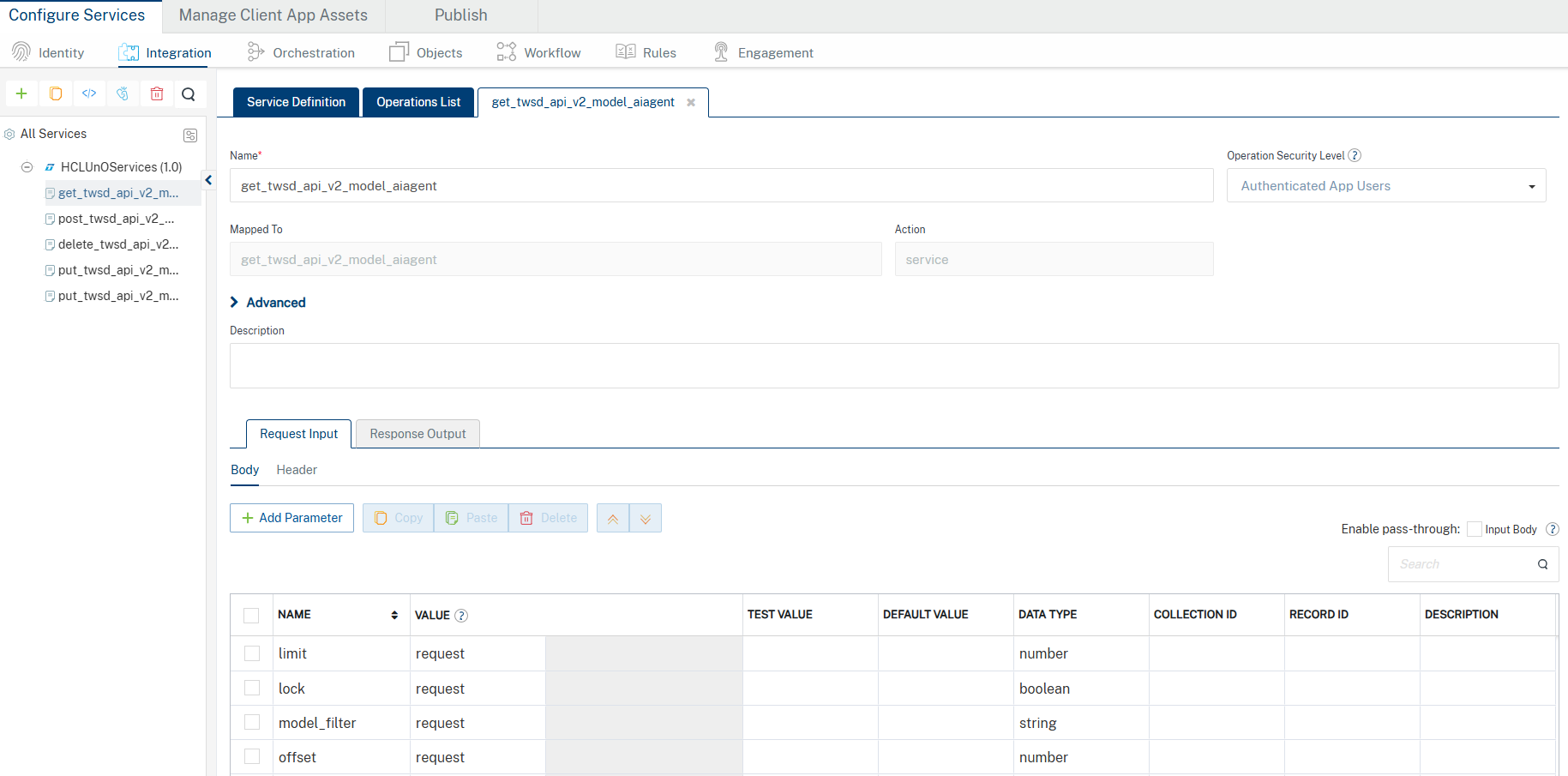

  4. Under Configured Operations, click an operation to view its details.
    Volt Foundry displays the selected operation in edit mode. You can configure the parameters to update the operation. For more information, see the following table.
    Field Description
    Name Specifies the name that Foundry uses to identify the operation on the console.
    Operation Security Level Specifies the authentication that is required to invoke the operation. Contains the following options: Authenticated App User – It restricts the access to clients who have successfully authenticated using an Identity Service associated with the app. Anonymous App User – It allows the access from trusted clients that have the required App Key and App Secret. Authentication through an Identity Service is not required. Public – It allows any client to invoke this operation without any authentication. This setting does not provide any security to invoke this operation and you should avoid this authentication type if possible. Private - It blocks the access to this operation from any external client. It allows invocation either from an Orchestration/Object Service, or from the custom code in the same run-time environment.
    Description Specifies the description of the service that is displayed on the console.

Configuring Request Parameters
Volt Foundry picks the request input parameters from the uploaded HCL Universal Orchestrator specification file. Any changes you make to the parameters from the console are ignored.
Important: Ensure that the input parameters are form-url-encoded.
To create a new parameter on the Request Input tab, follow these steps:
  1. On the Body tab, click Add Parameter.
    Volt Foundry adds a new row to the parameters table.
  2. Configure the fields (columns) for the input parameter. For more information, see the following table.
    Field Description
    Name Specifies a unique identifier for the parameter. The name is the key of the parameter in the request.
    VALUE Specifies the source of the value of the parameter. Contains the following options. request The value is picked from the configuration of the request parameter. If you select request as the source, you need to configure the TEST VALUE and DEFAULT VALUE fields. session The value is picked from the session context. If you select session as the source, the TEST VALUE and DEFAULT VALUE fields are disabled. constant The value is a constant that is defined on the Foundry console. If you select constant as the source, you need to type a value for the parameter. identity The value is picked from the response that is sent by the specified identity provider. If you select identity as the source, you need to configure the provider, attribute, and value. For example: sampleAuth.profile.userID
    Note: For more information on Externalizing Identity Services, refer to Replace the Identity Service references in a Foundry app.
    TEST VALUE Specifies the value of the parameter that is used while testing the service.
    DEFAULT VALUE Specifies the value of the parameter that is used if the test value is empty.
    DATA TYPE Specifies the data type of the parameter. Contains the following options: string A combination of alpha-numeric and special characters. Supports all formats (including UTF-8 and UTF-16) with no maximum size limit. boolean A value that can be true or false. number An integer or a floating point number. date A value that contains the day, month, year, and time. collection A set of multiple records. record A set of multiple objects. > Note: The binary data type is not supported for operations in HCL Universal Orchestrator.
    Record ID Specifies the ID of the record that contains the parameter. This field is applicable for nested payloads.
    Collection ID Specifies the ID of the collection that contains the parameter. This field is applicable for nested payloads.
    Description Specifies the description for the request parameter.
  3. After you configure all parameters, validate the details by testing the service operation. For more information, see the Test a Service Operation.
