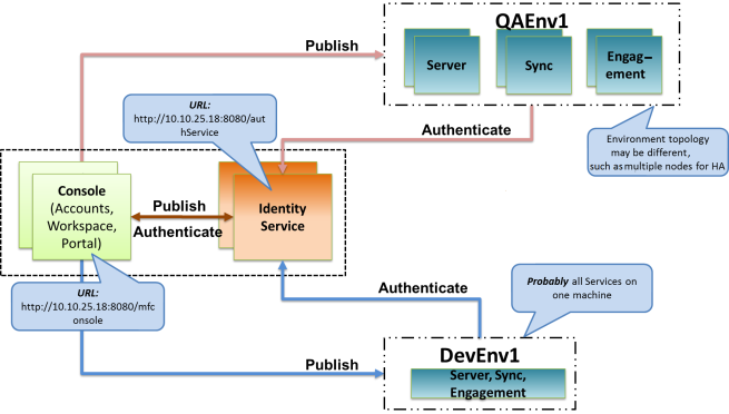

Scenario 1 – Promoting an app from the local development environment to local QA environment every night
There is one Volt MX Foundry Console connected to two environments – DevEnv1 and QAEnv1.  The following image shows the Volt MX Foundry topology:
Using the preceding topology to promote the MoBoApp from DevEnv1 to QAEnv1 every night, a user can do the following:
 java -jar mfcli.jar Publish -u ciuser@moboco.com -p ciuserpwd -e QAEnv1 -a MoBoApp -au http://10.10.25.18:8080 -cu http://10.10.25.18:8080
Here, ciuser@moboco.com is the user with password ciuserpwd. The user's account helps to promote the MoBoApp to QAEnv1. Identity (Auth) Service and Console are running on http://10.10.25.18:8080. You can also encrypt the password before exporting an app.
Note: The publish command could be used to publish a new application or to overwrite an existing application.

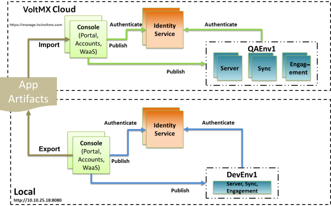

Scenario 2 – Promoting an app from the local development environment to QA environment running on Volt MX Cloud every night
This case is more complex. Developers are working against a local environment (DevEnv1), but QA is testing through an environment in Volt MX Cloud (QAEnv1). There are two MF Consoles. The example is a hybrid scenario of on-premise and the cloud. The following image shows the Volt MX Foundry topology:
In this example, a user needs to perform the following four steps:
  1. Encrypt the password of a user who needs to promote the MoBoApp  to  QAEnv1account.
  2. Export the app from DevEnv1 (as a .zip file).
  3. Import the app (as a .zip file) into Volt MX Cloud account.
  4. Publish the app to QAEnv1.

  2. Export the app from DevEnv1 (as a zip file)
    To export the app, a user must run the following command.
    java -jar mfcli.jar Export -u ciuser@moboco.com -p encrypted_password -a MoBoApp –f .\MoBoApp.zip -au http://10.10.25.18:8080 -cu http://10.10.25.18:8080.
    In the scenario, ciuser@moboco.com is the user with password  encrypted_password. The user's account helps to export the MoBoApp as MoBoApp.zip. The Identity (Auth) Services and console are running on http://10.10.25.18:8080.
    The following is an example of how the export command is used: To export an application from an on premise installation -
    java -jar mfcli.jar Export -u [user] -p [encrypted_password] -a [app name] -f [file name] -au [Identity URL] -cu [Console URL]
  3. Import the app (as a zip file) into Volt MX Cloud Account
    java -jar mfcli.jar Import -u ciuser@moboco.com -p encrypted_password -a MoBoApp –f .\MoBoApp.zip –t 100054321
    In the example, ciuser@moboco.com is the user with encrypted_password. The user's account helps to import the MoBoApp from MoBoApp.zip.
    Note: Since no URL is provided for Identity Service and console, it is assumed that the URL is Volt MX Cloud (https://manage.hclvoltmx.com). Since Volt MX Cloud is a multiple tenants (account) service, a user must specify the account ID using –t. The account ID in the preceding example is 100054321.
    Note: In the example, it is assumed a user is trying to overwrite the existing MoBoApp in the account. If this is new application, then do not specify any name with -a option.
    The following is an example of how the import command is used: To import an application to manage.hclvoltmx.com,
    java -jar mfcli.jar import -u <user> -p <password> -t <account id> [-f <file name> | -r <directory name>] [-a <app name>] [-v <app version>] [-ay] [-to <time in secs>]
    java -jar mfcli.jar Publish -u ciuser@moboco.com -p encrypted_password -e QAEnv1 -a MoBoApp –t 100054321
    This method is similar to local publish, except the -t option specifies the account ID.
    The following is an example of how the publish command is used: To publish an application to manage.hclvoltmx.com,
    java -jar mfcli.jar Publish -u [user] -p [encrypted_password] -e [environment name] -a [app name] -t [account id]
    If the end-point URL or any other property is different in QA environment running on Volt MX Cloud, you can use the Application Reconfiguration support to set these properties at one time action in Volt MX Foundry Console. The environment specific properties will automatically get applied every time you publish.
