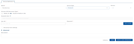

To configure a Mulesoft adapter in Integration Service Definition tab, follow these steps:
- In the Name field, provide a unique name for your service. When you enter the name, the name is updated for the active service under the Services section in the left pane.
From the Service Type list, select Mulesoft.
Note: XML is selected, by default.
Provide the following details to create a SOAP service.
Fields Description Version Select the version for the service. Choose API Discovery Type Click one of the following modes
- RAML File - Select the option and upload RAML file from your local machine. The system adds your RAML file to the console. The system displays the added RAML file's name under the Choose API Discovery Type section.
- AnyPoint Platform URL - Select this option and the system displays the MuleSoft URL in the text box.Under the
User ID and Password, provide valid log-in credentials that you created while registering with
MuleSoft AnyPointPlatform.
Note: You cannot modify the details in AnyPoint Platform URL.
Click Test Login to test the Mulesoft connection details.
For additional configuration of your service definition, provide the following details in the Advanced section.
Field Description Custom code To specify a JAR associated to the service, select one from the Select Existing JAR drop-down menu or click Upload New to add a new JAR file. Make sure that you upload a custom JAR file that is built on the same JDK version used for installing Volt MX Foundry Integration. > Important: Make sure that you upload a custom JAR file that is built on the same JDK version used for installing Volt MX Foundry Integration.For example, if the JDK version on the machine where Volt MX Foundry Integration is installed is 1.6, you must use the same JDK version to build your custom jar files. If the JDK version is different, an unsupported class version error will appear when a service is used from a device.
i) Archives are blocked if JAR contains embedded server-side or executable script files that could execute unsafe code.
Restricted uploads
JAR is blocked if it contains:.sh, .bat, .py, .rb, .php, .pl, .cgi, .cmd, .ps1, .groovy
ii) JAR file names must not contain multiple file extensions. The following extensions are restricted.js, zip, war, apk, ipa, appx, xap, jsp, jspx, sh, bat, py, rb, php, pl, cgi, cmd, ps1, groovy, html, htm, xhtml, xml, json, css, txt, md, csv, svg
iii) The maximum file upload size for on-premises is 4GB.API Throttling If you want to use API throttling in Volt MX Foundry Console, to limit the number of request calls within a minute. do the following: In the Total Rate Limit text box, enter a required value. This will limit the total number of requests processed by this API.In the Rate Limit Per IP field, enter a required value. With this value, you can limit the number of IP address requests configured in your Volt MX Foundry console in terms of Per IP Rate Limit. * To override throttling from Volt MX Foundry App Services Console, refer to Override API Throttling Configuration. > Note: In case of On-premises, the number of nodes in a clustered environment is set by configuring the VOLTMX_SERVER_NUMBER_OF_NODESproperty in the Admin Console. This property indicates the number of nodes configured in the cluster. The default value is 1. Refer to The Runtime Configuration tab on the Settings screen of App Services. The total limit set in the Volt MX Foundry Console will be divided by the number of configured nodes. For example, a throttling limit of 600 requests/minute with three nodes will be calculated to be 200 requests/minute per node. This is applicable for Cloud and On-premises.Use proxy from settings To enable the proxy, select the check box. The Use proxy from settings check box dims when no proxy is configured under the Settings > Proxy.
Note: All options in the Advanced section are optional.
- Enter the Description for the service.
- Click SAVE to save your service definition.

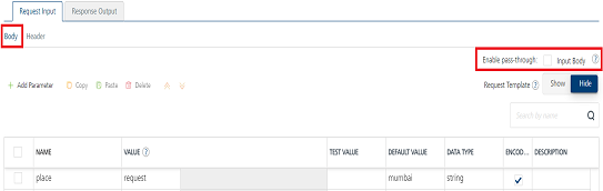

Under the Body tab, perform the following actions:
To forward the body of the client's request to backend as it is, select the Enable pass-through input body check box. For more details on API Proxy service, refer to How to Enable Pass-through Proxy for Operations.
To configure parameters in the clients body, do the following:
Field Description Name Enter the name for the request input parameter.> Note: In the Body tab > NAME field, the input parameters are prepopulated based on the properties of the input schema of a RAML file. Value Three different options are available in Volt MX Foundry under VALUE during configuration of any operation. When you start editing this field, dependent identity services are auto populated. These options primarily determine the source of the value of the header. > Note: The field is set to Request, by default. TEST VALUE Enter a value. A test value is used for testing the service. DEFAULT VALUE Enter the value, if required. The default value will be used if the test value is empty. Scope Select request or session. This field is set to Request, by default.The default datatype for the selected column is loaded under DATATYPE field. Encode Select the checkbox to enable an input parameter to be encoded. For example, the name New York Times would be encoded as New_York_Times when the encoding is set to True. The encoding must also adhere the HTML URL encoding standards. Select request or session or Identity.
* Request: If this option is selected, the Integration Server picks the value pairs from the client's request during run time and forwards the same to the back-end.User has the option to configure the default value. This default value is taken if the request does not have the header. * Session: If this option is selected, the value of header is picked from session context based on the user configuration. * Identity: If this option is selected, you can filter the request parameters based on the response from the identity provider. For more details to configure identity filters, refer to Enhanced Identity Filters - Integration Services.

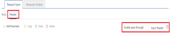

Click the Header tab to provide the following customer headers, perform the following actions:
You must provide the custom HTTP headers based on the operation. For example, post or get.
To configure parameters in the client's header, do the following:
Field Description Name Provide custom HTTP headers required by the external source. Value Three different options are available in Volt MX Foundry under VALUE during configuration of any operation. When you start editing this field, dependent identity services are auto populated. These options primarily determine the source of the value of the header. > Note: The field is set to Request, by default.> Note: If the header value is scoped as a Request (or) Session and the same header is accessed under the Expression header value, then the expression must be represented as $request.header (or) $session.header.Example: If a header 1 value is a request and header 2 value is an expression, then the value of the expression must be $Request.header1.
TEST VALUE Enter a value. A test value is used for testing the service. DEFAULT VALUE Change the syntax, if required. The default value will be used if the test value is empty. SCOPE Select request or session. The field is set to Request, by default. Description Enter the Description for the request input. Select request or session or Identity.

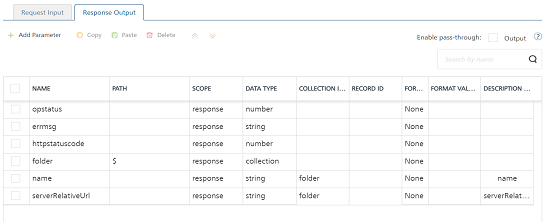

Click the Response Output tab to configure the fields of the table for displaying the data.
Note: If you define parameters inside a record as the session, the session scope will not get reflected for the parameters.
In the Response Output tab, configure the fields of the table for displaying the data:
The Name field in the Response Output tab is prepopulated with the properties of output schema of a RAML file.
Enter the values for required fields such as name, path, scope, data type, collection ID, record ID, format and format value
To validate the details, click Test. You can refer to Test a Service Operation for the steps to test a service. The result of the operation appears.
