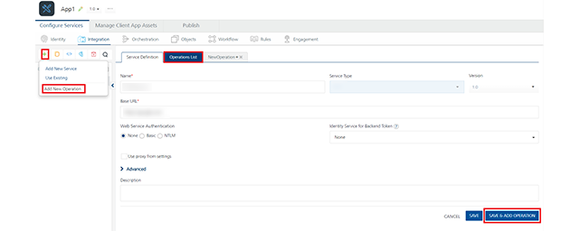

  3. Click ADD OPERATION to display Operations List tab for adding operations to the service.
    Note:  You can also add operations by following these steps:
    -  Click the Operations List tab.
     -  From the tree in the left pane, click Add > Add New Operation, shown below:
    ClosedClick to View image
