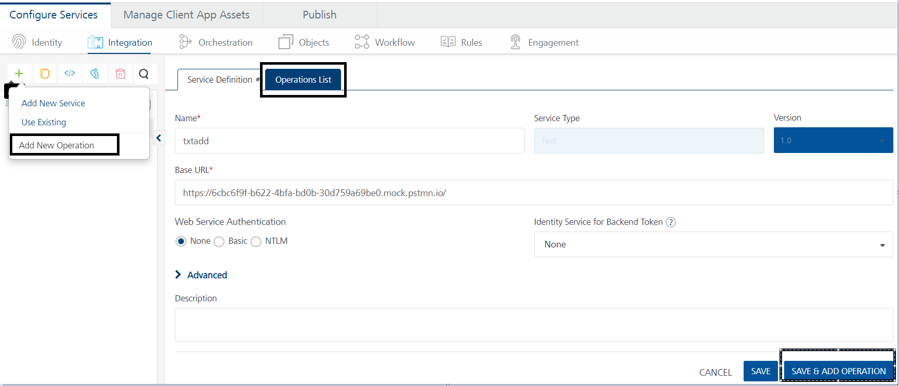

  1. Click SAVE & ADD OPERATION in your service definition page to save your service definition and display the NewOperation tab for adding operations.
    OR
    Click Add Operation to add a new operation or from the tree in the left pane, click Add > Add New Operation.
    Image displayed as below:

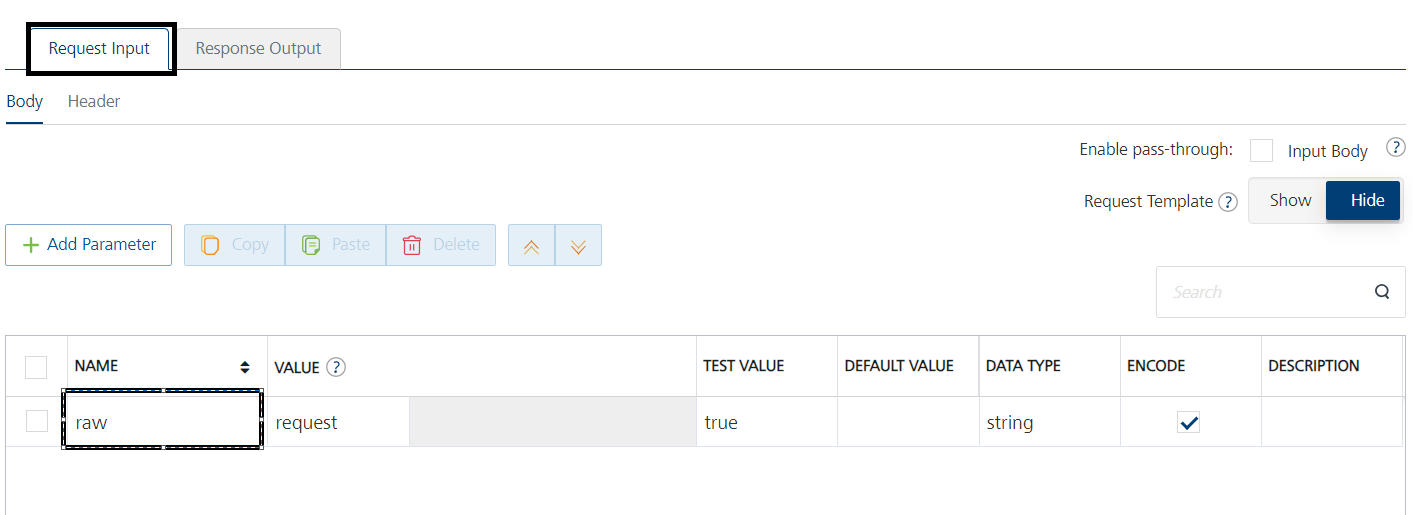

  6. By default, Text Adapter gives JSON response.
  7. To get Raw response need to a Request Input parameter called “raw” under Body tab.
