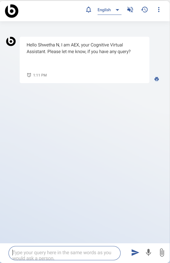

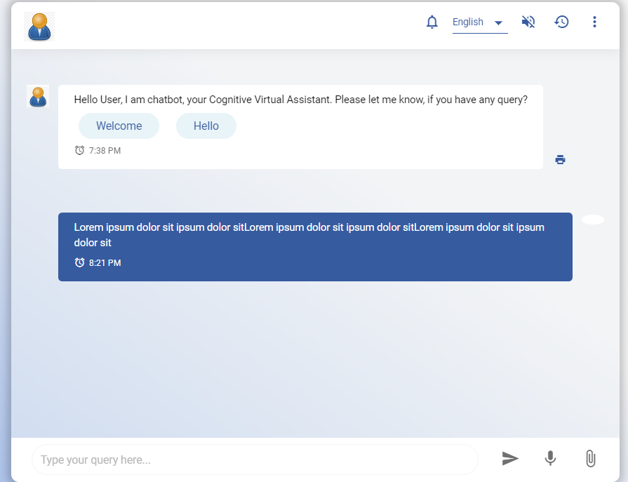

  • Let us look at an example of what you can accomplish using this console. Default Web based Chat UI of BigFix AEX shows the default web-based chat UI of AEX and Customized Web-based Chat UI of BigFix AEX shows the chat UI after making some changes using this console. Later on, in this section, you will see what and how the changes have been made to create the customized UI of Customized Web-based Chat UI of BigFix AEX.
Figure 1. Default Web based Chat UI of BigFix AEX
Figure 2. Customized Web-based Chat UI of BigFix AEX

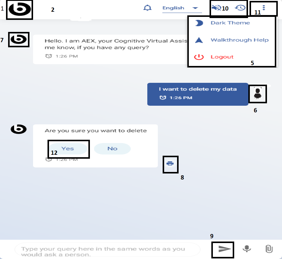

Table - BigFix AEX Web Based Chat UI and BigFix AEX web-based Chat UI explains the structure of AEX web-based Chat UI and what all changes can be done.
Table 1. BigFix AEX Web Based Chat UI
Element Which file is affected Steps to Change it
Favicon Images/ BigFix AEX-icon.png
  1. Go to Upload File Tab.
  2. Fill Path Structure - images.
  3. Browse image and replace BigFix AEX-icon.png by uploading new image.
  4. Make sure the image is of (46px*46px) dimensions.
Background color of the Header css/theme1.css
  1. Go to Text Editor Tab.
  2. Go to the css folder theme1.css.
  3. Go to class called ChatBotHead change background of your choice of color code should be in #, rgb, rgba format.
  4. Click the Save button from actions button on the top bar. An Alert will come to confirm your action. Press OK on alert.
  5. Click the Check button to see your changes on browser.
Change color of the footer This will be same for all the themes.
Add client Icon on bottom right corner. css/theme1.css
  2. Fill Path Structure- images.
  3. Browse image and replace client-icon.png by uploading new image.
  4. Make sure the image is of (35px*35px) dimensions.
Add menu item to the header dropdown
html/index.html
, styles.css and images
  2. Go to the html folder >> index.html.
  3. Go to UL tag under Header tag.Eg.:<ul class="dropdown">.
  4. Add new <li> tag, then add anchor tag and give a class to it within the li tag and then put a text inside the anchor tag which will be displayed on the UI. Eg. <li><a href="#/report" class="report">Report</a></li>.
  5. Put #/pagename in href.
  6. Click the Save button from actions button on the top bar. An alert will come to confirm your action. Press OK on alert.
  7. Click the Check button to see your changes on browser.
  8. Go to the css folder >> styles.css
In styles.css add a class here with the same name which you have given in the anchor tag. Eg.:.hadderBtnList .dropdown li a. report { background: url(/assets/images/report-icon.png) no-repeat 12px center/12px; padding-left: 32px;}
Change default User profile picture images/user-pic.png
  1. Go to Upload File tab.
  3. Browse image and replace user-pic.png by uploading new image.
Change default BigFix AEX profile picture on messages (It will change automatically if you are change the BigFix AEX logo) Images/default-profile-pic.png
  3. Browse image and replace default-profile-pic.png by uploading new image.
Make sure the image is of (48px*48px) dimensions.
Change icon for Print Images/print.svg
  3. Browse image and replace print.svg by uploading new image (support .svg format only).
Change the Send button color
  3. Go to class called ‘. Send-fill’ change background of your choice of color code should be in #, rgb, rgba format.
  4. Click the Save button from actions button on the top bar. An alert will come to confirm your action. Press OK on alert.
Change mic style (changing this will affect mic icon, image upload icon, speak and speak out icon and chat history icon also.) css/theme1.css
  3. Go to class called ‘. fill-icon’ change background of your choice of color code should be in #, rgb, rgba format.
  4. Click the Save button from actions button on the top bar. An alert is triggered to confirm your action. Press OK on alert.
Change Hamburger Menu color css/theme1.css
  3. Go to #hamburger-icon> div.fill-icon div change background of your choice of color, color code should be in #, rgb, rgba format.
Change button/option color: Color for option button will be same for all the themes, we can only change their hover state.
We have other buttons as well. For those buttons, we have to make changes to the following classes:
.option_link:hover, .link-btn:hover, .feedback_option:hover
css/theme1.css
  3. Go to class with hover state called ‘ChatBotBtn:hover’ change background of your choice of color, color code should be in #, rgb, rgba format.
Message time color css/theme1.css
  2. Go to the css folder  theme1.css.
  3. Go to class. ChatBotList li .chatText p.messagetime, Change color of your choice of color, color code should be in #, rgb, rgba format.
Change User Chat Bubble background css/theme1.css
  3. Go to class. Chatbot List. sendChat .chatText div, Change the background color, color code should be in #, rgb, rgba format.
+ Floating Button css/theme1.css
  3. Go to class. plusMinus, change the background color, color code should be in #, rgb, rgba format.
Image upload button and mic button css/theme1.css
  3. Go to class. starBtn, .micBtn, .imageBtn, change the background color, color code should be in #, rgb, rgba format.
Scroll to bottom button color css/theme1.css
  3. Go to class. down_arrow change the color of your choice of color, color code should be in #, rgb, rgba format.
Change color of Title of pages like: Chat History, Conversation History, Themes css/theme1.css
  3. Go to class. profile-name change the color of your choice color, color code should be in #, rgb, rgba format.
Background Heading of the page css/theme1.css
  2. Go to the css folder à theme1.css.
  3. Go to class. heading-container change background and border and color of your choice of your choice of color, color code should be in #, rgb, rgba format.
Back button on heading of the page css/theme1.css
  3. Go to class. heading-container. back change the color of your choice r, color code should be in #, rgb, rgba format.
Color of conversation name on conversation history page css/theme1.css
  3. Go to class. con names change the color of your choice, color code should be in #, rgb, rgba format.
Theme buttons (Color for option button will be same for all the themes, we can only change their hover state.) css/theme1.css
  3. Go to class. buttons button:hover, .buttons a:hover change the color of your choice , color code should be in #, rgb, rgba format.
Theme Thumbnail Images
  1. Go to the chat page on the browser, take a screenshot of the new theme, save it as theme1.jpg.
  2. Make sure the image is of (243px*250px) dimensions.
  3. Go to Upload File Tab.
  4. Fill Path Structure- images.
  5. Browse image and replace theme1.jpg by uploading new image.
Theme name html/ChangeTheme.html
  2. Go to the html folder  changeTheme.html.
  3. Go to <img src="/assets/images/theme1.jpg".
  4. Change the alt tag with New Theme Name of your choice.
  5. Then go to <p class="theme-name"> New Theme Name </p>.
Theme swatch color css/theme1.css
  3. Go to class. theme p: before change the background color, color code should be in #, rgb, rgba format.
The above change will reflect on Theme1.css and after making above changes new theme will be our default theme. Please refer to the screenshot below for better understanding of the above points.
Figure 3. BigFix AEX web-based Chat UI

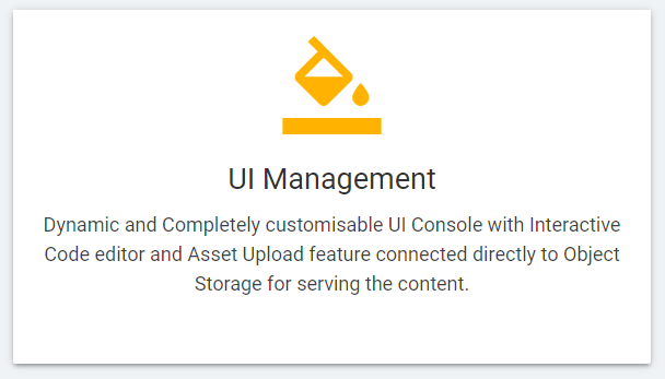

  1. On the Cognitive Console home page, click the UI Management module.
    Figure 4. UI Management Console Link on the Cognitive Console of BigFix AEX

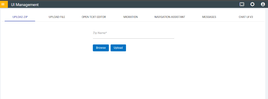

    Figure 5. UI Management Console Home Page
  3. The UI Management Console has the following tabs:
    • Open Text Editor - Make real-time changes to the code online without downloading and opening a file on a desktop code editor.
    • Upload File - Upload individual files to update changes in the selected files.
      Only html, image, css, or font file can be uploaded.
    • Upload Zip - Upload a zipped collection of files in a batch instead of uploading each file individually.
