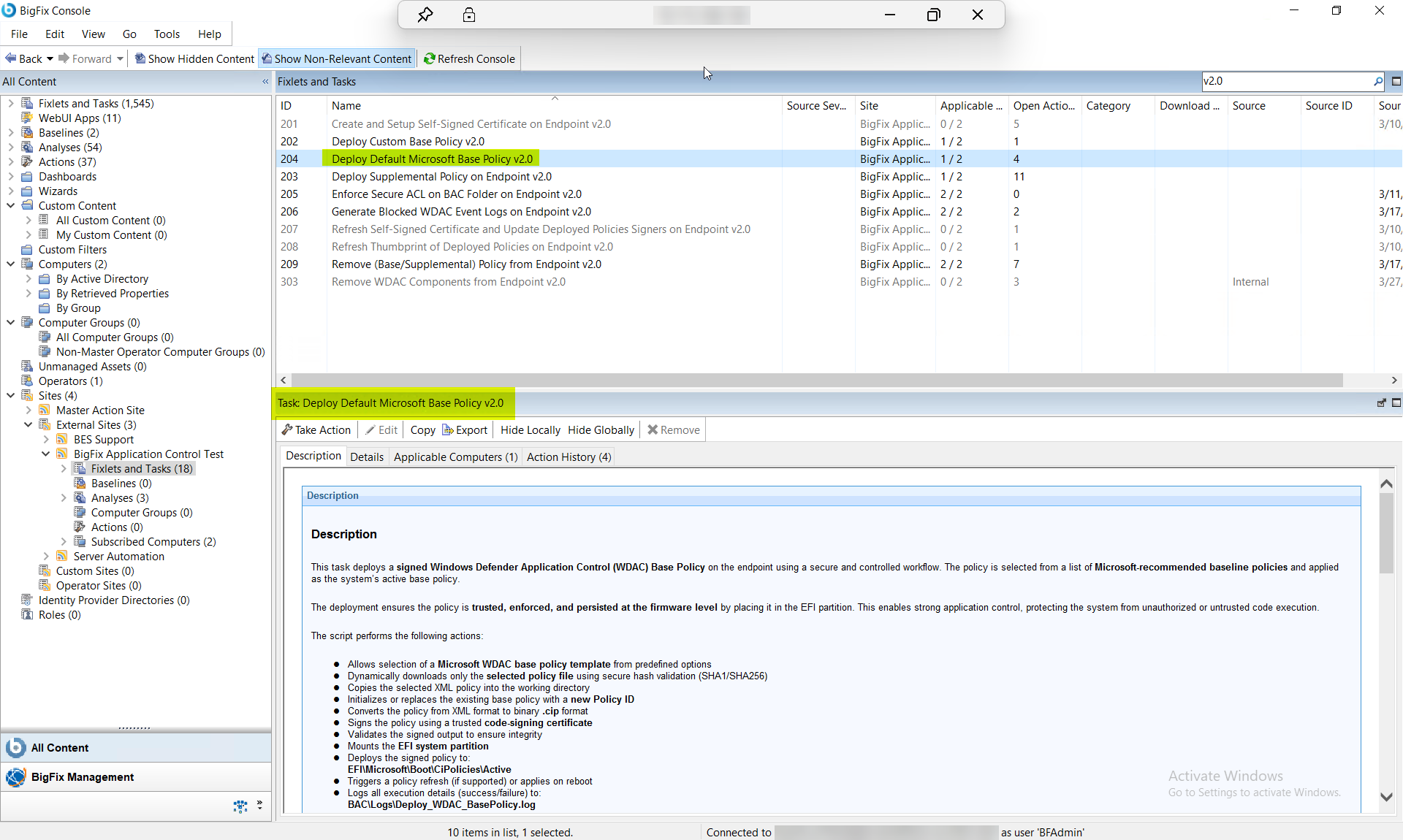

Figure 1. BigFix Console — Deploy Default Microsoft Base Policy v2.0 Task Overview
BigFix Console showing the Deploy Default Microsoft Base Policy v2.0 task in the Fixlets and Tasks pane, displaying the task description including the SHA1/SHA256 hash-validated download, XML-to-binary CIP conversion, code-signing certificate policy signing, EFI partition deployment to EFI\Microsoft\Boot\CiPolicies\Active, and BAC\Logs\Deploy_WDAC_BasePolicy.log execution logging.
