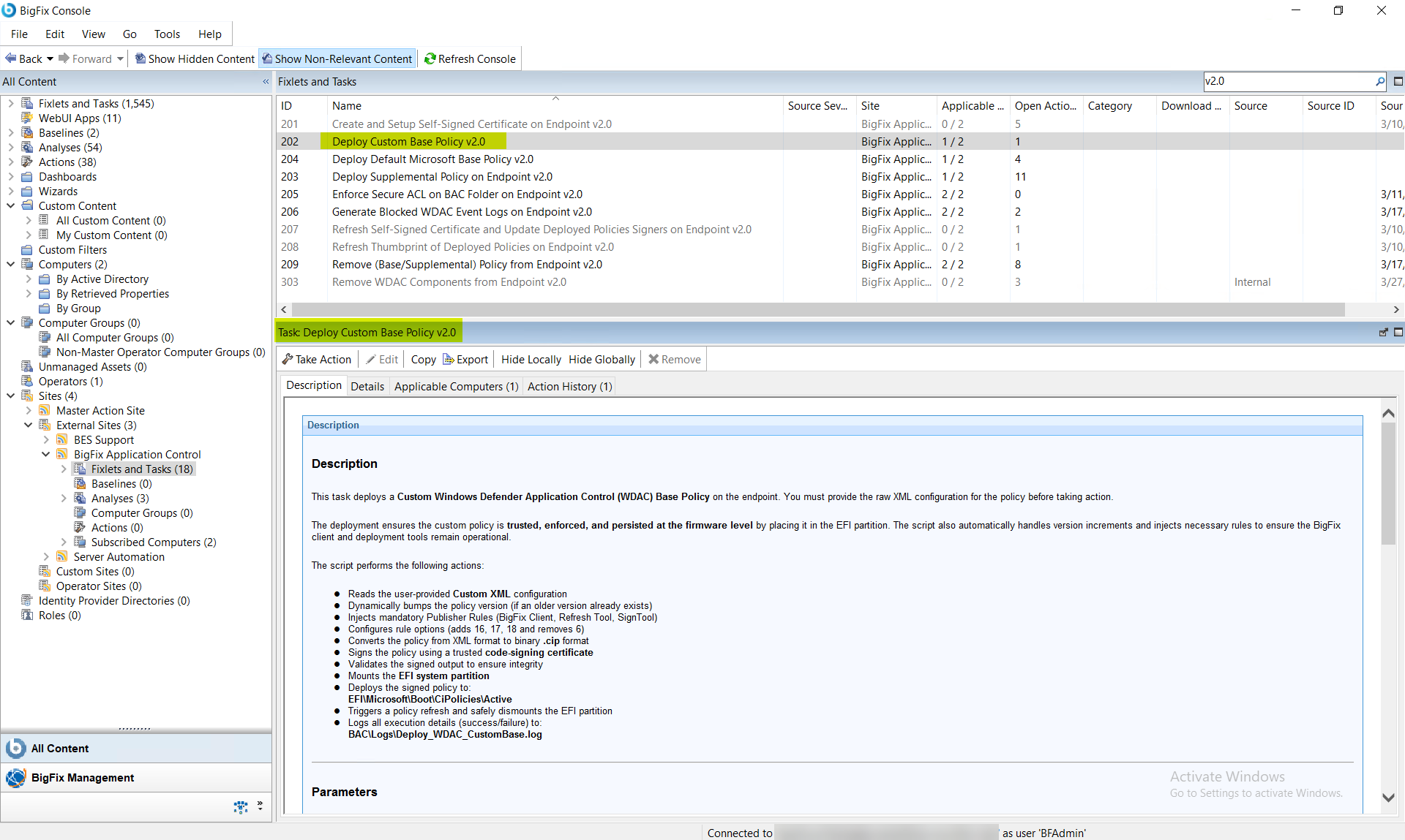

Figure 1. BigFix Console — Deploy Custom Base Policy v2.0 Task Overview
BigFix Console showing the Deploy Custom Base Policy v2.0 task in the Fixlets and Tasks pane, displaying the task description including user-provided custom XML configuration input, automatic policy version increment, mandatory BigFix Client and SignTool publisher rule injection, XML-to-binary CIP conversion, code-signing certificate policy signing, EFI partition deployment to EFI\Microsoft\Boot\CiPolicies\Active, and BAC\Logs\Deploy_WDAC_CustomBase.log execution logging.
  1. In the BigFix Console, navigate to All Content > BigFix Application Control > Fixlets and Tasks.
  2. From the Fixlets and Tasks pane, select Task: Deploy Custom Base Policy v2.0.

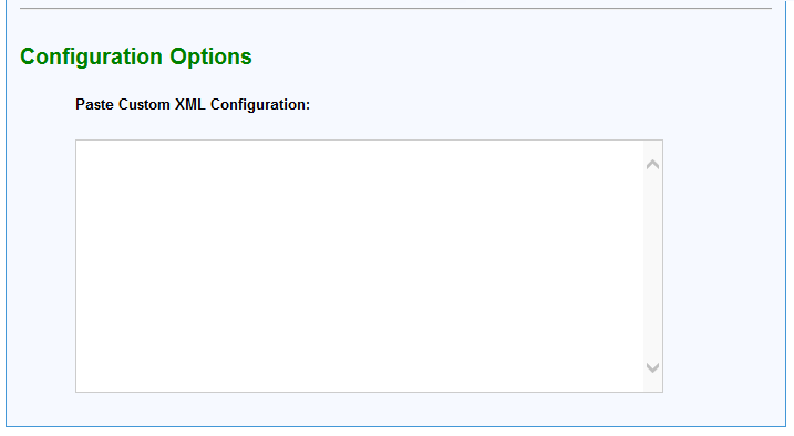

  3. From the Task: Deploy Custom Base Policy v2.0 pane, under Configuration Options, paste the raw XML configuration for your base policy into the provided text area.
    Figure 2. BigFix Console — Deploy Custom Base Policy v2.0: Configuration Options Panel Showing Custom XML Input Text Area
    BigFix Console showing the Configuration Options panel for the Deploy Custom Base Policy v2.0 task, with the custom XML text area where the administrator pastes the raw WDAC base policy XML configuration generated by the WDAC Policy Wizard for deployment to the endpoint.
