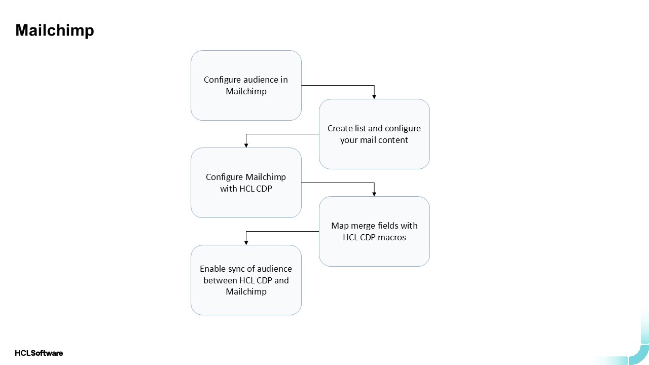

Mailchimp Configuration Flow
Pre-requisites to configure Mailchimp
Make sure that the following things are in place, before configuring the Mailchimp:
  • Create an account in Mailchimp. For more information about Mailchimp's plans, refer pricing plans.
  • A list of audience contacts to import from HCL CDP to Mailchimp. For more information about creating audience, refer Create Audience.

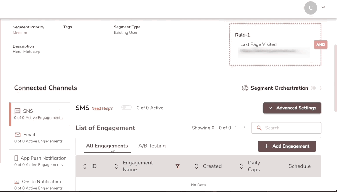

Syncing an inactive segment
If you need to sync an inactive segment from HCL CDP to Mailchimp���for instance, when you want to run email campaigns only through Mailchimp without using other engagement channels. To sync an inactive segment, follow the below steps:
  1. Navigate to Campaign > Segments .
  2. Select a segment from the list, and click Email > Activate displayed beside the notification "Segment is not synced with Mailchimp".
  3. Click Confirm on the prompt displayed to ensure activation.
    Note: You can activate or deactivate the synchronization at the global level after the configuration. The sync will stop, but the old users in the list and tags will remain at Mailchimp.
